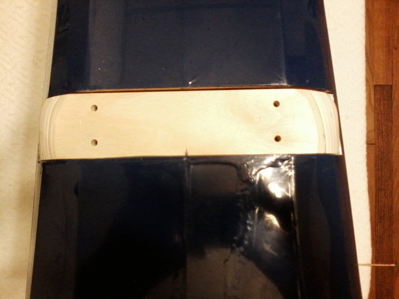

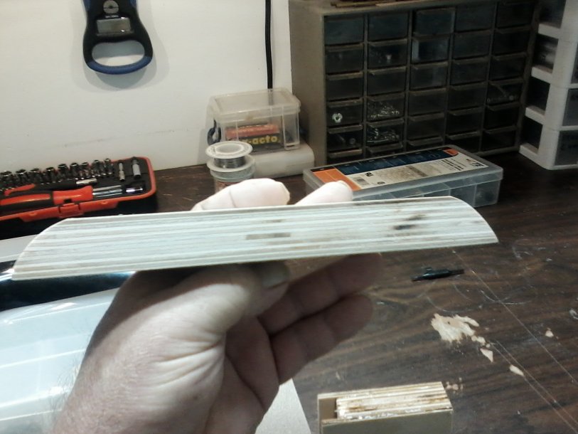

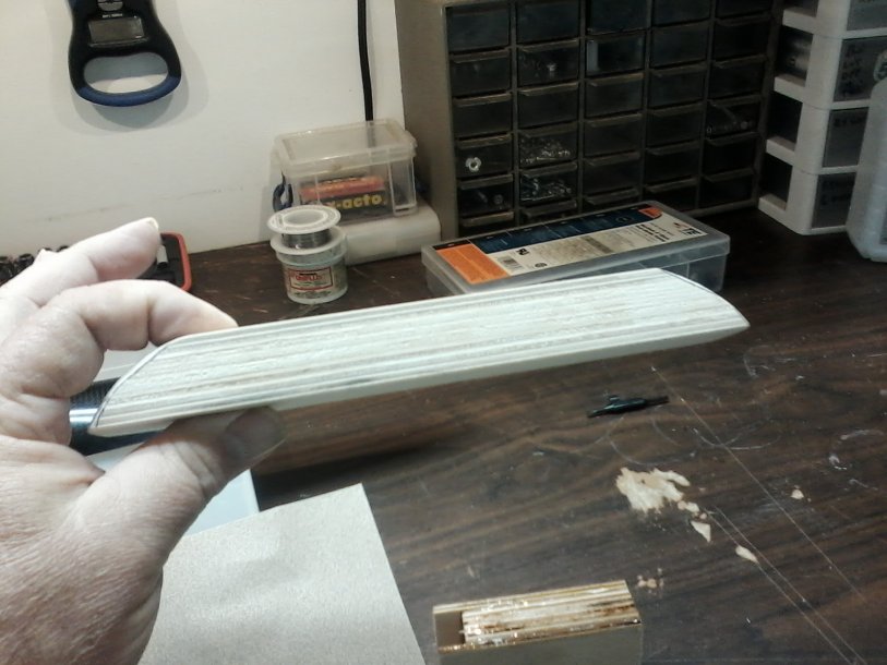

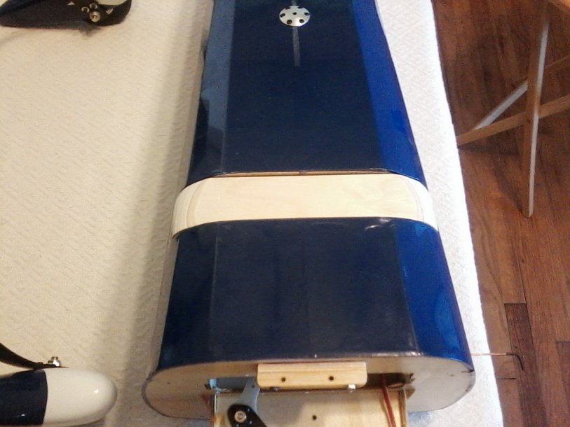

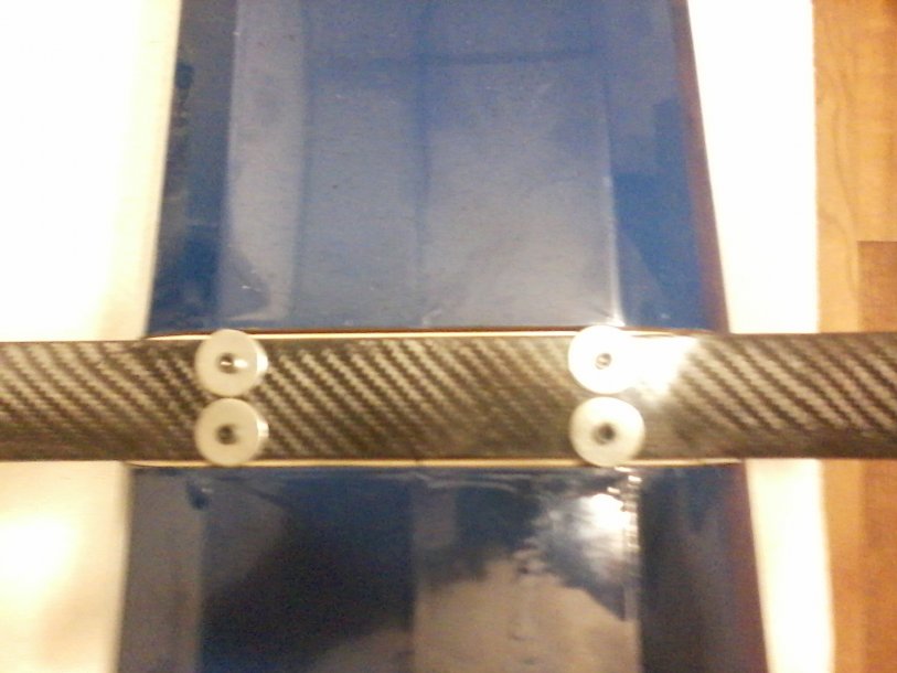

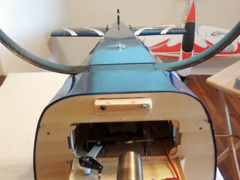

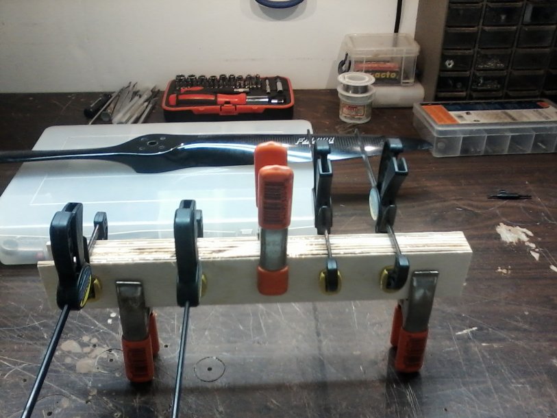

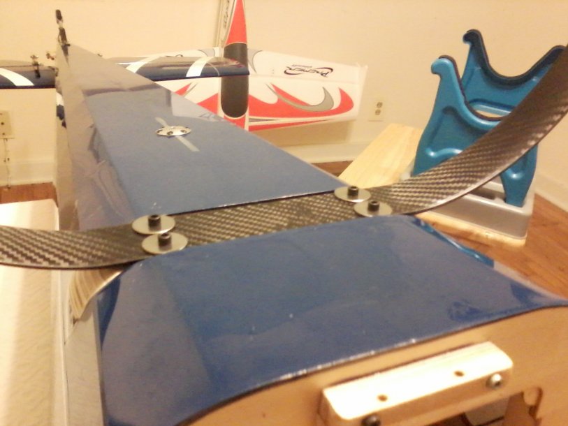

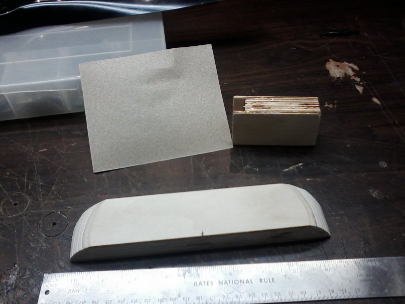

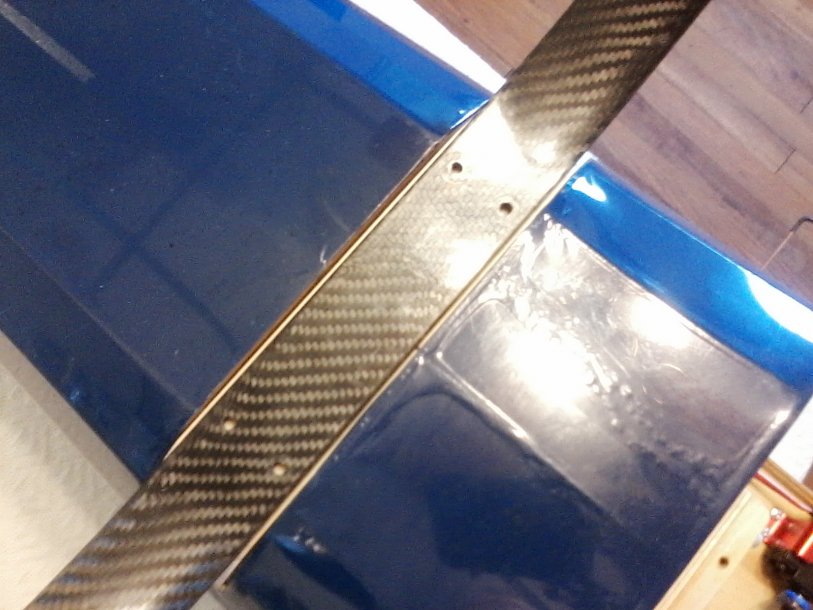

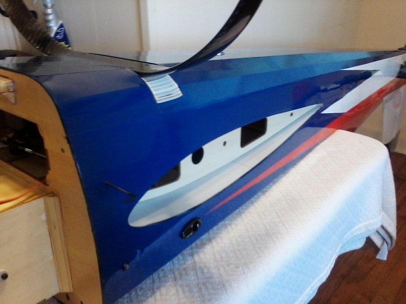

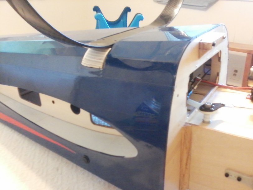

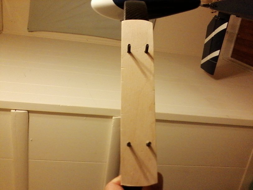

Not much accomplished yet (as usual lol ) .The new "raised" landing gear block is laminated 3/4" hard ply sandwiched between 1/8" light ply. Will cut to length and contour the ends to fit the fuse. The thickness of the materials puts the bottom of the CF LG flush with the fuse.
