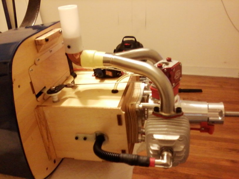

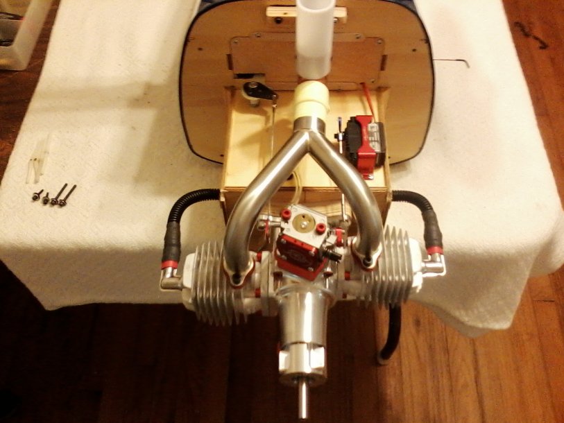

Windy and very cool temps today so no maiden yet. Hope to get out before the Holiday. In the mean time I ran the engine a couple more times and got a nice 1400 rpm idle. I can get it lower to 1100 or so but it shakes a bit much since the wings are not on the fuse. Will get a WOT and thrust measurement when I go to maiden. It looks as if this 2n1 custom muffler is a viable option for a twin in a plane designed around a single cylinder engine.

Just some info about the muffler if any one else might want to try this.....
DA 2 in to 1 short drop header, 1" copper street 90 el, 25mm Teflon coupler, 4-40 button hex caps 3/16"long.
Heavy duty yellow Teflon tape to wrap the header to copper joint. I also used a wrap of cellophane tape to keep the Teflon from unraveling. The header outlet was cut back 1.25 inches for clearance reasons.
Some benefits......
1) Allows the use of a twin cylinder engine, on a single cylinder design, with out the use of in cowls.
2) Allows much better access to the carburetor needles and arms.
3) Light weight.
4) Sound levels at or less than "in cowls" (IMO sounds like a single cylinder 60cc motor on stock muffler).
