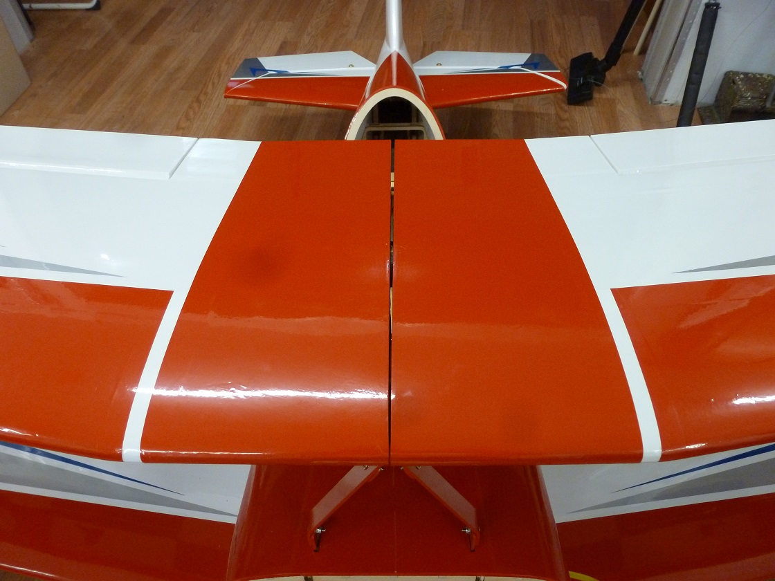

And now that I have it on the floor for better access I notice the top wing does not close up. This gap will allow movement in flight which would probably damage the wing and or tube. So I will have to make a wedge to fill this gap. Not feeling the warm and fuzzies with this PAU today.
That is more gap than I would like, that would bother me. I would have to fix because I would not stop looking at it.

I made a mini wedge for the wing, just enough to bolt it up, will work on the full wedge over the next day or so. But for now I need to get the throws set and take it outside for a run, then look for a somewhat decent day to get the maiden in.
