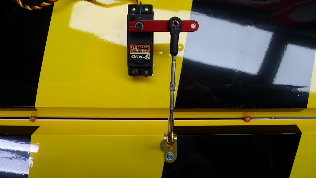

Got a question on the edge 36. I am mounting my aileron servos and planned on using the 1.5" spot on the 2 inch arms I had in stock. Are the turnbuckles supposed to be perfectly parallel to the servo like in the online manual? If they are they would only line up at the 1' position.

I use 1-1/2"
There is more stress on the control when at full deflection, and the pushrod is then straighter.
