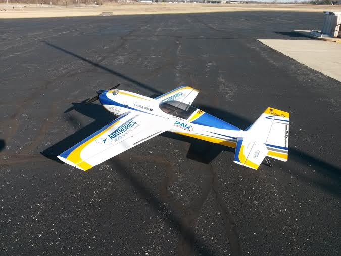

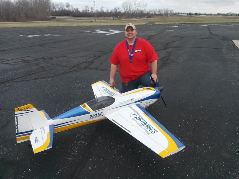

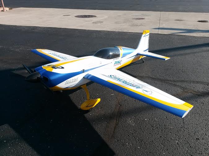

Finally got to burn some gas today!!! Flew the Extra, only cause I haven't got the Ultimate put back together from it's spring annual yet. Anyway, I finally found what was causing it to always bank to the right when doing hard pulls.......... The hole for the anti rotation pin in the right wing was to big, and the wing could move up to 3 degrees in incidence change.
So set the incidence to match the left wing, put in a 1/4" piece of lite ply with the proper size hole and WHALA!! Now I can do water falls that wrap around like it's on a pole.
SOOOOO MUCH FUN! lol

It just seems all wrong for someone named Bipeguy to fly a monoplane!!
Seriously, glad you found the problem with the wing incidence.
That is one sharp looking Extra!!

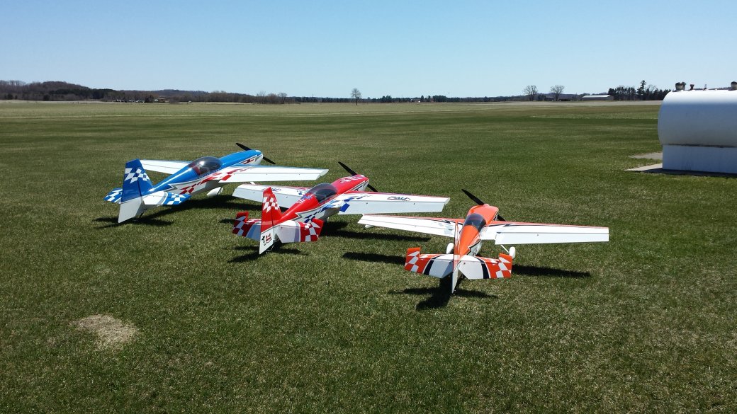

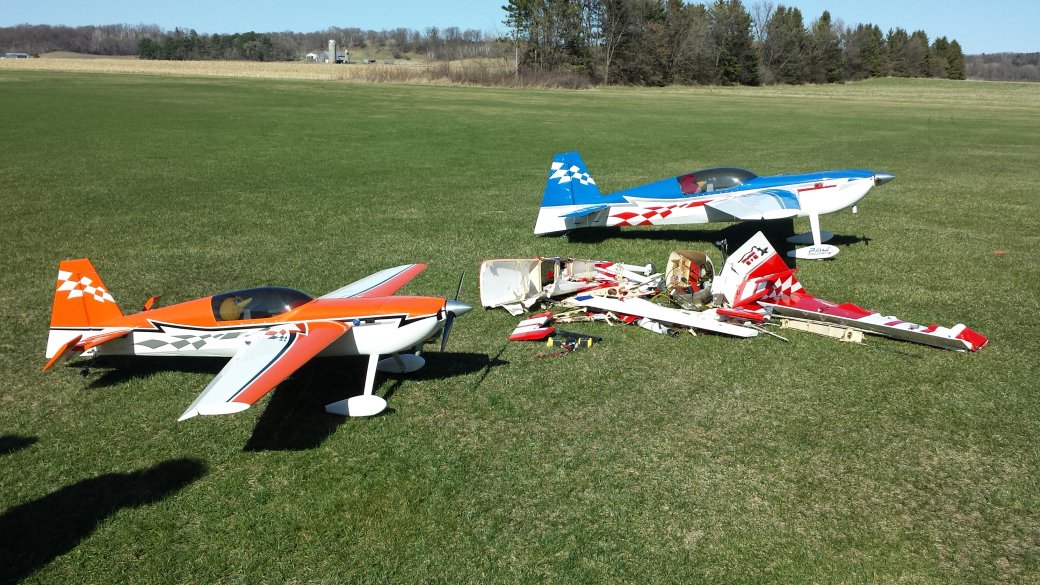

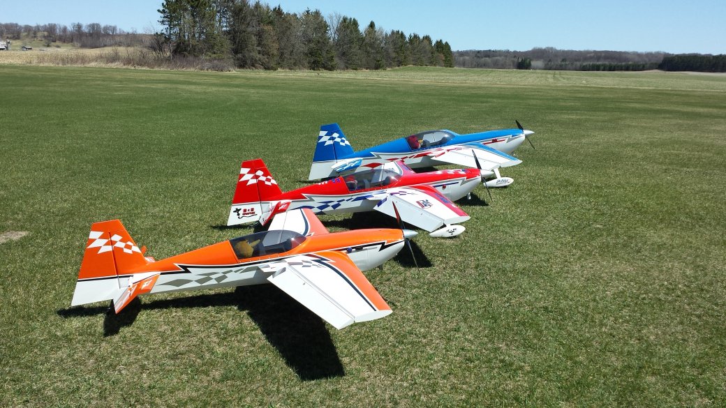

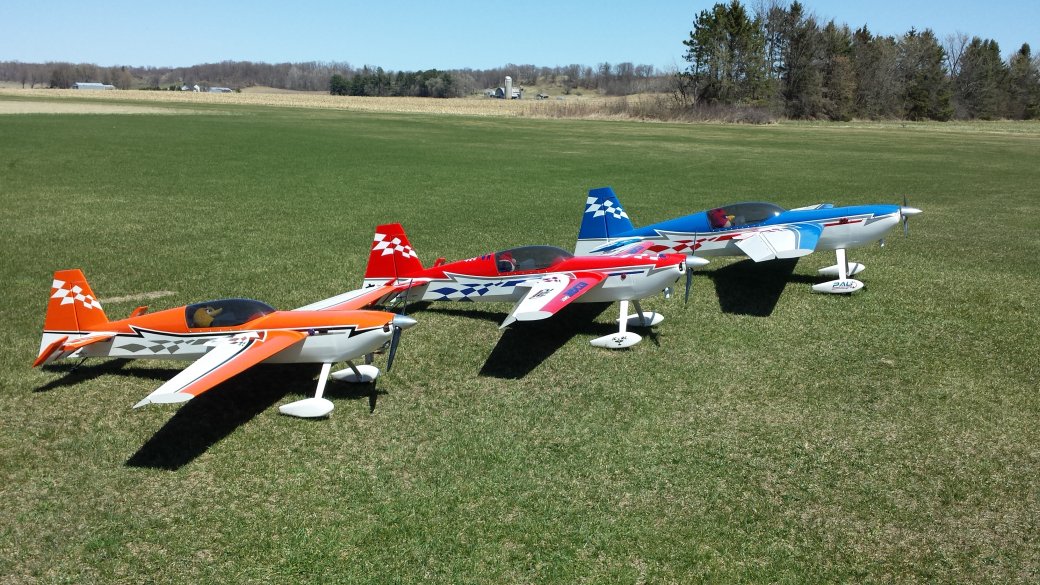

New to GSN!
Here's my 3 Edge 540T's.
Don't wrestle with the pine trees in the background! They will win everytime! Thanks to Herve from PAU I will have a replacement waiting for me at the Nall!
