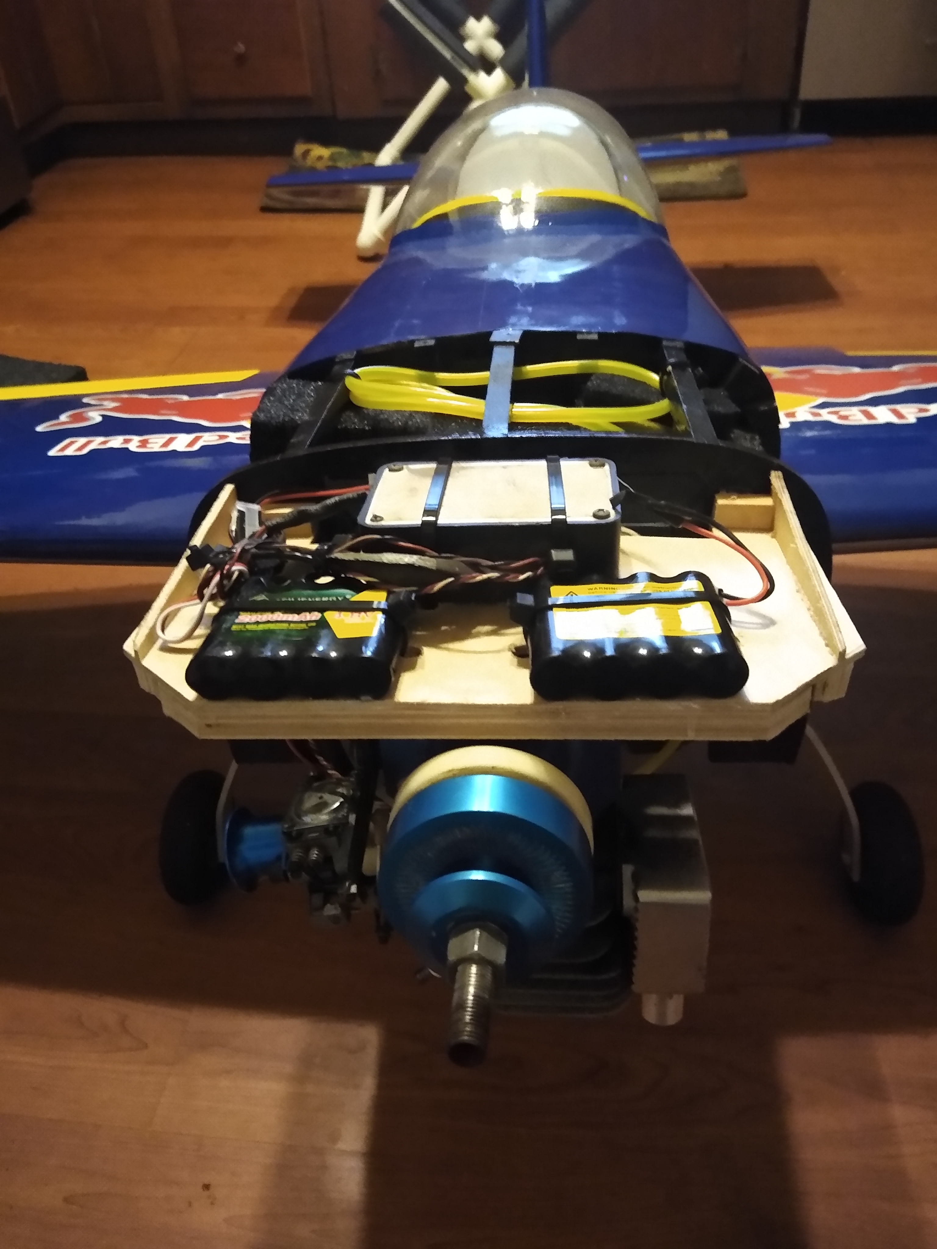

Up date I have removed all lead built a tray to fit in the cowling and moved ignition and ignition batteries forward . I also moved receiver battery behind the firewall and the plane balances perfect with no lead woohoo I don't think moving the receiver battery forward will create interference problems I hope ... Will be doing some extensive range testing soon. All up weight now is 19 lbs
Looked up some of my old records the same plane that you are working on at 19 lbs is heavy. I had the same plane with identical motor came in at 16 lbs 3 oz. loved the plane and flew great. Tried to find an old picture of mine but could not find it.

Was your the Ohio rc kit or the proline revision proline lightened the build mine is the old Ohio rc ?
So I am very curious on this build I have the plans and am concidering another build lighter I am wanting to know how you guys build this plane lighter mine is 19 lbs but Snoopy says his was 16lbs and I seen a post in rc universe saying 15 lbs mine is built as plans show are you guys using less sheeting substituting materials?
