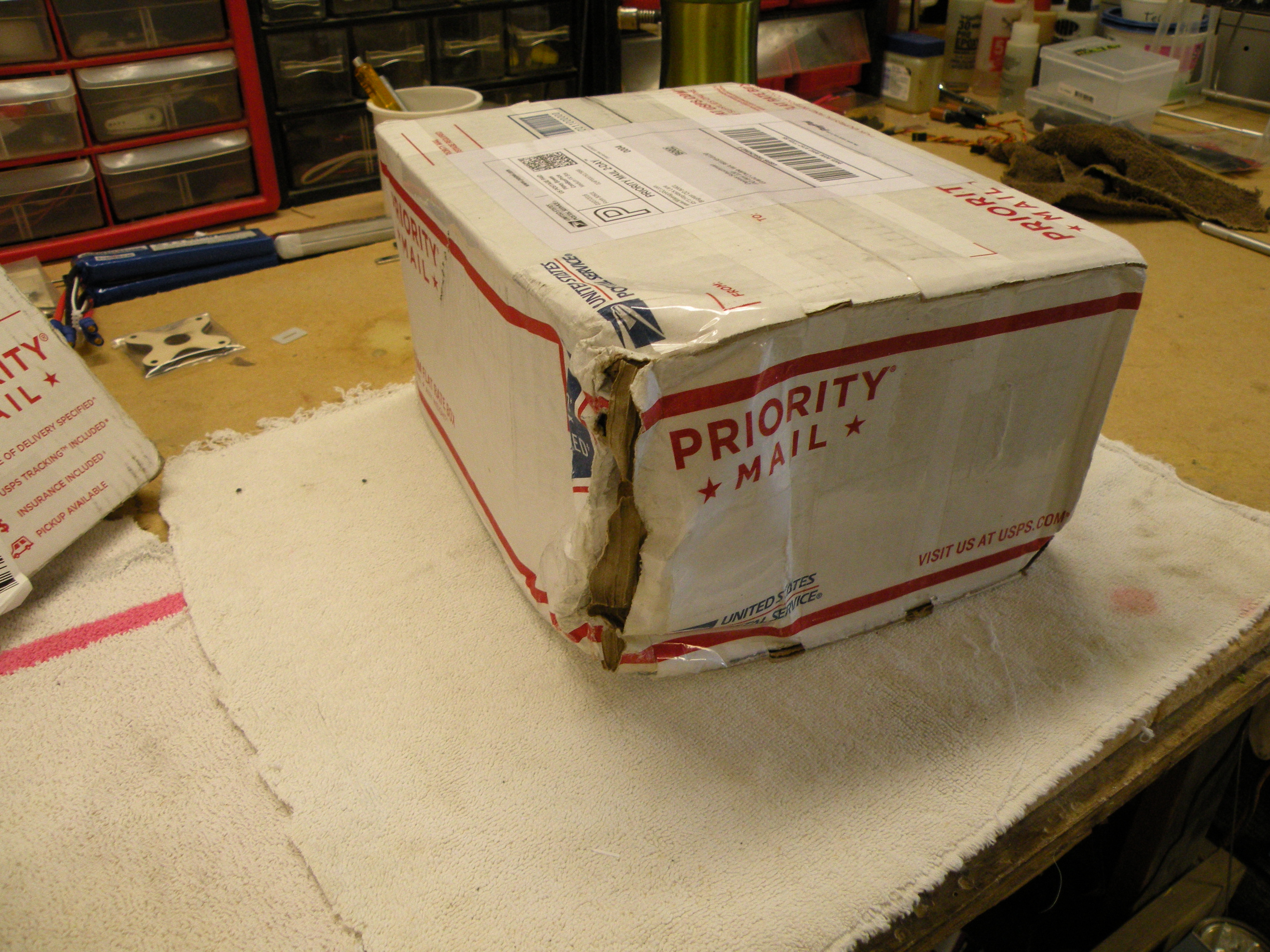

    So I ordered pretty much everything I needed from Mike at Mile High RC, one thing to note here is from the first email to him about what I wanted to do, he was extremely helpful. I had several conversations, including on the phone, with him and when I placed the order, they had the shipment in the mail the next day. It was all very well packed and arrived without any problems, even though the postal service did the best they could to damage the parts. The outer boxes were pretty damaged by the time they got here but the contents were in perfect shape!! Here are a couple of pictures of the way I got the boxes

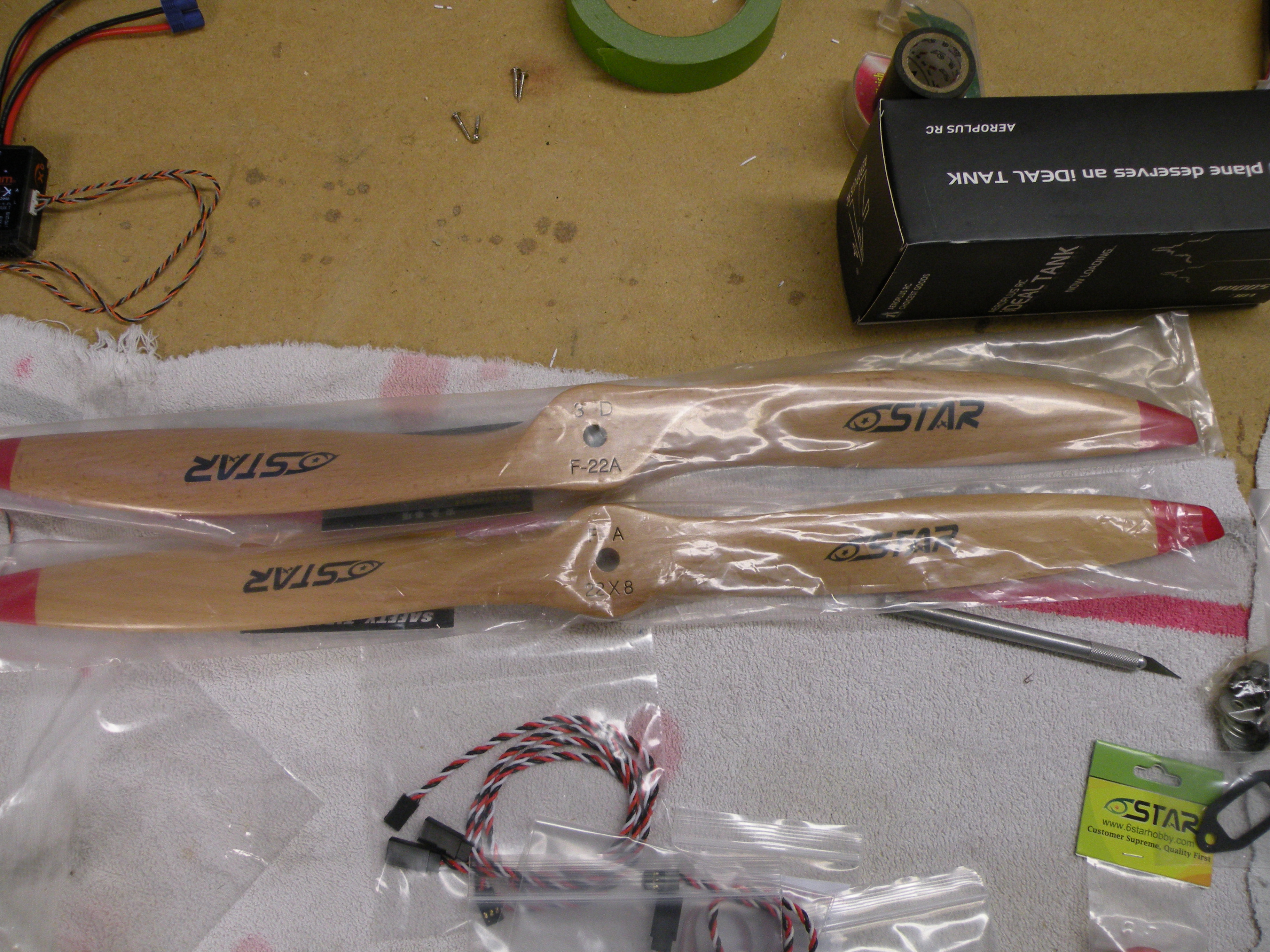

    So I was a little nervous about my parts before I opened the boxes, no need to worry!! Here is a few pictures of what I got and as you can see there is no damage at all to the parts!!
    DSCN3249.JPG DSCN3250.JPG DSCN3251.JPG DSCN3252.JPG DSCN3253.JPG DSCN3254.JPG DSCN3255.JPG DSCN3256.JPG DSCN3257.JPG DSCN3258.JPG

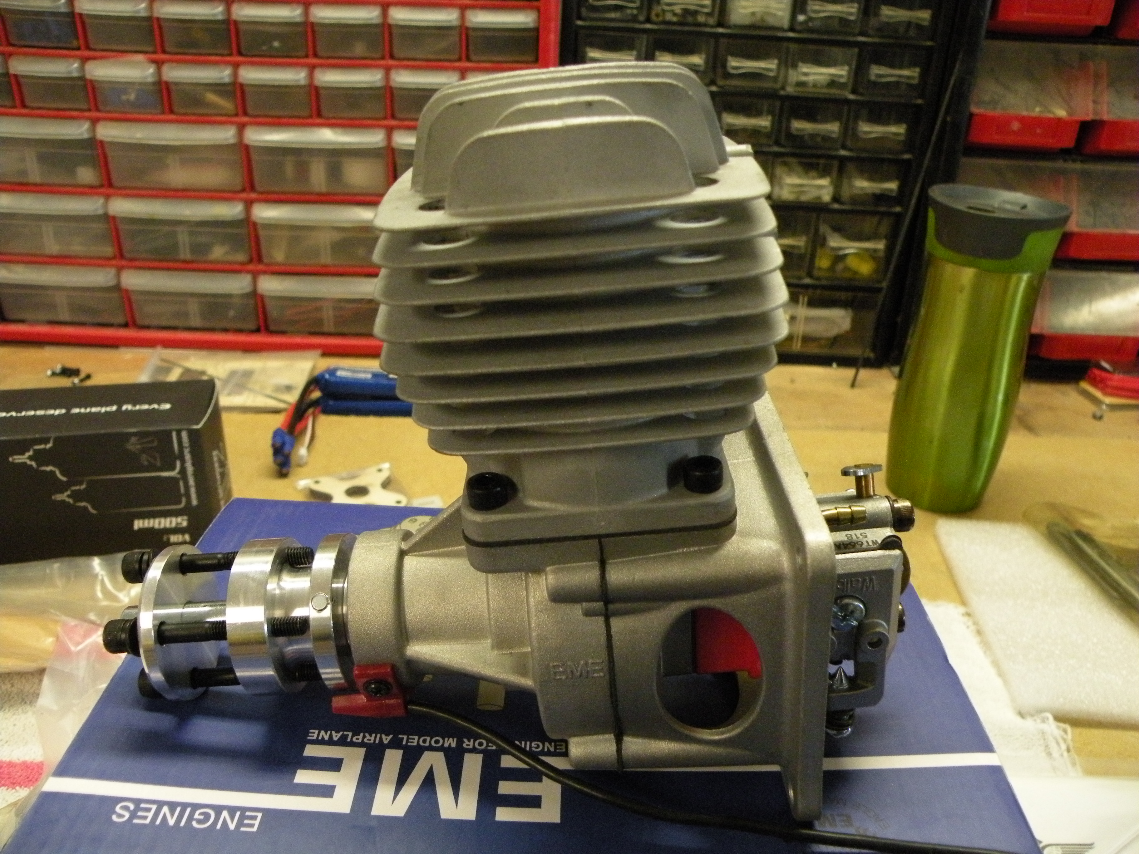

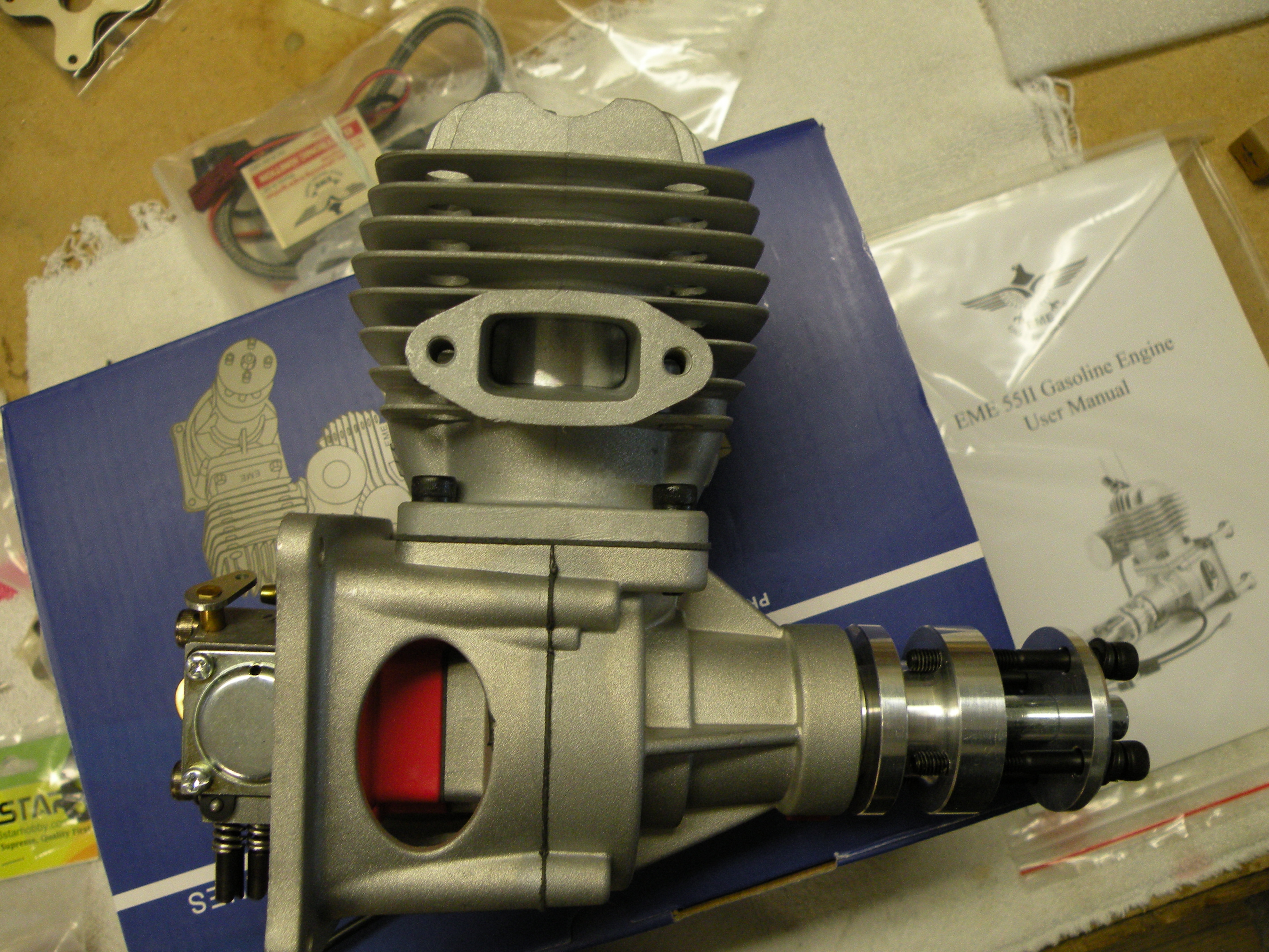

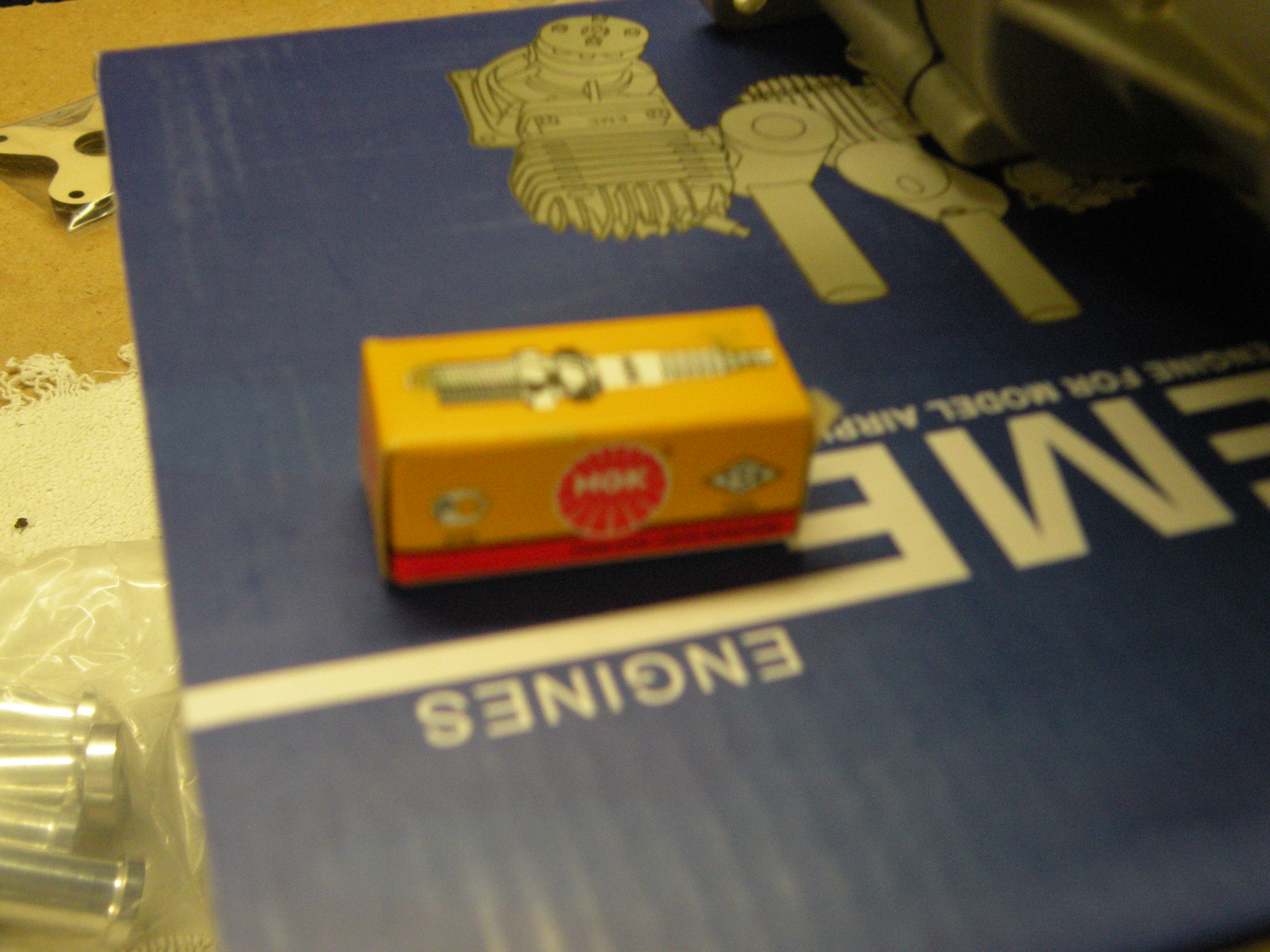

  2. One of the Nice things that I really like about ordering EME Engines from Mile High RC is the fact that they include a NGK CM-6 spark plug along with the engine.
    That is a very nice touch because they know most people will purchase a CM-6 to put on the engine instead of the original spark plug that comes with the engine. Another nice touch that EME does is that they include a drill guide decal for getting the engine mount holes exactly right.

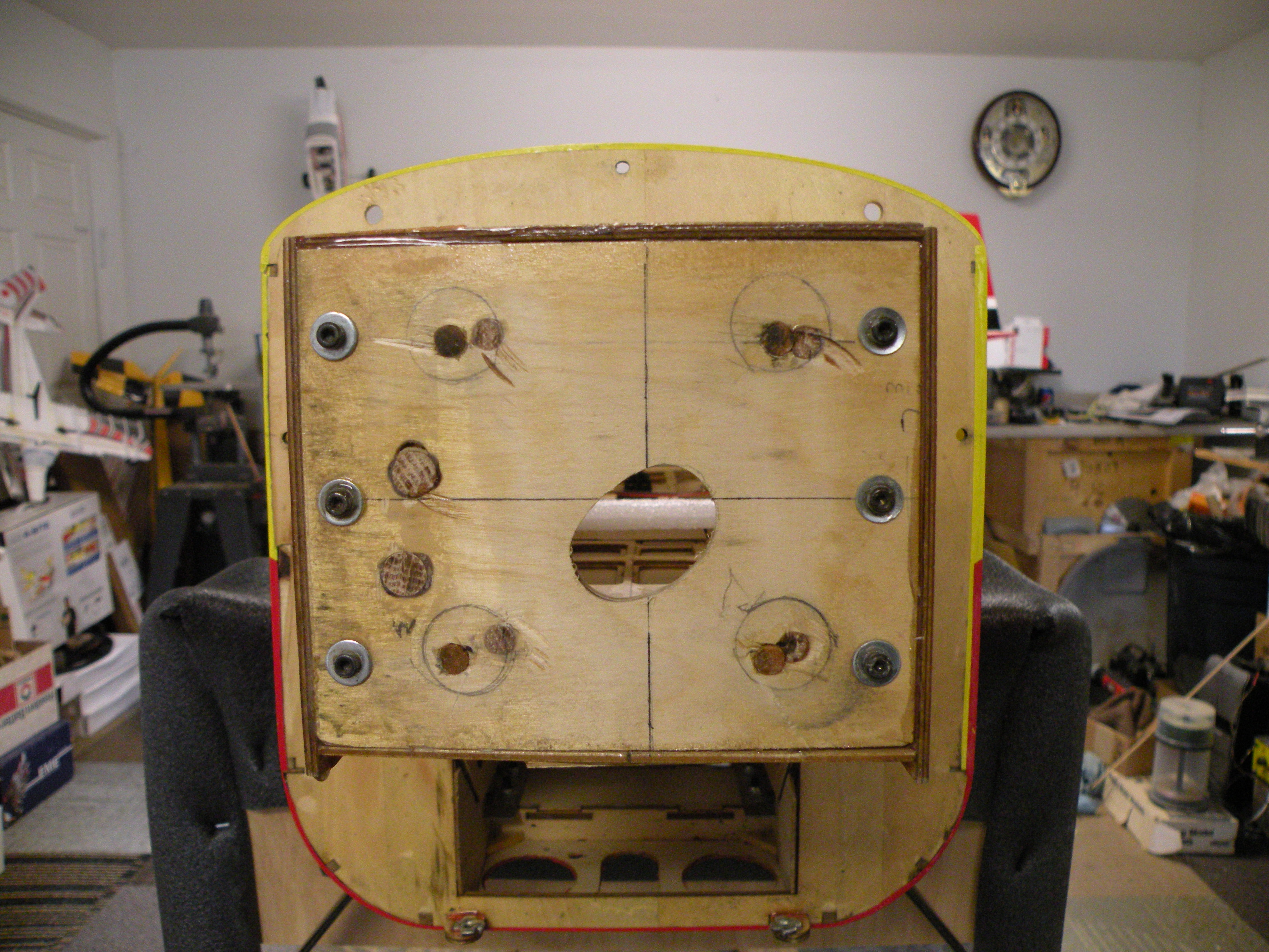

    So what I do is I take a very fine felt pen and extend the center line markings on the decal all the way to the edges so I can line it up properly on the firewall.
    At that point on my used Slick I had to plug the holes in the firewall. Easy enough to do, I drilled out the holes to match the size of dowel I have here in the shop. I drilled them, plugged the holes with the dowel cut to the same thickness of the firewall and tapped them in place and used CA to make them permanent

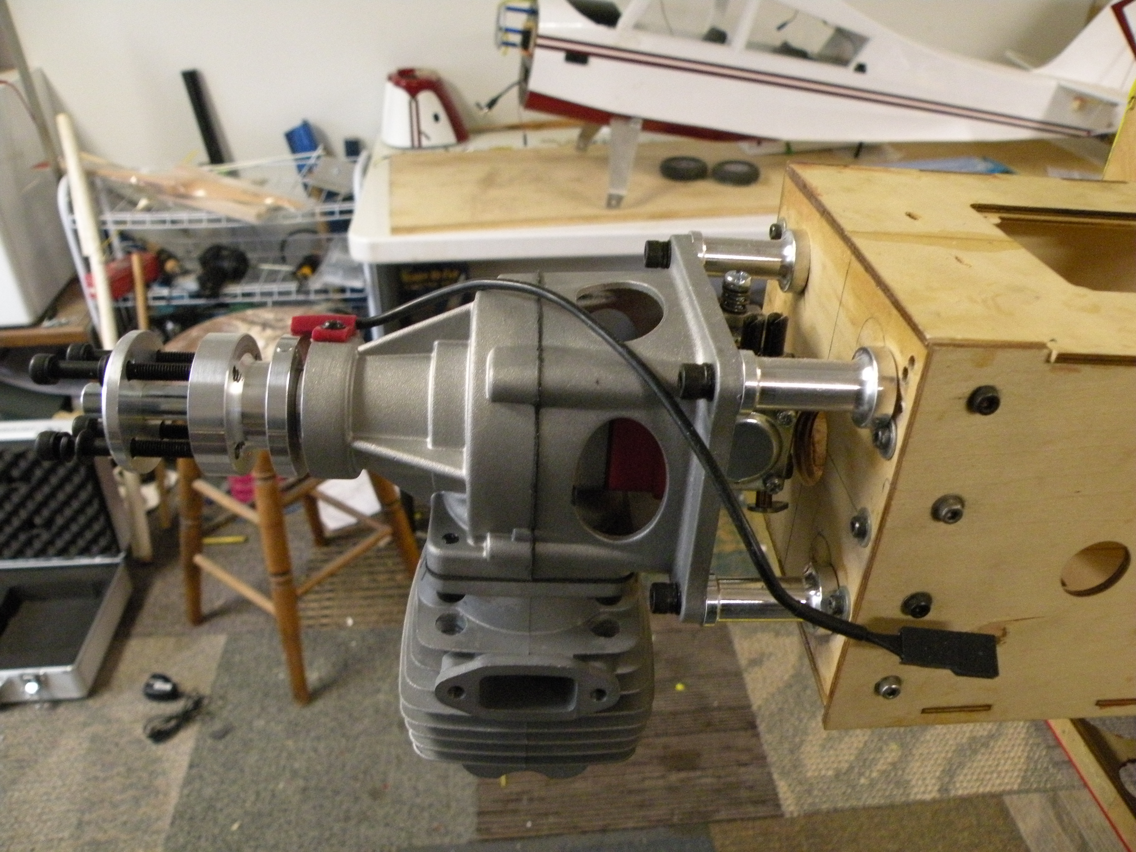

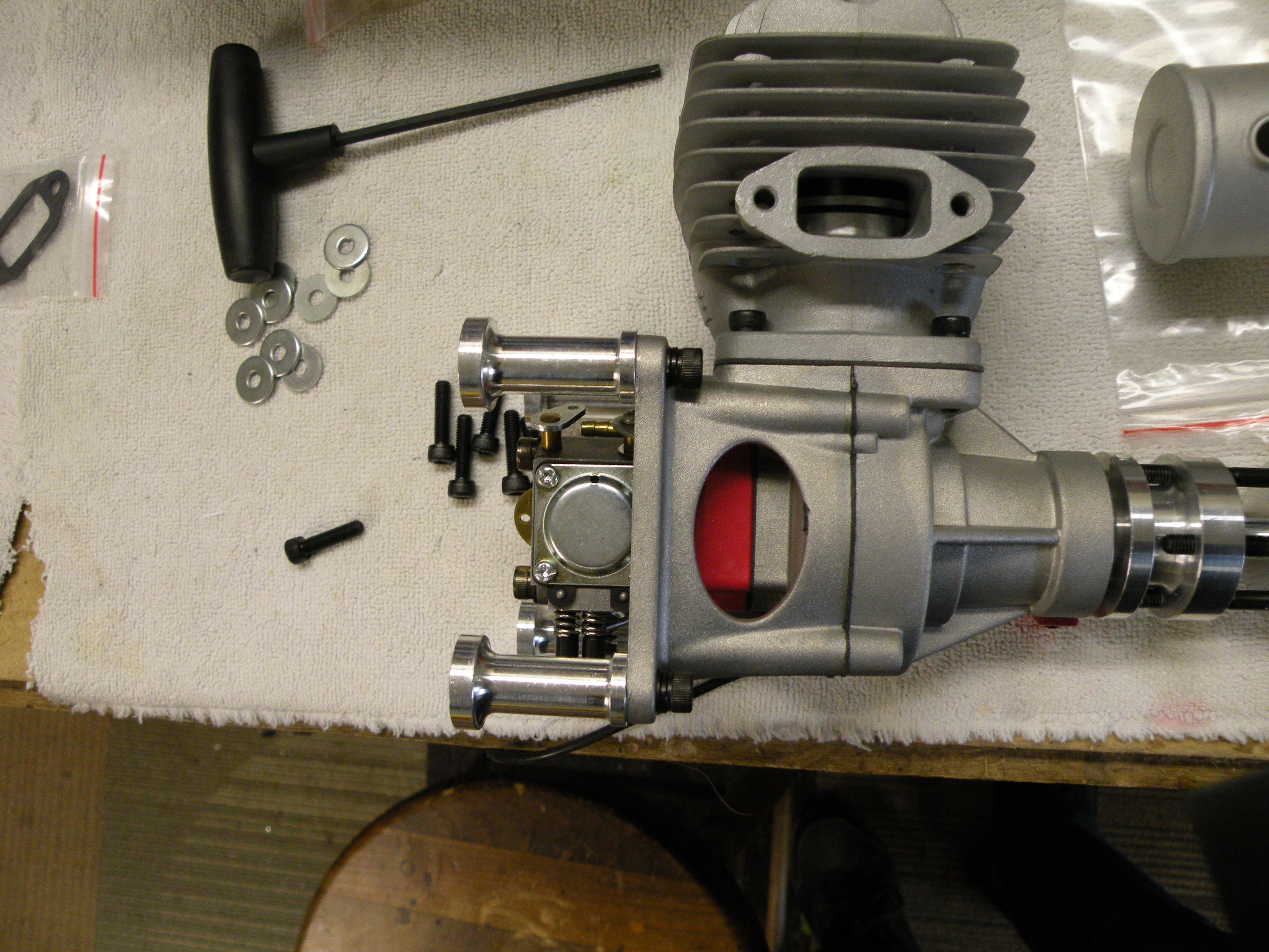

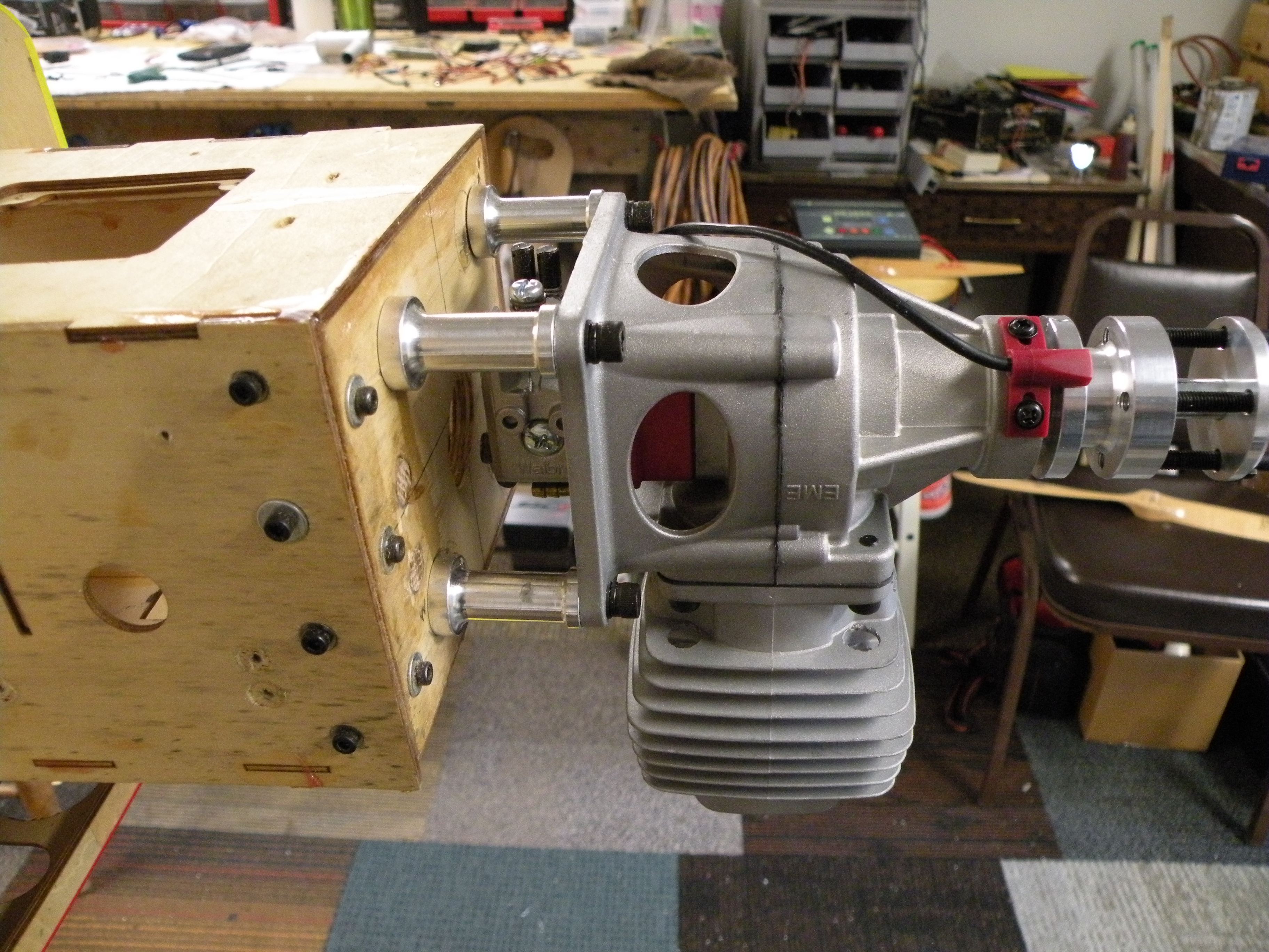

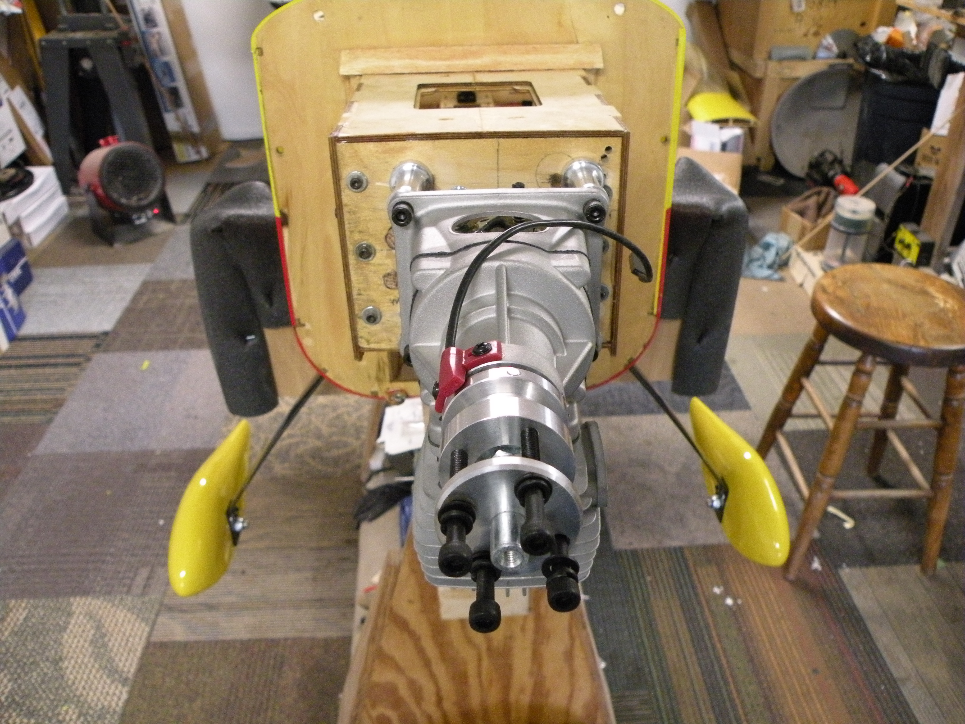

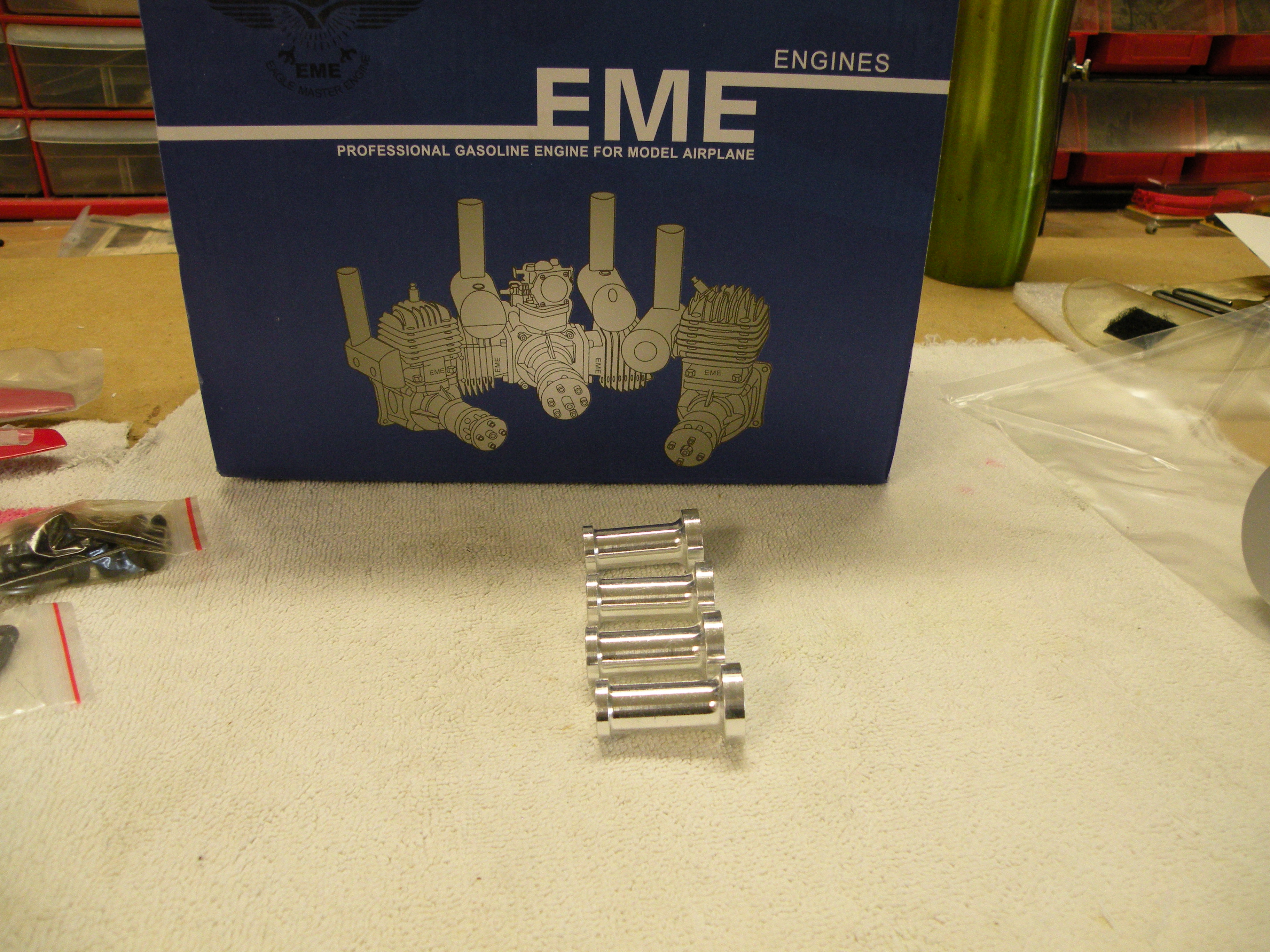

    From there I put the decal on the firewall and drilled the holes. I then got the engine ready to go on the airplane. I always test fit everything first, Here you can see that I put the standoff's on the engine. Another nice thing about this EME engine is the shorter standoff's. Less chance of flexing while the engine is running.
    I then test fit the engine to the firewall
    Once satisfied with the engine mounting and spacing for the cowl, I take it all apart again and then use red locktight on all the mounting bolts. On this engine I chose to use a servo for the choke along with a throttle servo.

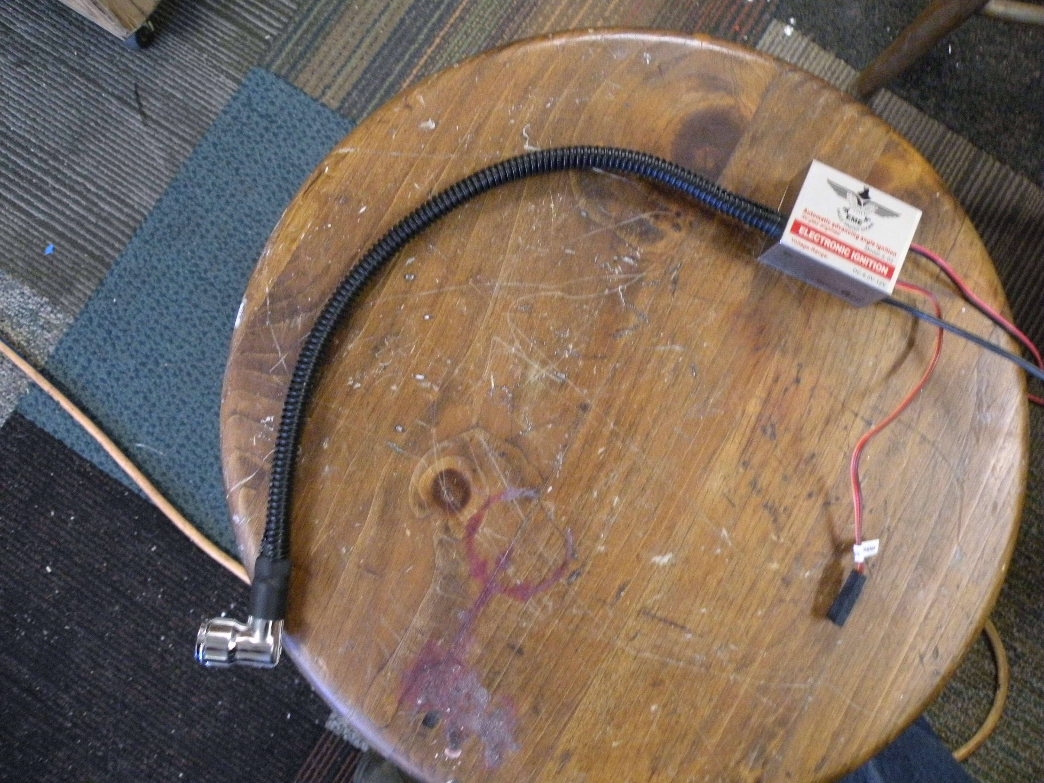

    After I was happy with the engine mounting and got the locktight on I prepared the ignition ready to mount. I like to use plastic wire loom on the spark plug wire to keep it from chaffing and ruining the plug wire and possibly the ignition itself due to high resistance.

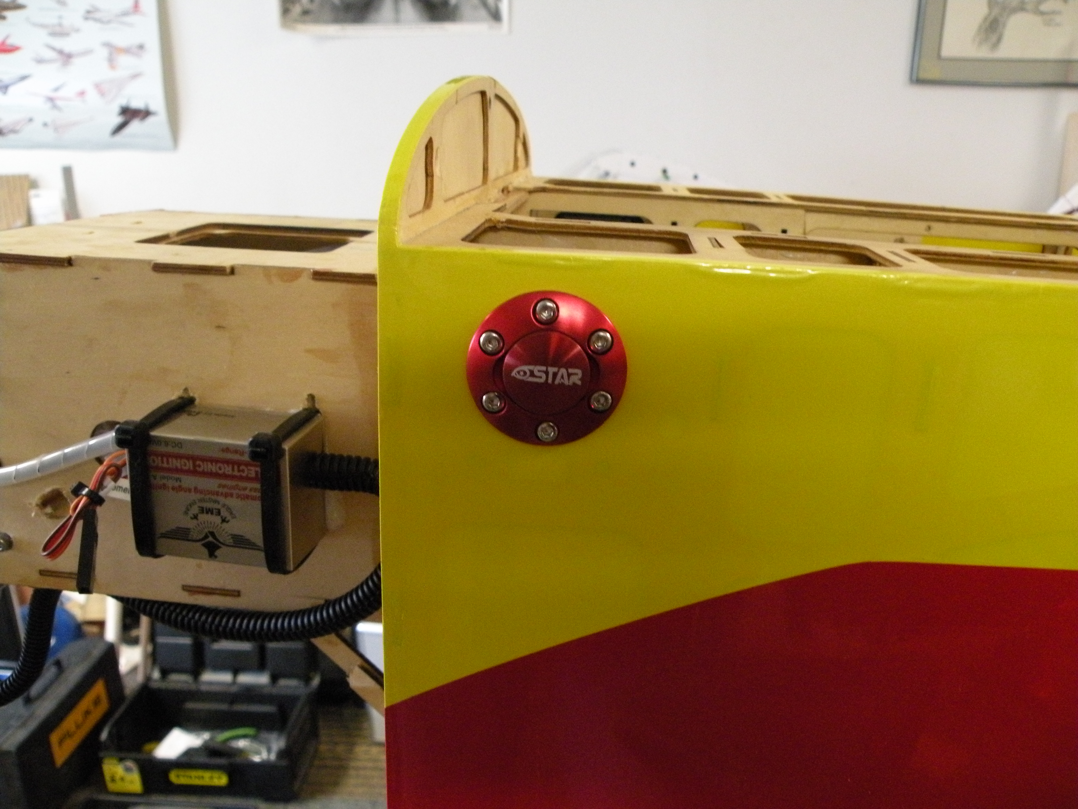

    Once that is done I mounted the ignition to the side of the motor box and fastened the plug wire to the bottom of the box with a large wire tie and an ear cut long for a mounting screw. I wanted to mention that this ignition is rated from 4.8 volts all the way to 12 volts. No more need for a regulator on this ignition if you were running a single battery source for receiver and ignition with an Optic kill switch with a BEC.

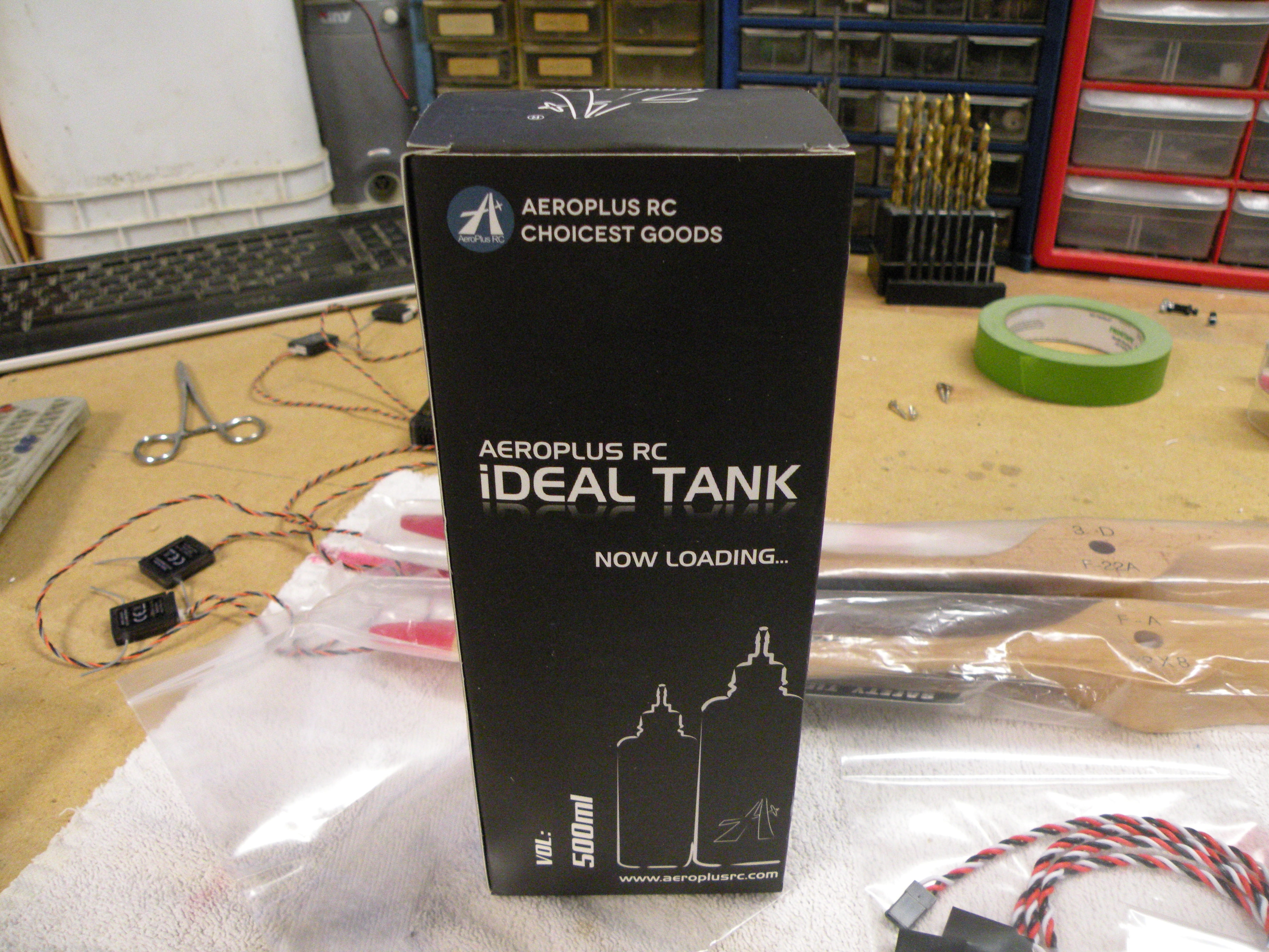

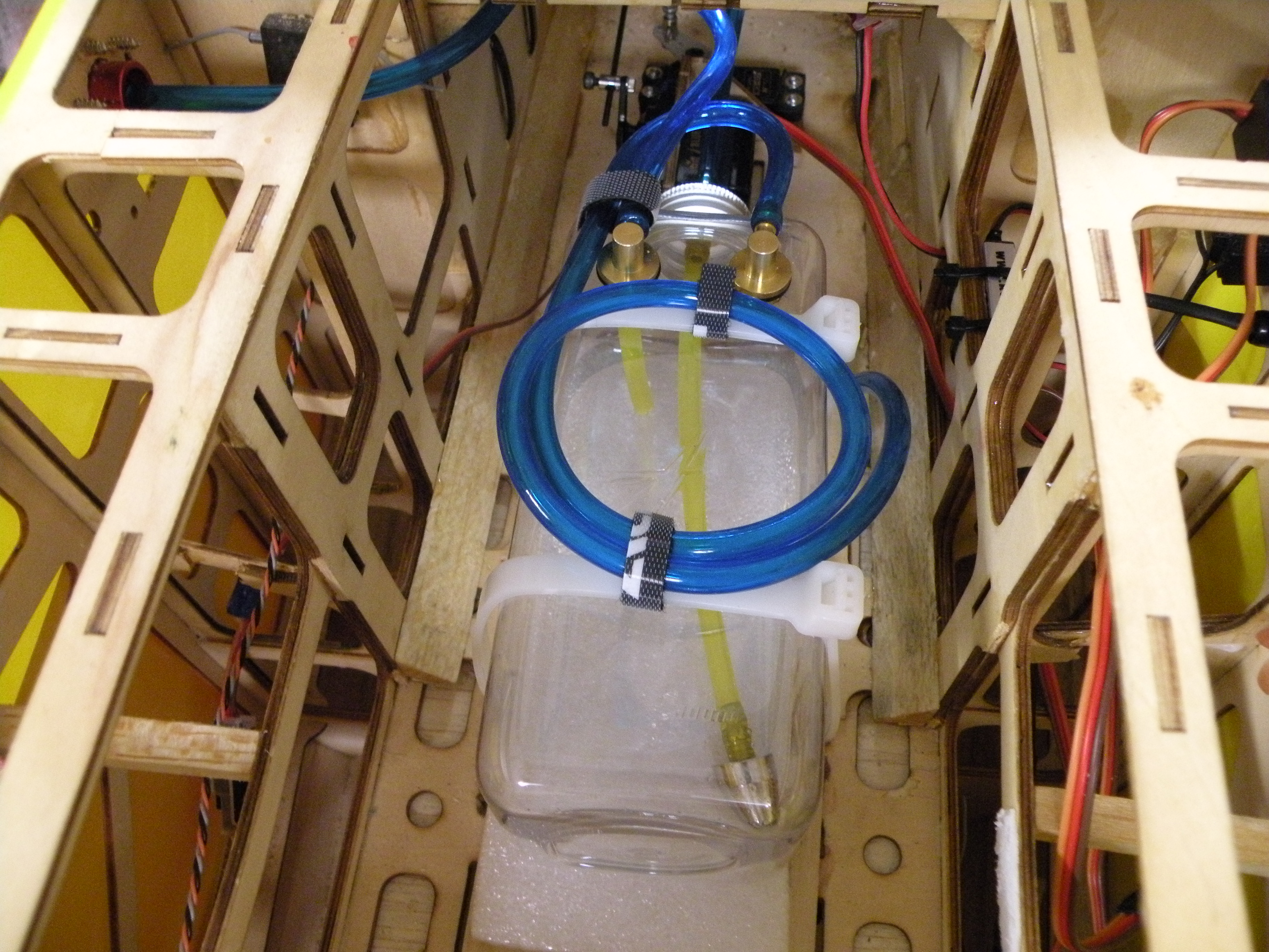

    I then mounted the Aeroplus 16 ounce fuel tank in the airplane. This is the first time I have used this fuel tank and I dont think it will be my last. It has a metal cap on the front and has all brass fittings with very nice barbs to hold fuel line.

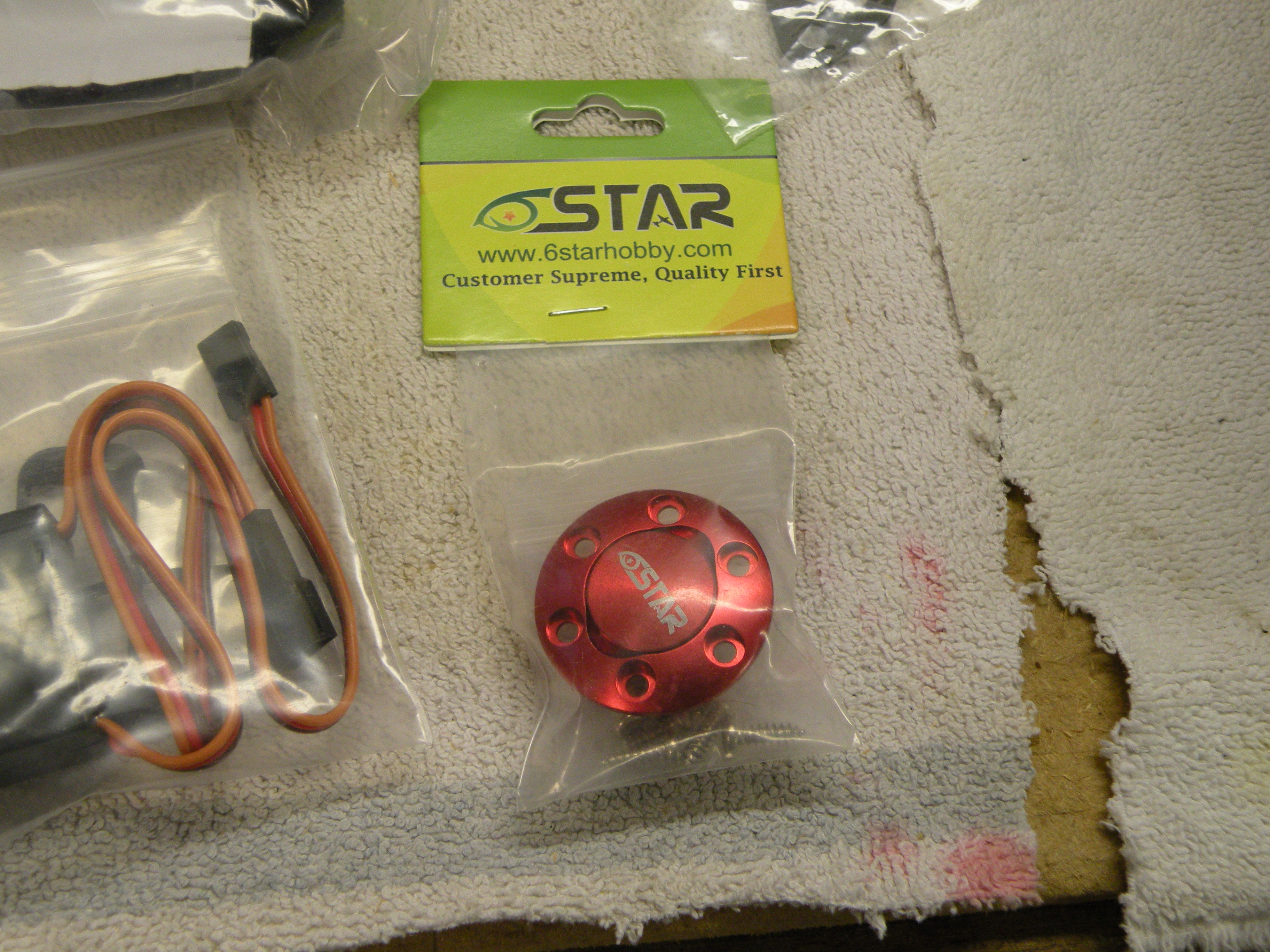

    I then mounted the Star fuel dot, red one of course! lol

    I haven't seen that fuel tank before? Have you used that one before? I'm curious
  7. It is an Aeroplus fuel tank. It is 16 ounces or 500ml as you would order it. This is the first time I have used them. I really like it, it has a metal cap where the fitting is for the carb and all the fittings are brass with really nice barbs. I do think I will be using these in the future.
