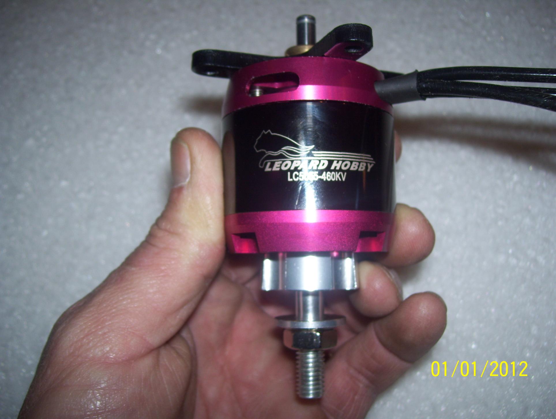

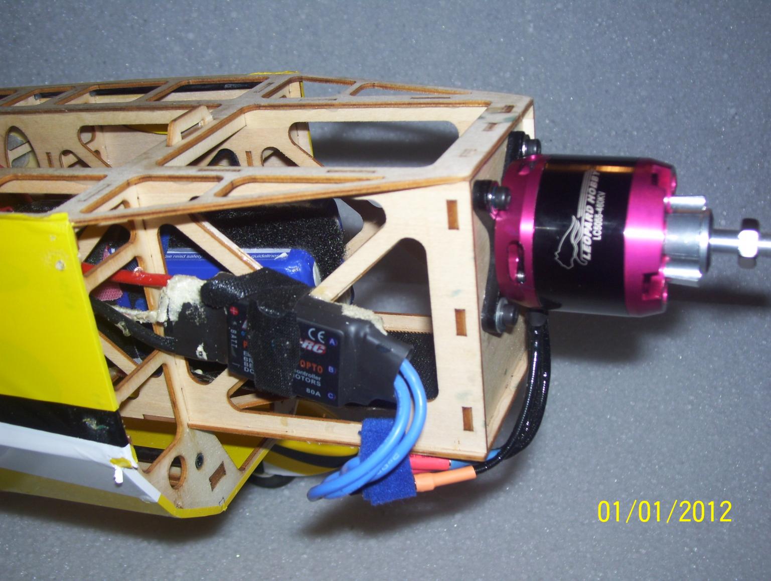

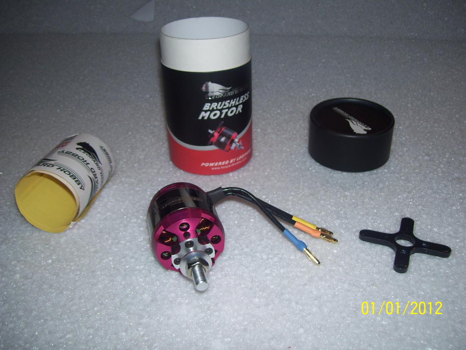

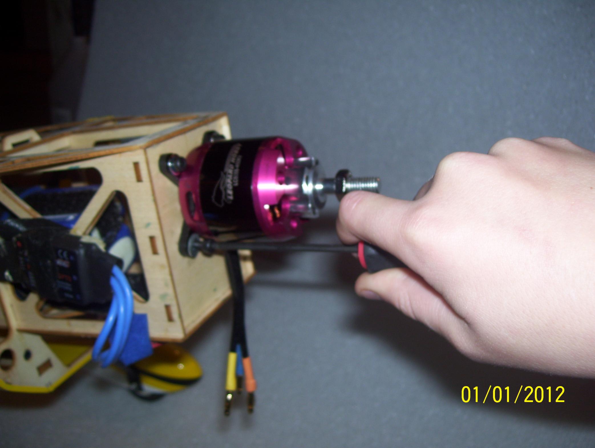

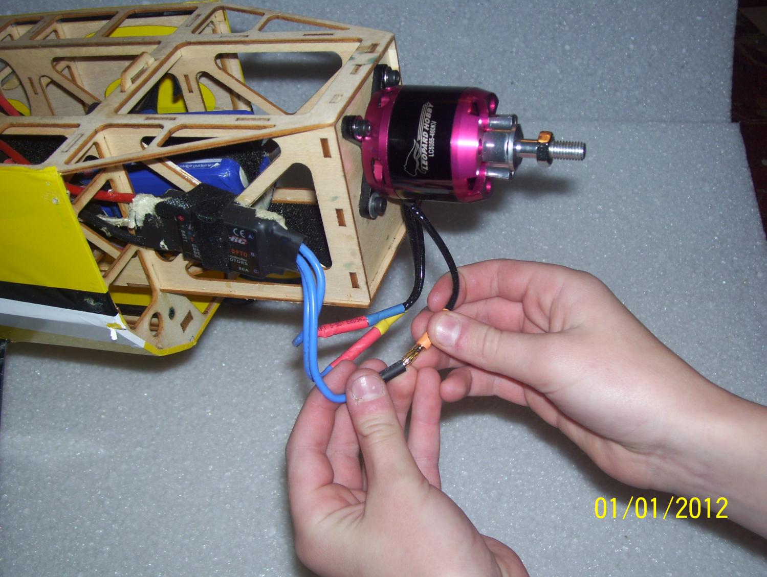

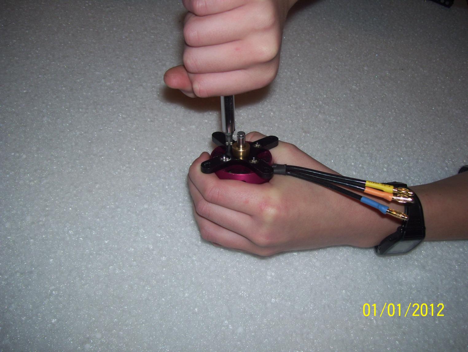

I just received my new Leopard 5055-460kV Motor from Garret at Altitude Hobbies to replace my old washing machine motor in my 3DHS 58" Edge 540. All I can say is NIIIIICE! It came in a neat little cylinder type package, with a heavy duty "X" Mount, pre-installed bullet connectors and Female connectors for ESC. The overall quality and machining look :grrreat: After a easy mount to my Edge, I ran some quick tests with a watt meter and some of the numbers I came up with were: 1400 Watts and 67 Amps with the Xoar 16x8
My setup is:
2, SkyLipo 3 cell 3300mAH, 40C
Proton 80AH ESC
Castle 10AH BEC
Xoar 16x8
I can't wait to fly this thing! But with all the snow we had lately it will be tough :( There is a local park with a paved parking lot we might try this week so I'll keep my fingers crossed.
