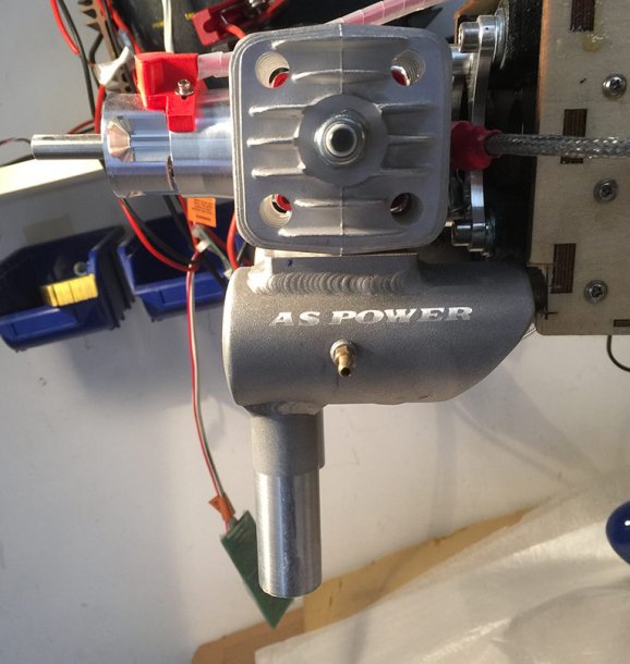

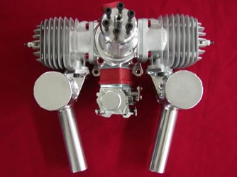

Muffler ASPower (www.aspower.it) just install in the model.. Good job and good jobs and product. I had not doubts because I had already try from ASPower and install in my old Yak 54 2,2mt PilotRc dedicated canister with great satisfaction

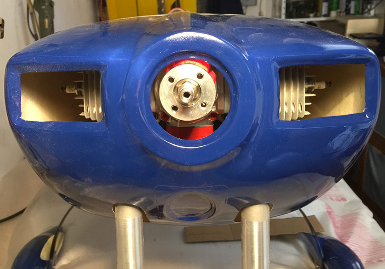

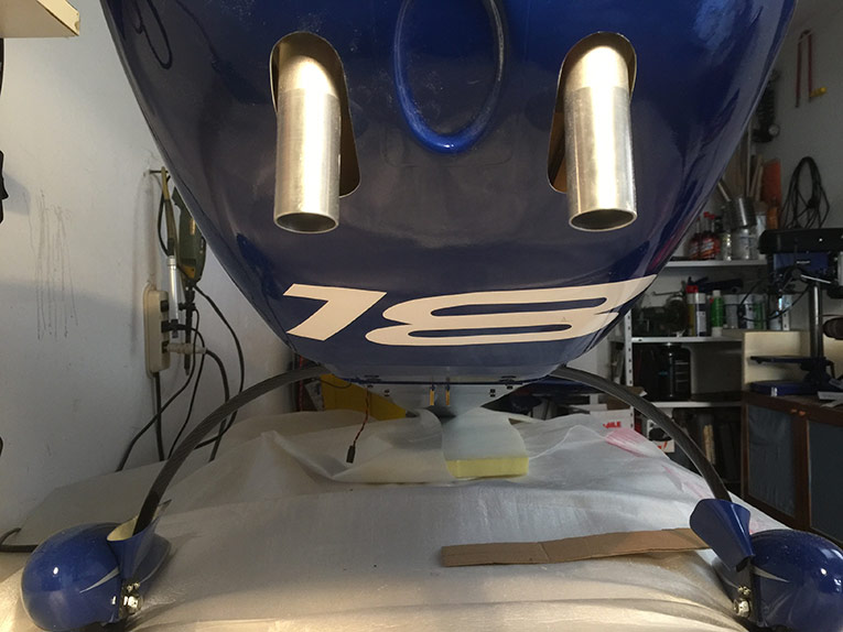

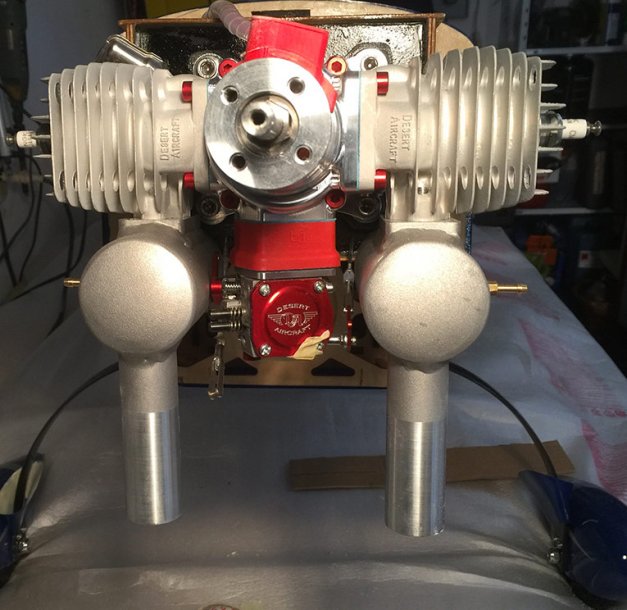

aren't those mufflers on backwards? shouldn't the angled part be forward to fit inside of tight cowls with a sloping forward surface? but then the smoke ports would be on the inside....hmmmmm, confusing
great looking product though. :yesss:
I understand your concern. But do you have enough room to access the needles on the carb? If you turn them around and use the left on right cylinder and right on left cylinder then the angled cap on the right cylinder muffler would allow better access to needles and smoke taps would remain facing outwards. You then could make some aluminum tube extensions to get the stacks outside the cowl. Might even give you a little more clearance for your throttle arm and clevis.
No problem. I have rotate the muffler and install in next direction...

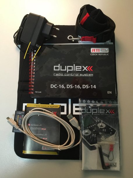

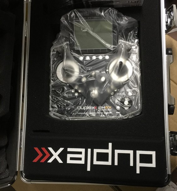

Finally arrived the new radio. After so many years I decided to switch from Futaba to Jeti for two reasons: first the trade policy of Futaba: i thinks that the relationship of price/performance it's less convenient (my personal opinion). The second because after reading so many positive reviews from these Tx I decided to try it.
I buy it In Italy from Hobbytoys (http://www.hobbytoys.it) the Jeti DS-16, which differs from the DC-16 for dimensions. The entry level is the DS-14 Tx which has the structure similar to the DS-16 (lacking a pair of switches) and some features are disabled and that can be enabled later also activate online but behind payment.
The Jeti DS-16 Tx comes with included in the package (in addition to the transport case) the RX 7 channels Duplex protocol EX system that handles up to 16 channels of high-resolution, real-time telemetry and EXBus for interfacing with regulators, stabilizers voltage, sensors and worldwide system Jeti Duplex EX. The peculiarity of the system Duplex EX is the interconnectivity between compliant devices and allows devices to interact. You can, for example, program wirelessly directly from the Rx Tx.
In the kit DS-16 find the USB cable to connect the PC to Tx, the charger, the strap, manual, a set of allen keys, mat.

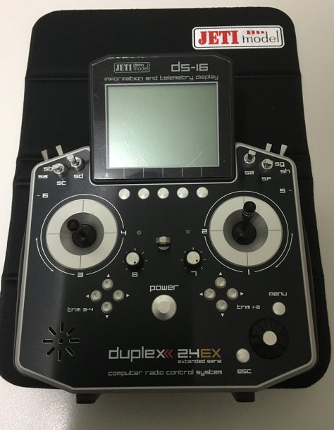

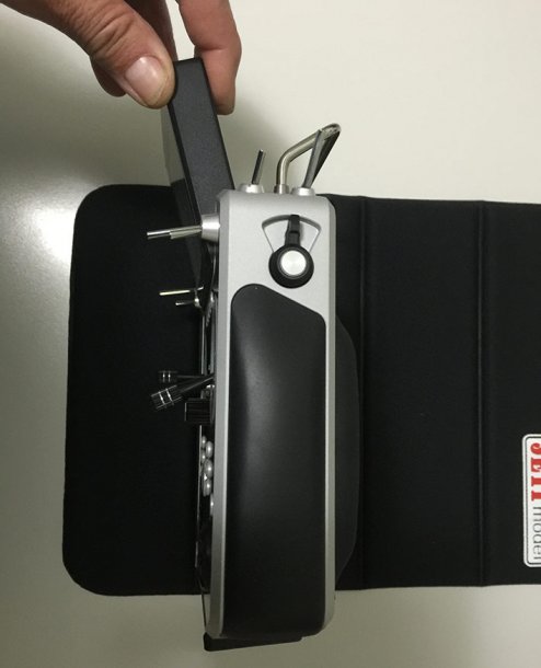

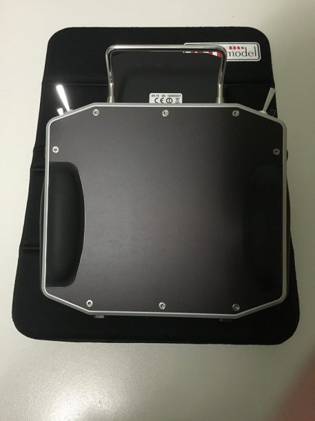

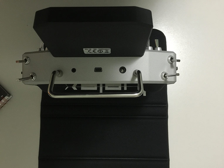

I must say that at first glance the radio gives a feeling of solidity and also tilted the screen is easy to read.
