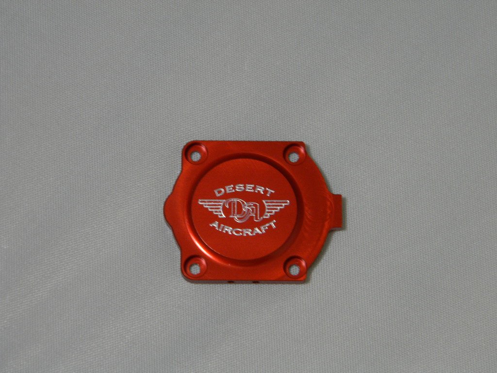

New DA 120 Carb plate
Discussion in 'Gas Engines' started by Rusty 73, Jan 17, 2017.
  1. Just wondering how many guys have this new carb plate for the DA120 . The guys at DA tell me that the two holes on the bottom are to help regulate the diaphragm much better instead of drilling and screwing a nipple to the middle of the plate and venting it to atmosphere.
    Snoopy1 likes this.
  2. GSNadmin
    GSNadmin Staff Member
    I have not tried that may have to look into it.
    Rusty 73 likes this.
  3. It's only twenty five dollars ,I'm replace the old style on my carb and using this new version, worth a try !
    Adds a little bling as well.

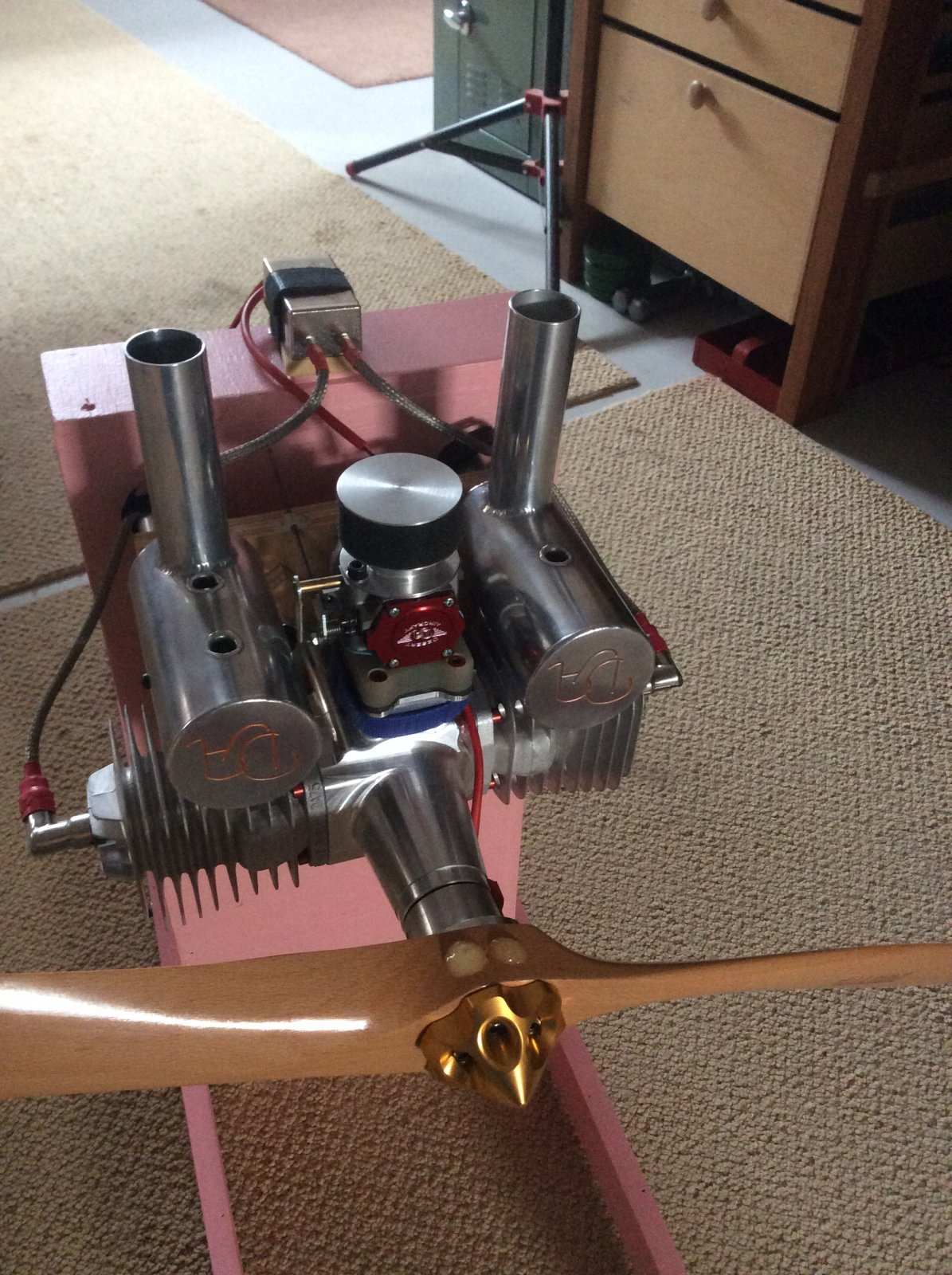

  4. Snoopy1
    Snoopy1 640cc Uber Pimp
    4,087
    5,728
    Canada
    Do you mean one like this, yes I got it from DA last yea at JoeNall. Was having problems and solved it. On the picture it is on the test teas checking how well it works. The plane it was on is an exposed engine and having hunting problems and it solved it but it does not work that well inside a cowl.
    Luchnia and Rusty 73 like this.
