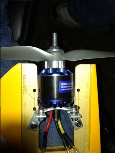

Here's my conversion to electric so far. Sorry about the quality of the pics... they were taken in the living room that is loaded with stuff as we rearrange, but I was able to do some work anyway.
I used some standard corner brackets that I put a twist into. I drilled a third hole in the mounting area and bolted the brackets together through that hole and then bolted them to the X bracket that came with the motor. The motor I chose was on my shelf; an Exceed Monster Power Series, 670 kv. Not sure yet whether I'll run this on 5S or 6S, it depends on how the CG works out and what kind of power I get from the two options.

well, that's a good start! how did you ensure that any right/down thrust was not lost when you made that bracket?
and in pic 4 it appears that your prop backplate is *very* close to the top and bottom of the forward engine mounts...how much clearance will you have for the prop>

I'm going to set the thrust with washers, which is why there is no clearance right now. Once the washers are installed (probably tonight) the clearance should be correct. I probably should have given myself more room just in case, but I can always add more washers.

Last night I added the washers and took another picture to show the clearance. The thrust angles now look correct.

Yes, it just cleared the motor can too. I had to file down the opening a little bit to get the motor to fit properly and thought that I might have to take off some more once I added the angles, but it just made it...
