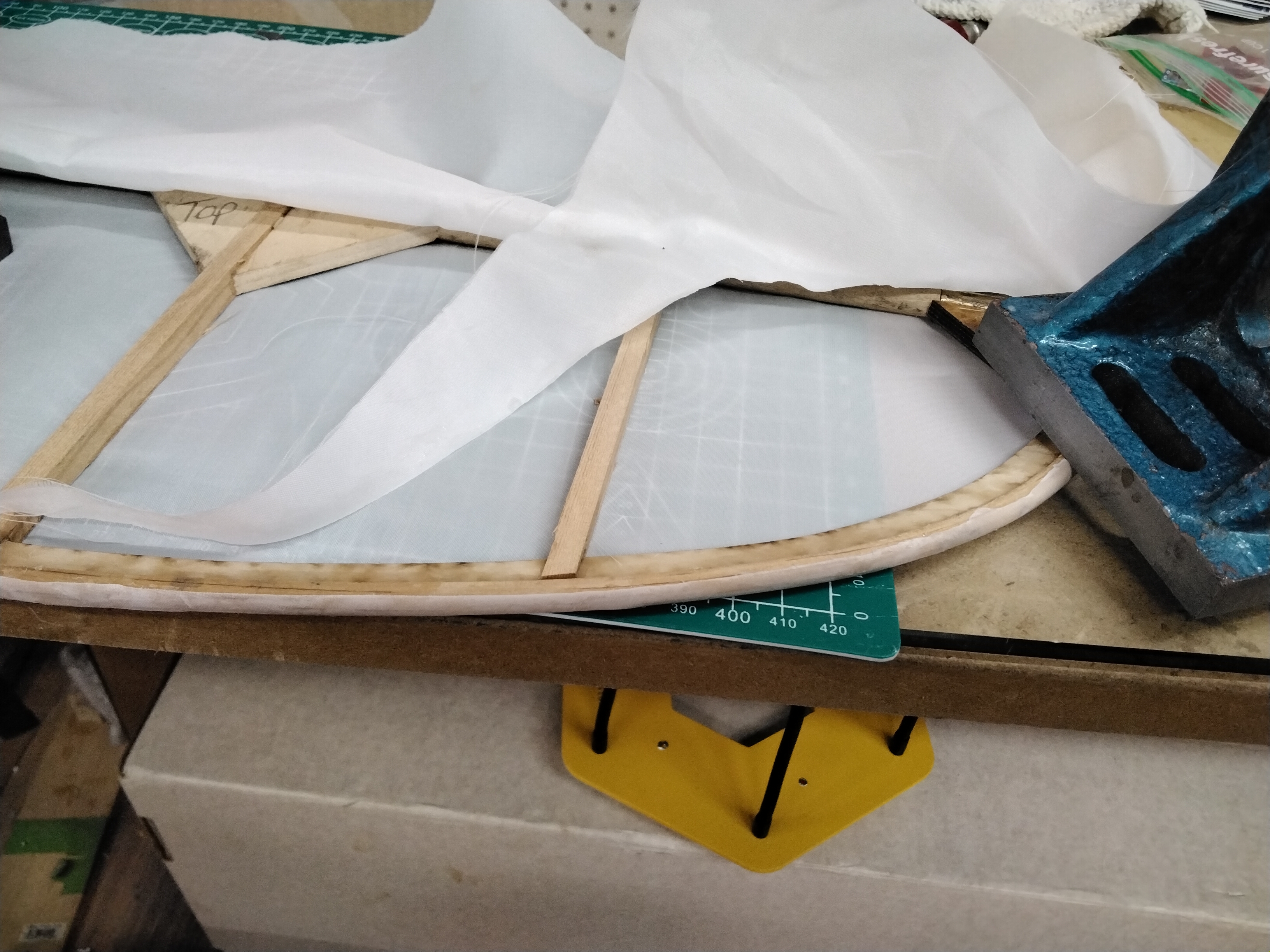

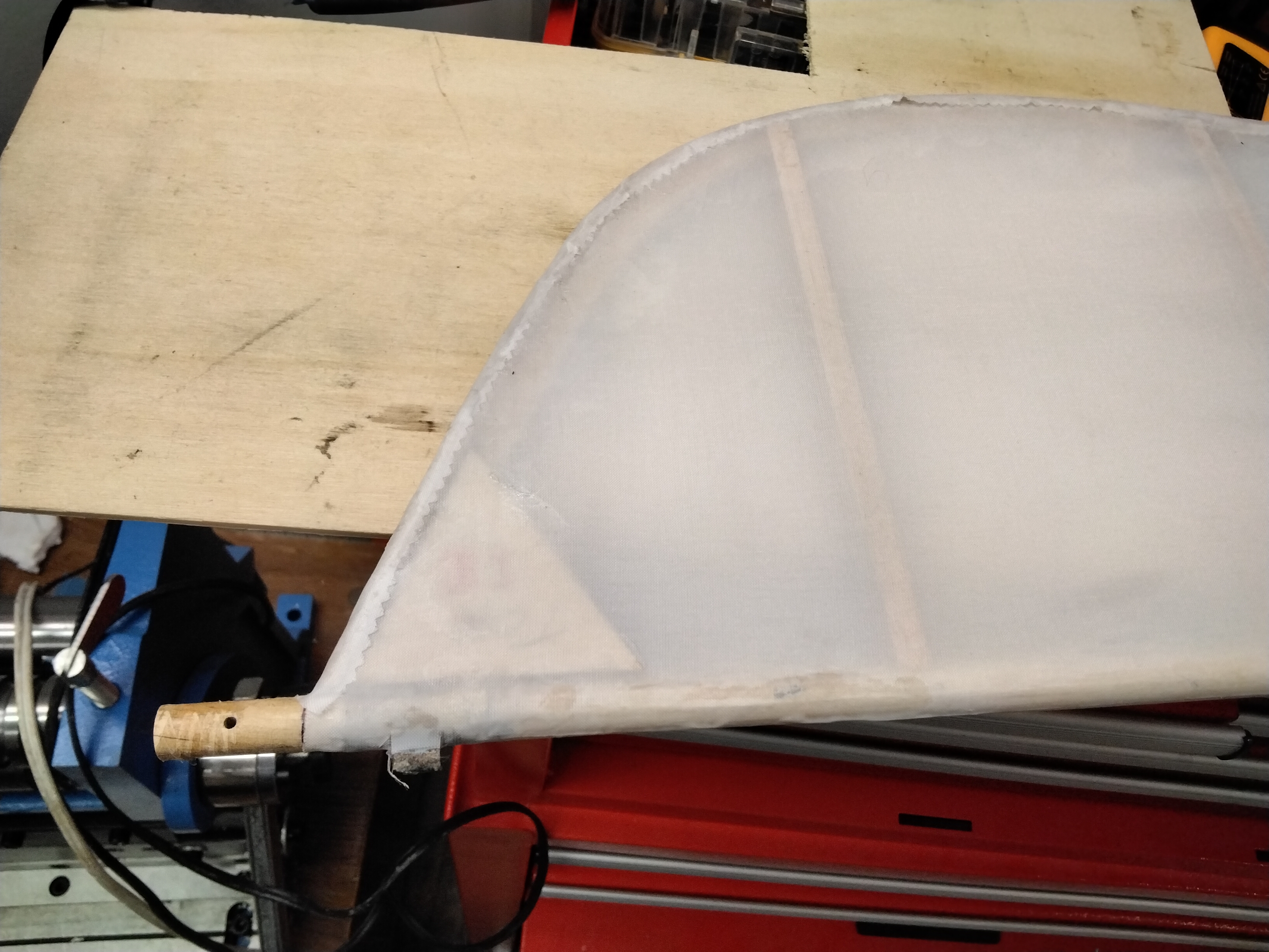

I cut a few pieces of bias tape for the rudder leading transition to the fuselage. It took a couple of tries before ) got a successful piece. As you have learned cutting a straight line is a PITA.
A little rough around the edges. Yes on the double entendre... 100's of videos on Poly-Brush but not much of anything on Poly-Tak. I think it's too thick, I'm going to do a trial piece and thin the Poly-Tak.
I smoothed some of the edge with an iron but not of too a good start.
I will strip this elevator half later and redo it.

Get the MEK out and clean it off and start over. Are you trimming the top covering with scissors? I would recommend cutting the top layer of covering further back to the center of the surface so the pinking tape covers it up.
