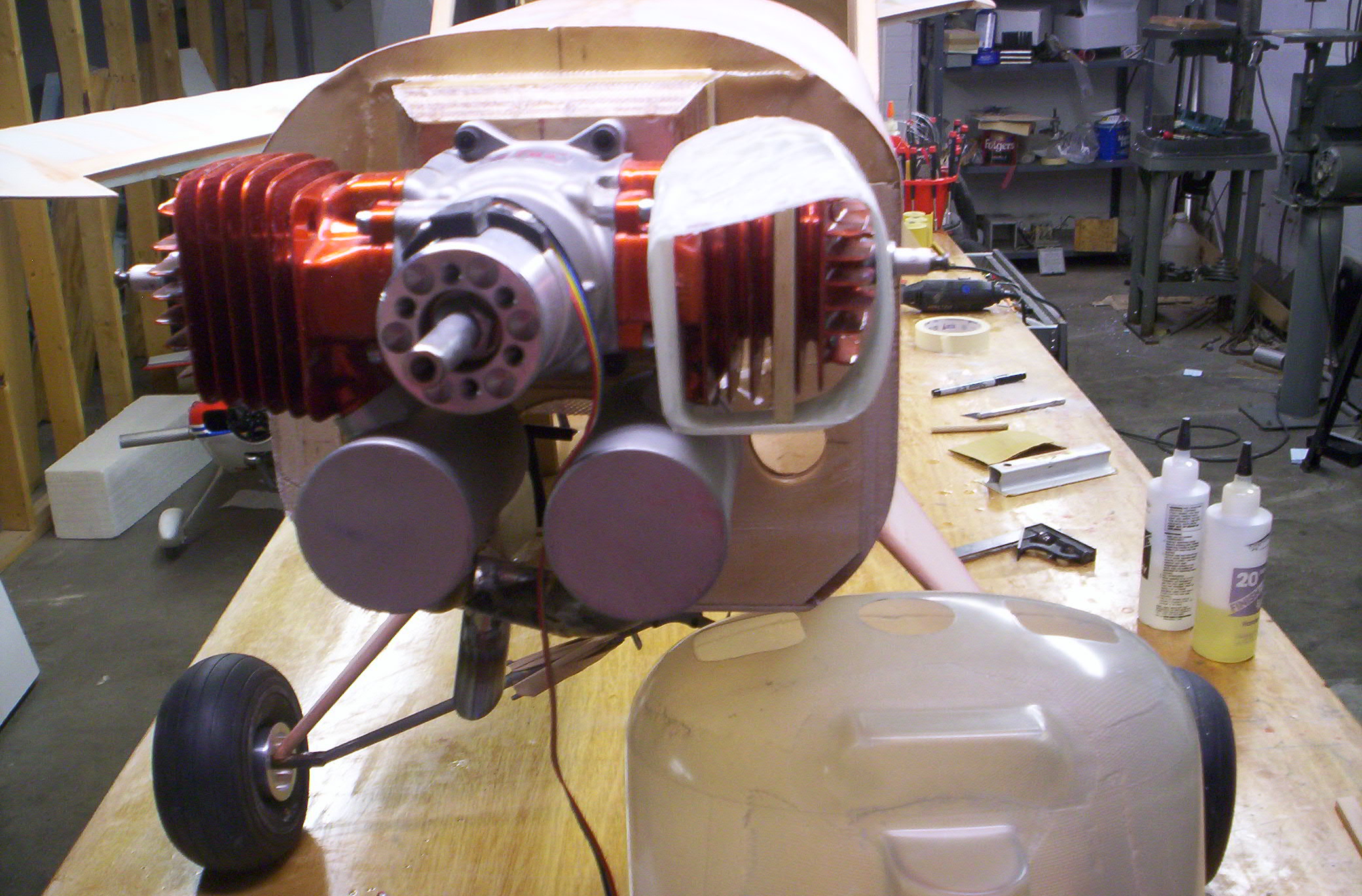

I have a D&B 5.1 in mine and it fits except for the very tops of the spark plug wires.. I can post a pic later. It’s 83cc and WAY over powered.

A 3W 56 twin fits nicely inside the cowl, used KS ss tube to locate the exhaust in the scale location. I may get this one painted someday!

Here’s a pic of how the D&B 5.1 fits, the stock D&B mufflers are angled in towards the center of the engine and exit the bottom of the cowl, then engine fits really nicely and like I said before has plenty of power. If you haven’t already I would do the option of making the rear stab adjustable as it shows you can do in the manual. Mine is not (I didn’t build mine a friend of mine did) and mine carries a lot of down elevator. Mine also has the full size 144” wing and it’s a handful on the runway in any sort of crosswind, I’d also build it clipped wing.
