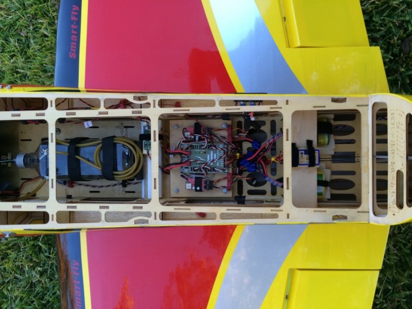

jaybird
I always mount them on sticky back Velcro, then wrap with a Velcro strap. No problems with it being in the vicinity of RX, batteries, throttle servo, or ignition. In this pic you can see it in the upper right side of the fuse, right across from the RX batteries.

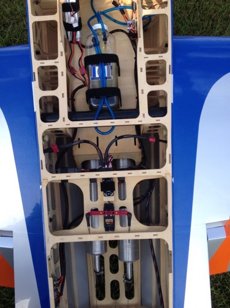

Mikeq
0
This where I stuck mine on my Yak...it's my 5th TechAero IBEC and never had any trouble with any of them..no more ignition batteries or extra switches for me... you can stick them pretty much anywhere like Ohio AV8TOR stated...
