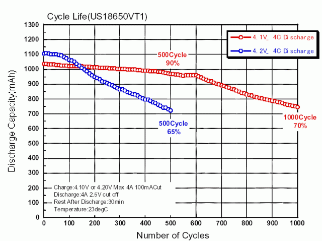

Some quotes from RCG
More than a few set their chargers to charge Lipolys to 4.15V per cell as a compromise between full,longer life and faster charging / balancing.. Everydayflyer
FWIW, many of us deliberately terminate charge at 4.1-4.15V/cell as doing so has been empirically proven to extend the number of useful cycles for lipolys at the expense of a few seconds of flight time. mrforsyth
This is why I charge LiPos only to 4.15V. I heard that the military, where dependability counts even more, charge them to only 4V or so. Maybe a little more. Julez
If you want maximum life expectancy, charge as LiIon. Every 0.1V less doubles the life expectancy. Julez
