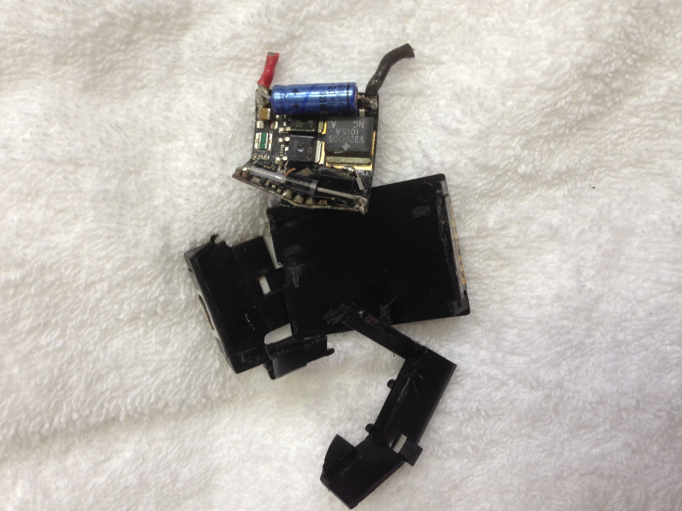

If you do want to use a BEC, many people like and use the castle CC pro, I loved mine until it exploded mid flight(FYI: I was pushing it very close to its limits).
