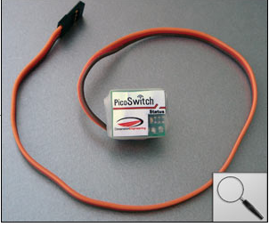

I use this on a flat wing foamy that works well. I use the flight pack battery balance tap for pwr. I used it a good while ago to activate an onboard camera. I set aside then just found it again so I tried for light and works. :)
http://www.dimensionengineering.com/products/picoswitch
