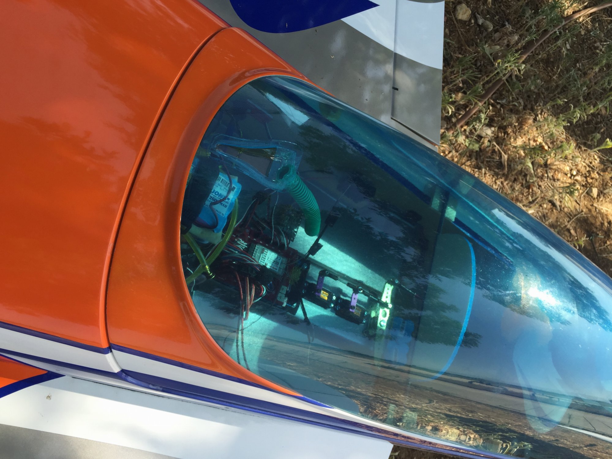

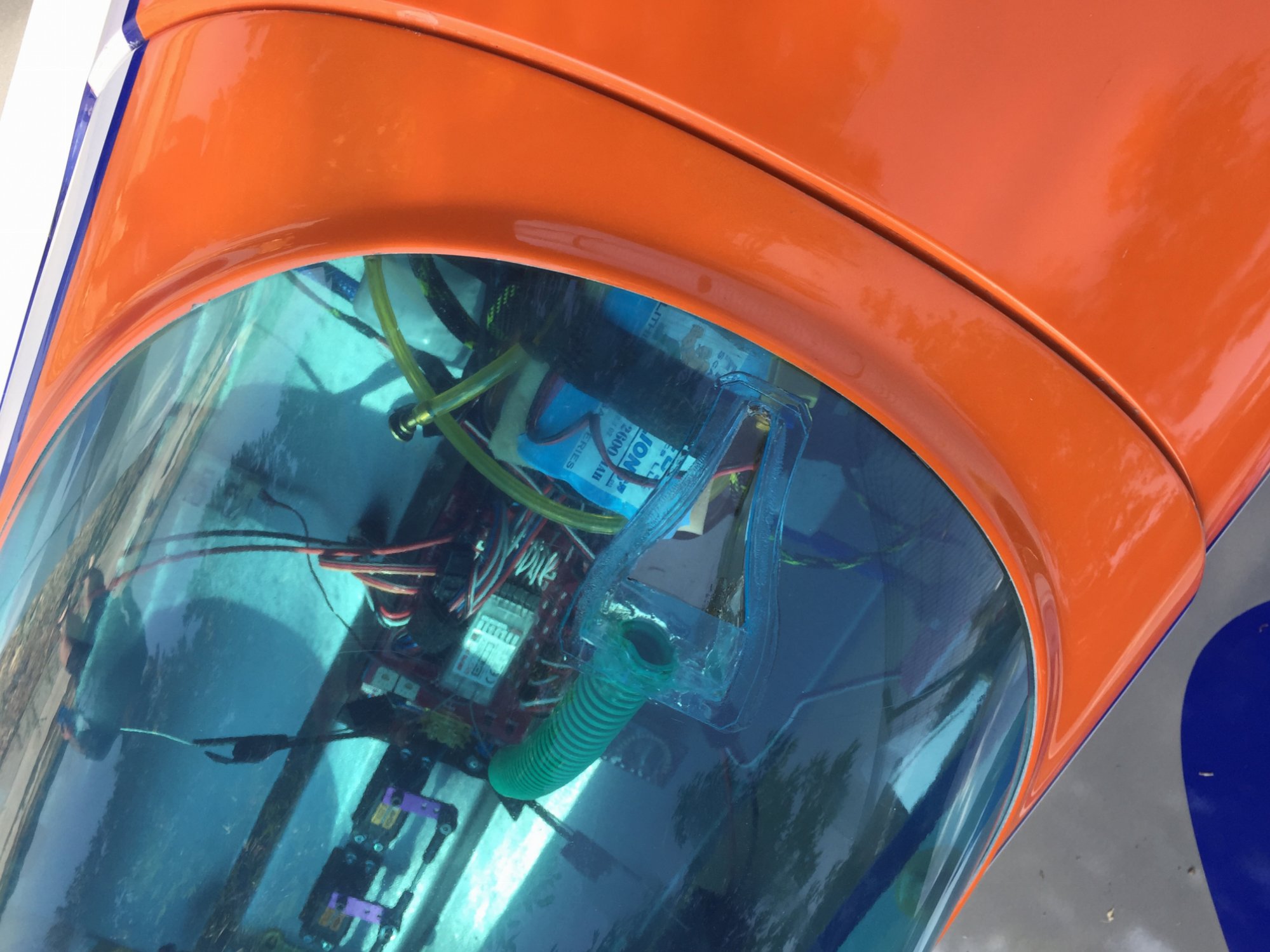

I had the chance to check all the new ducts I did this last weekend with a temrature of more then 97 in the shade.
Also I did a special duct on the canopy that will direct cool air straight to the RX and SmartFly as you can see in the picture attached.
Being said the temrature after a 10 minutes flight was 122 on the RX
113 on the reg.
It appears that I will need to open about 30 sq inches more to let the hot air ascape more efficiently from the fuse.
Last thing is isolating the cans a bit with some wind shield car shade, it's flexible light and very easy to install and see how it effects the temp.
