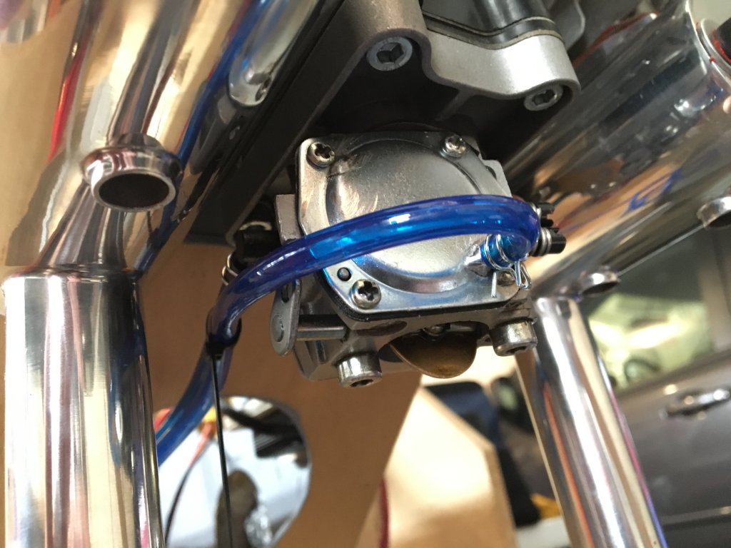

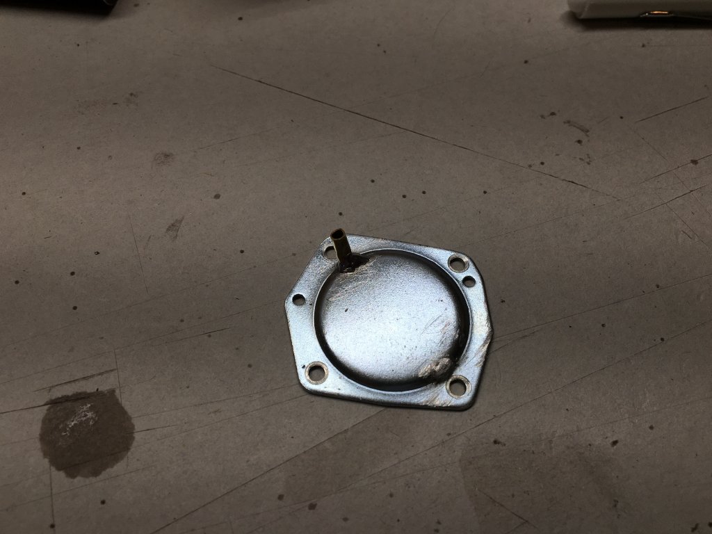

Ok so the only issue I had when flying last weekend was a small hesitation in the engine. It didn't do it all the time and usually on a 45 degree up line when rolled inverted. @capthis thinks it's a pressure change in the cowl causing issues with the carb metering pressure.
So I soldered One of the holes closed and soldered a small piece of fuel tubing in the other hole. Then I attached a piece of fuel tubing to it and I'm running that back inside the fuselage.
While I'm at it, I'm going to make a plate to seal off the fuselage from the cowl. Currently there is a large hole in the bottom motor box plate.

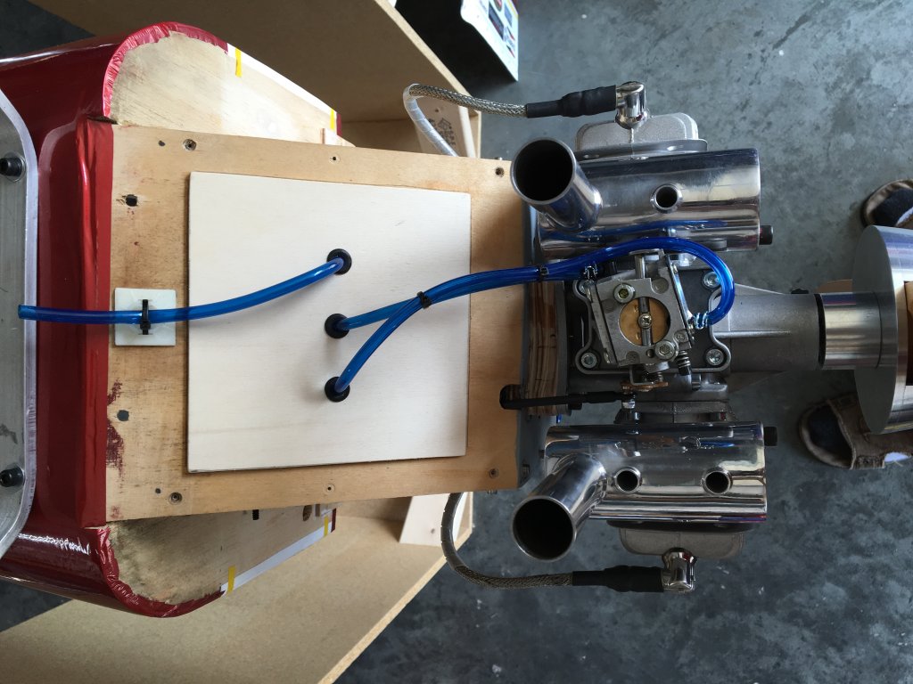

JAG
Added a ply plate to seal off the fuse and added some grommets for the fuels lines. Going to spend a little time going over all the bolts and make sure everything is tight. Then put the cowl back on and get it ready to fly.

BalsaDust
Where you get the blue fuel tubing from Josh? That hangar 9 edge I did for a buddy had it as well but all I have used is the greenish yellow tygon and black viton tubing.
JAG
TaildraggerRC
That's the only place I've seen it. Chad said it holds up well but time will tell. I'm not a fan of the yellow tygon since the yellow rubs off on stuff.
BalsaDust
Interesting. I haven't seen mine rub on anything as of yet. I only use it outside the tank though for my pick up in the tank it's the black viton tubing.
JAG
Maybe it was the batch I got, maybe it was old. But my hands were yellow when I was done. And it runs yellow off on white covering.
