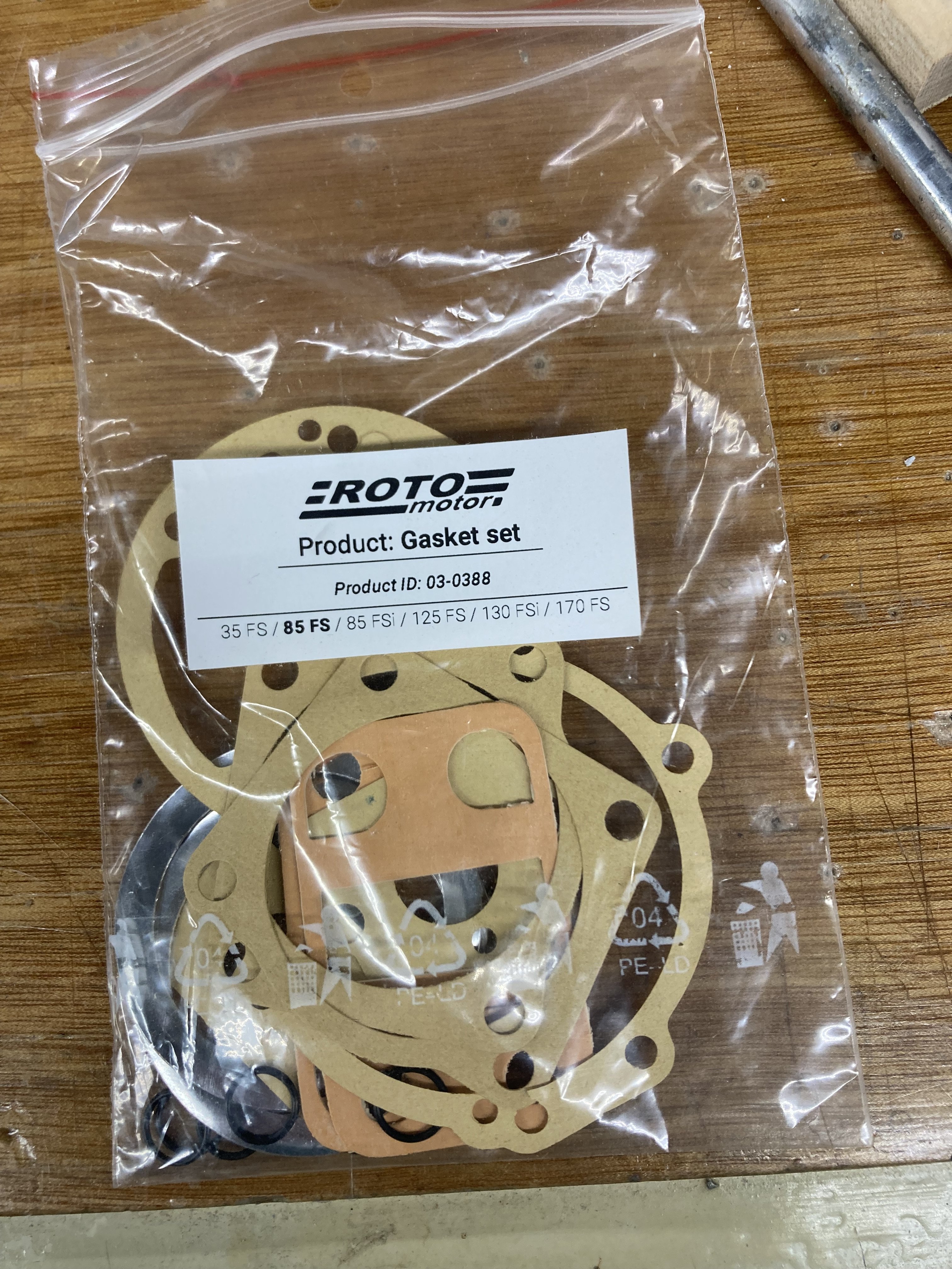

The left side pushrod sleeve seals were leaking on the engine in my Champ, while the plane is down for refinishing I planned to replace the seals. I ordered a gasket set from Vogelsang Aeroscale some time ago. The cylinder head must be removed to accomplished this task. I have possibly an hour on the engine which was bought new while building the Champ, the pushrod sleeve seals had leaked from the very beginning.

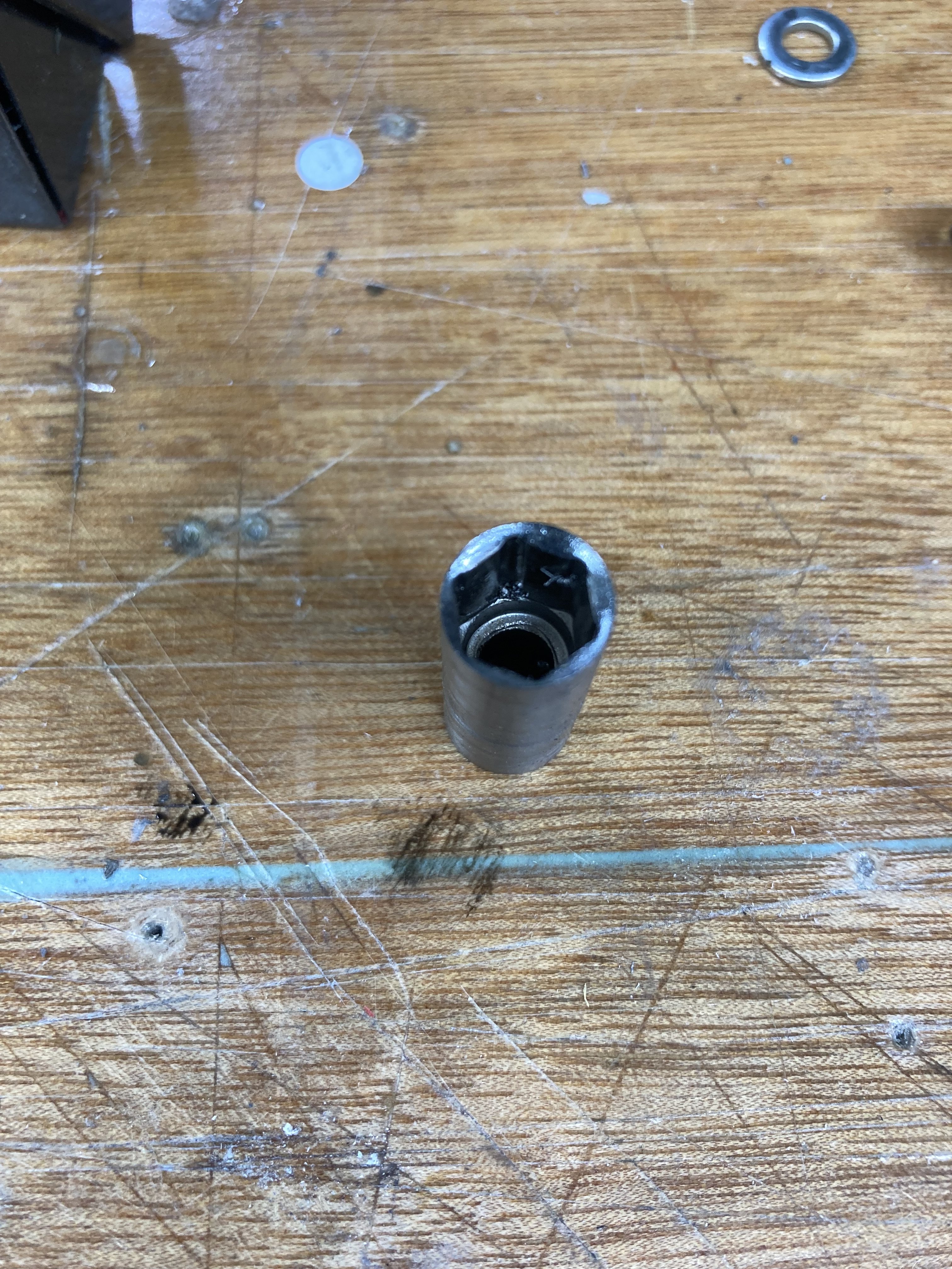

In order to remove the cylinder head 8 mm nuts, I had the turn down a socket to fit into the head, a twelve point socket may have worked but I don't own one.

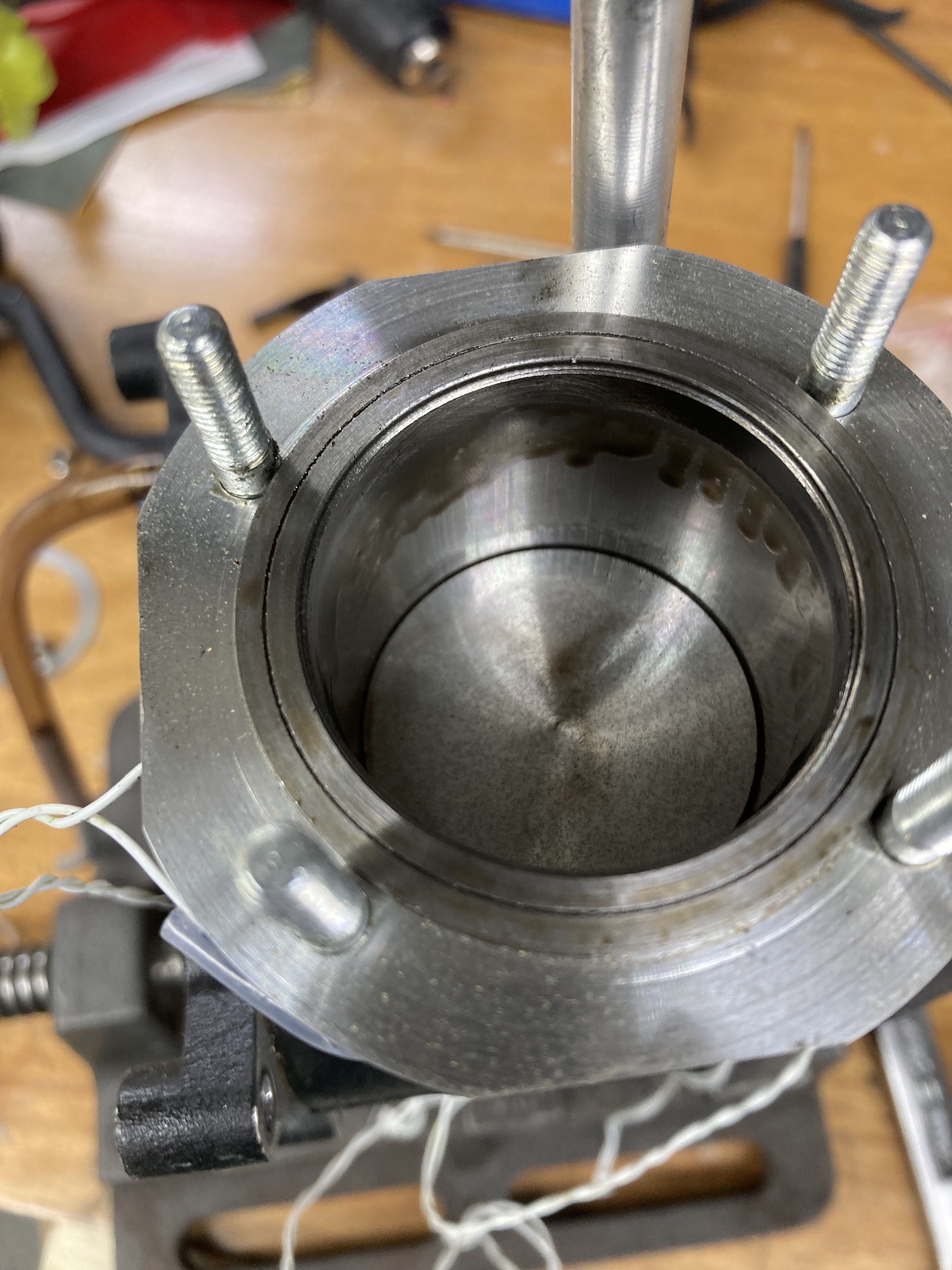

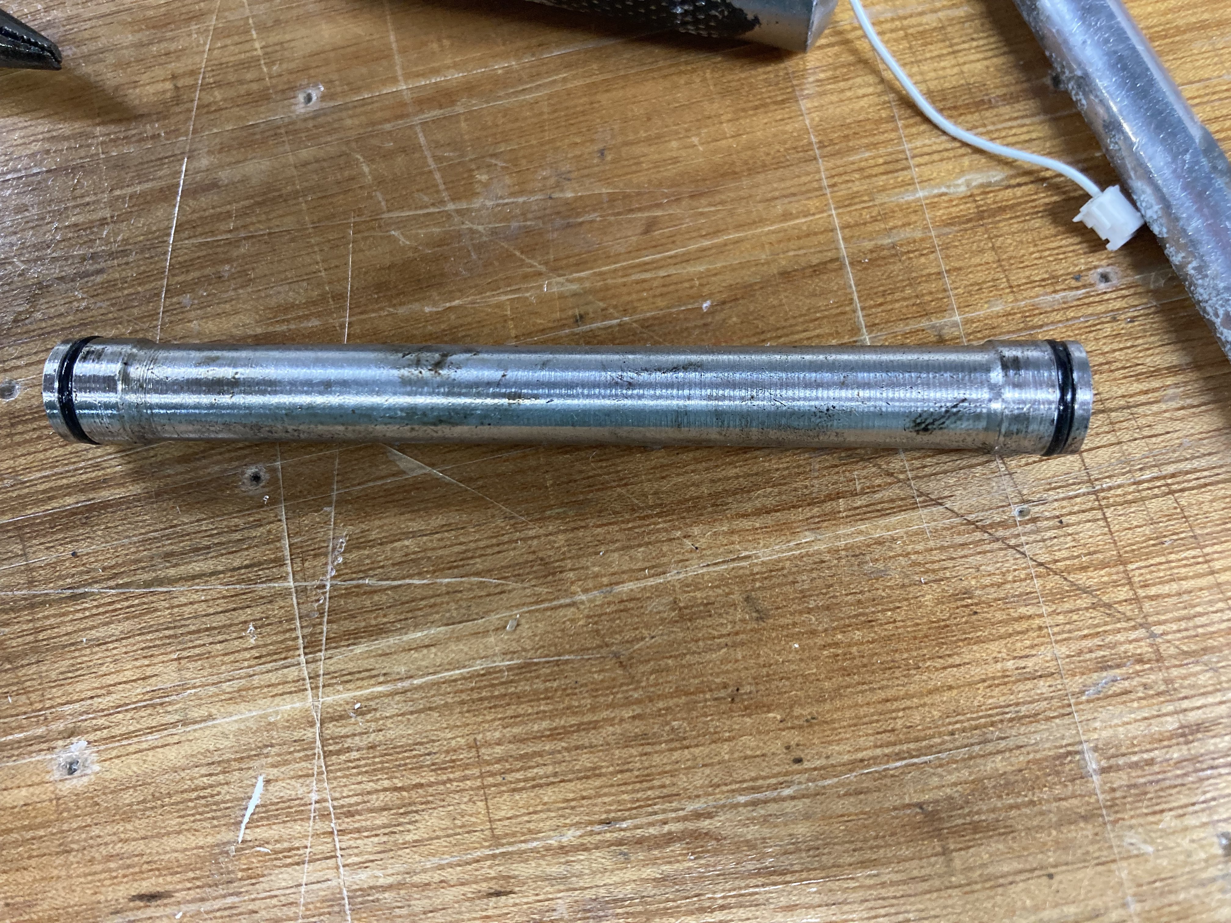

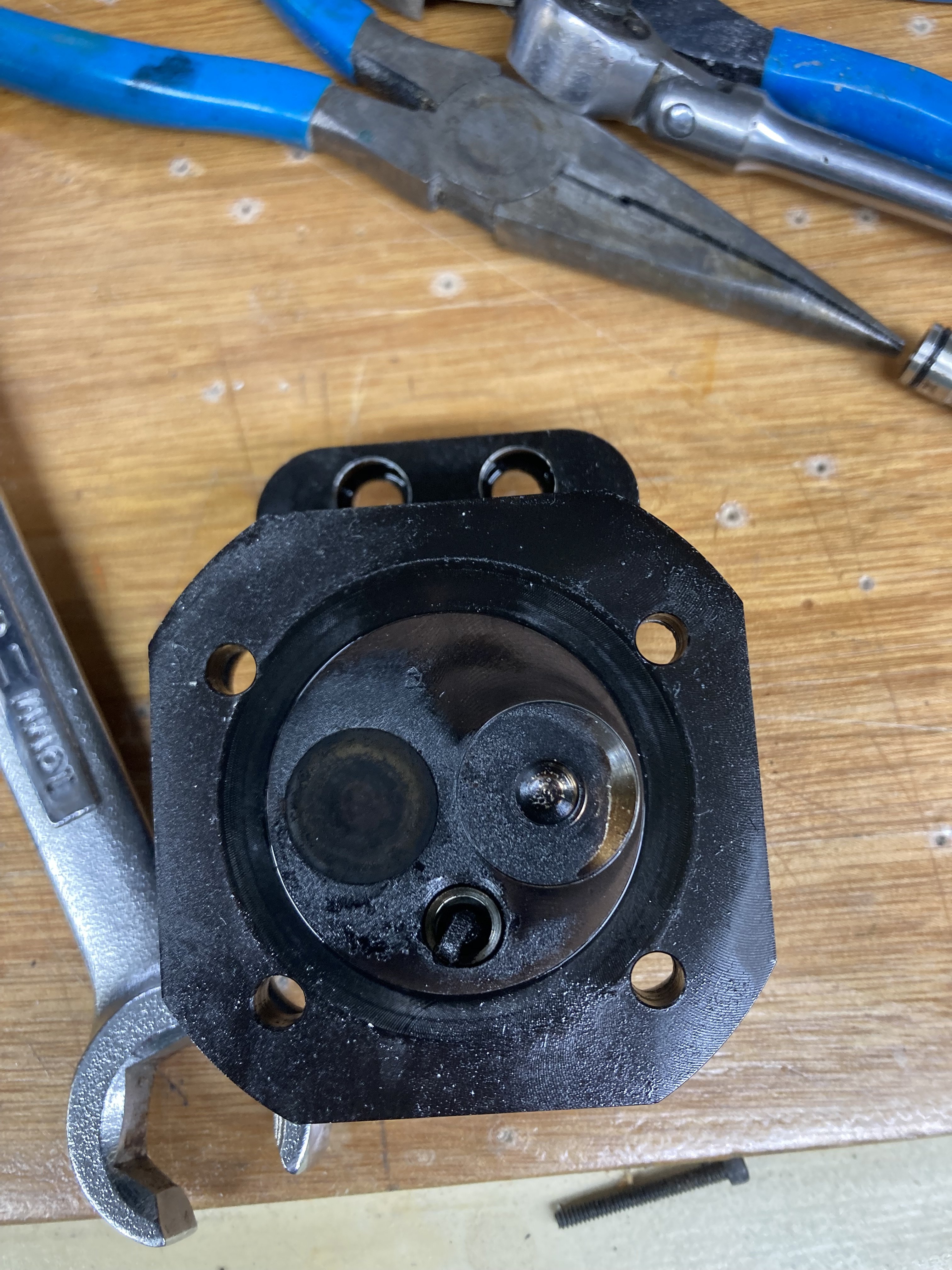

As stated there is about an hour on the engine. I was surprised at the carbon deposits on the cylinder head, the cylinder bore looked great however. Once the head is removed the pushrod sleeves can be removed. The sleeves are sealed with "O"rings on each end. I using Red Line racing oil mixed at 30 to 1, a 30 to 1 mixture was recommended in the original manual. When the second engine for the Cherokee, that manual recommended a 40 to1 mixture of Motul 800 oil. I checked the latest manual on the Roto web site and they are now recommending Sthil HP Ultra at 50 to 1. This engine does put out some oil so I am switching to Ultra.

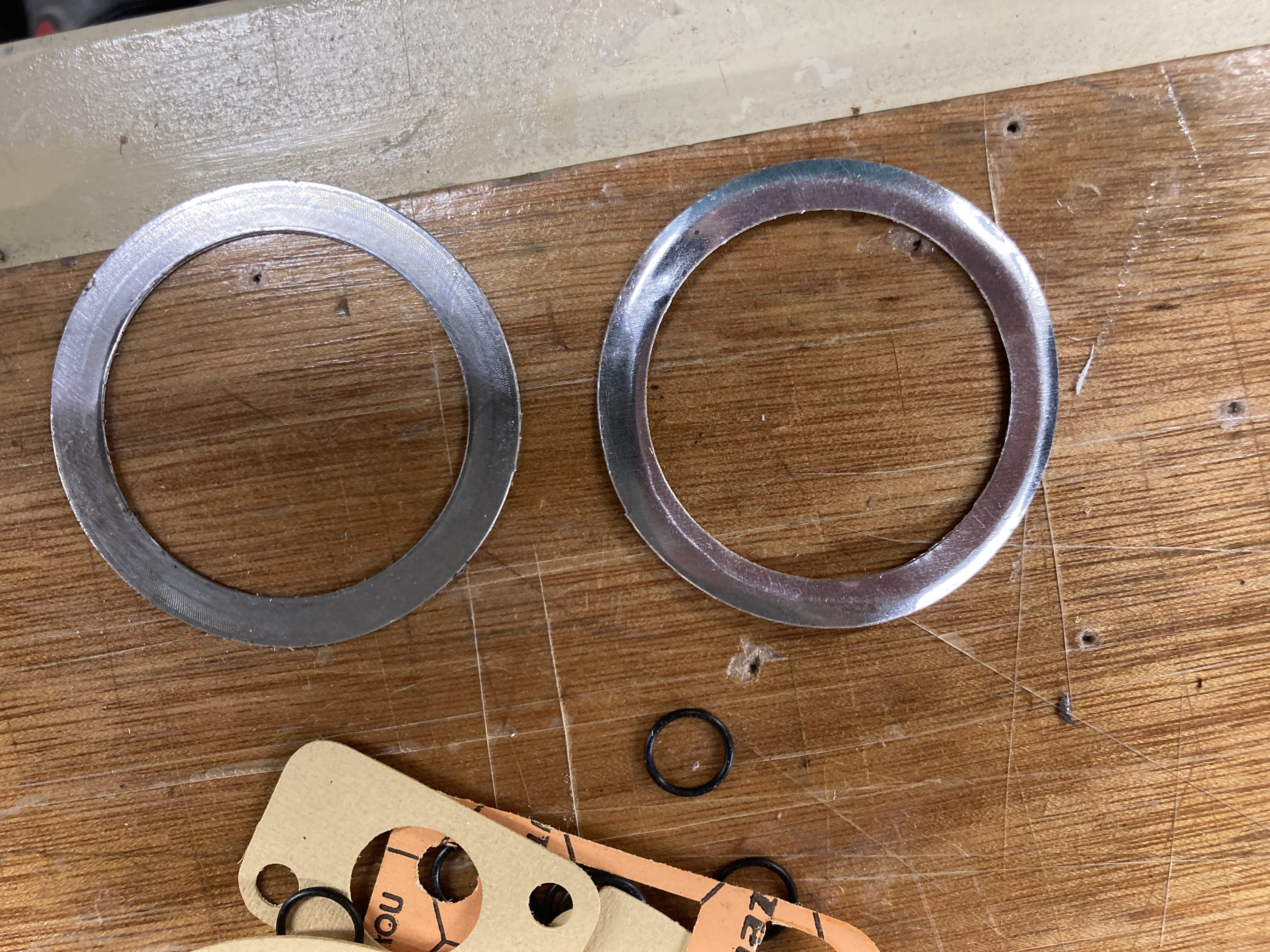

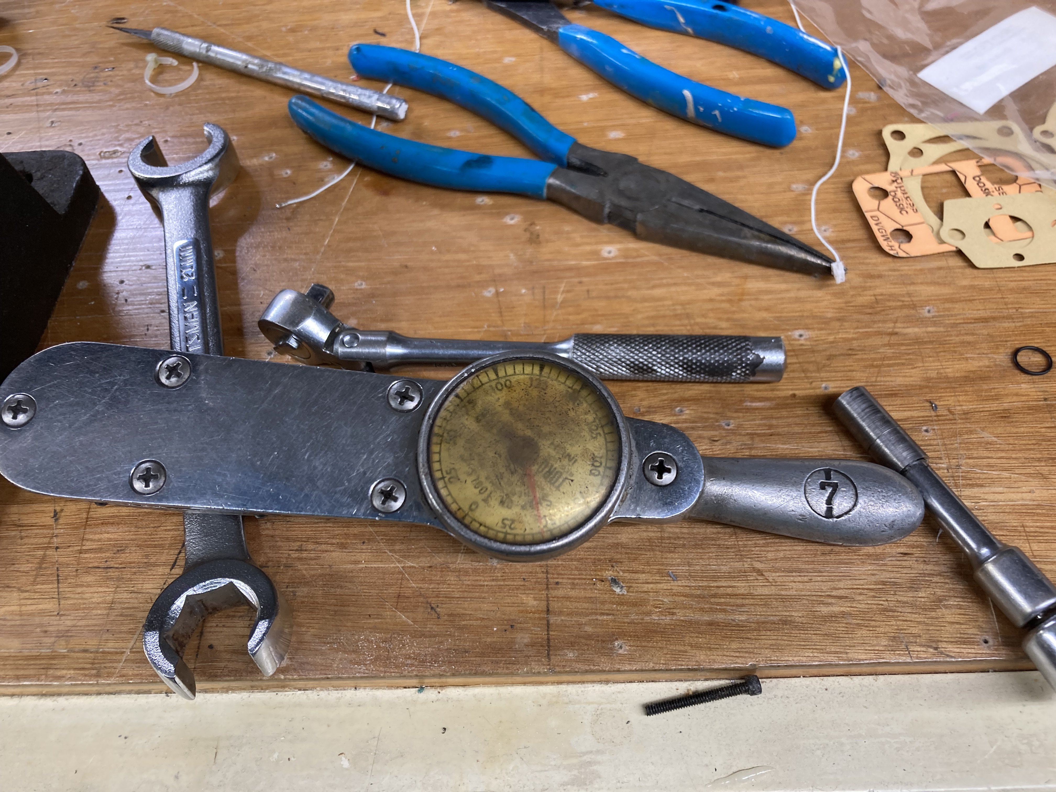

The new head gaskets are somewhat convoluted as seen in the photo on the right and get compressed flat when the head bolts are torqued to 42 inch pounds. I had to borrow the old trusty Snap On dial torque wrench from my brother's auto repair. I'm pretty sure my dad purchase the wrench in the 50's. We used it back in the day to adjust bands on automatic transmissions. I checked the valve lash on the this head and it was at spec, .004" intake, .008 exhaust. I decided to check the other side and found both valves were loose. I retorqued the head and adjust those valves to spec. It's ready to go back into the Champ, hopefully it doesn't leak!

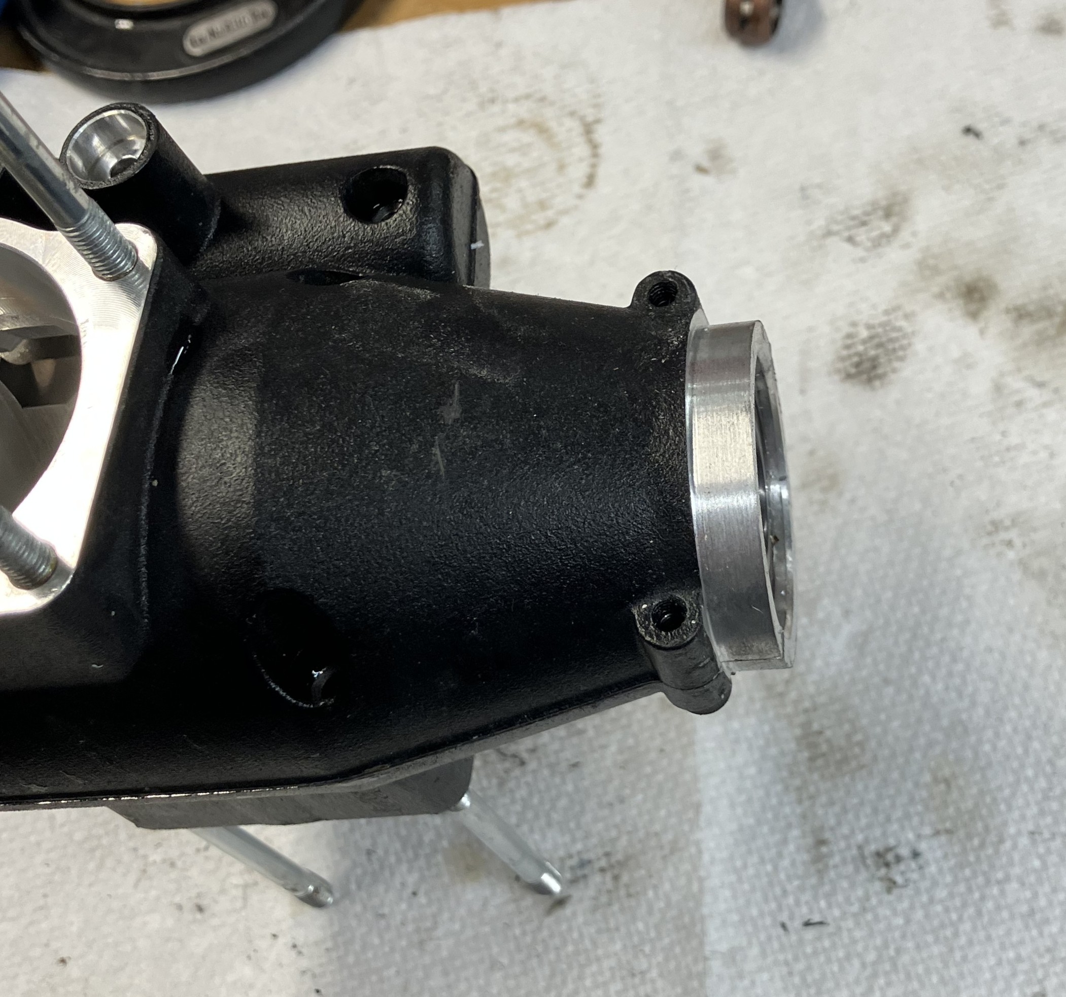

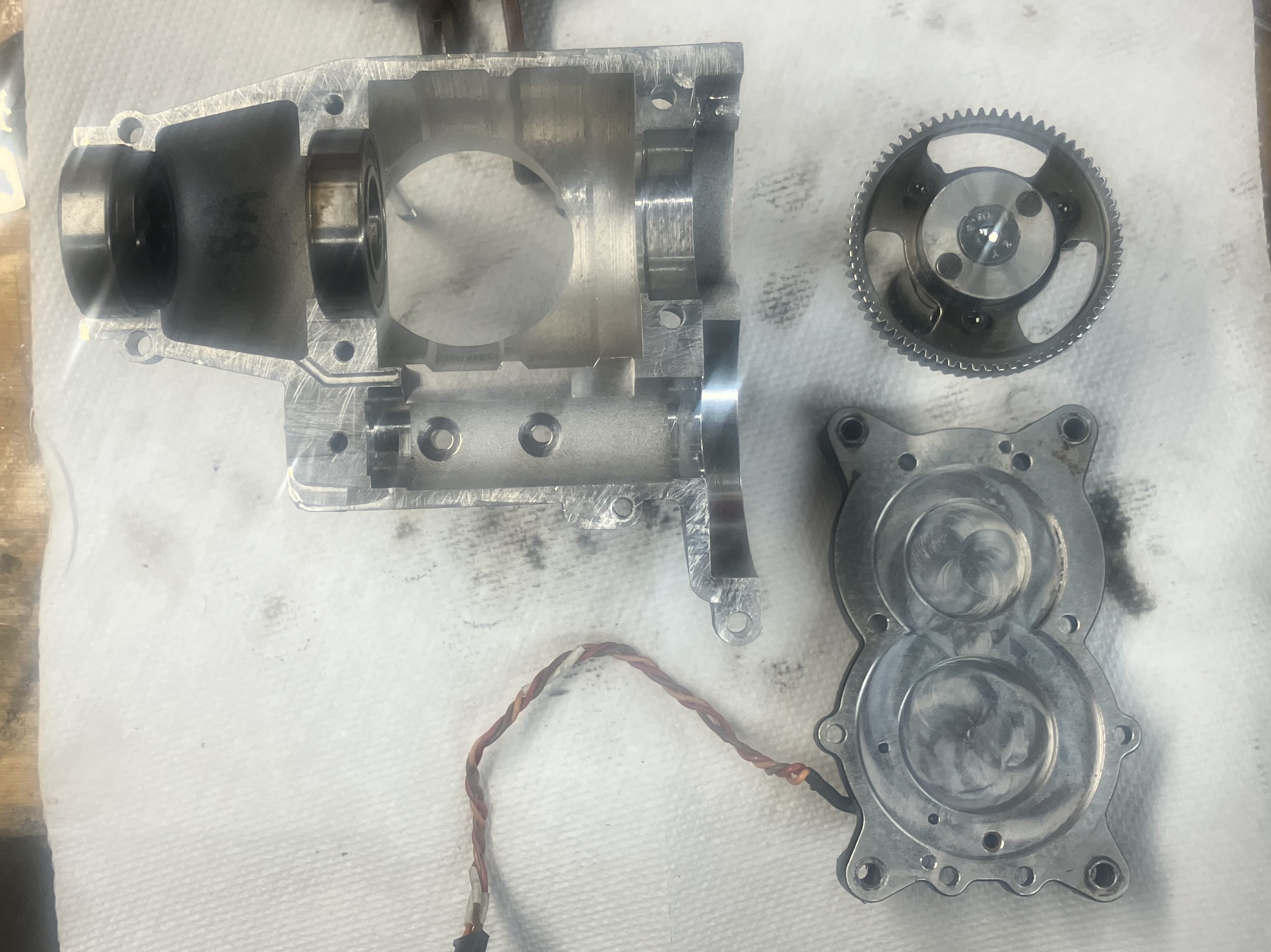

Removed and disassembled the engine. While apart a few modifications were made as well. The crankcase looks to be an investment casting, the outside is not finished. I hope to include a starter in the future so the crankcase was setup on centers on the front and rear bearings and the nose was machined concentric with the bearings. This will make it easier to fit the Ephil 76 starter that I plan to use.

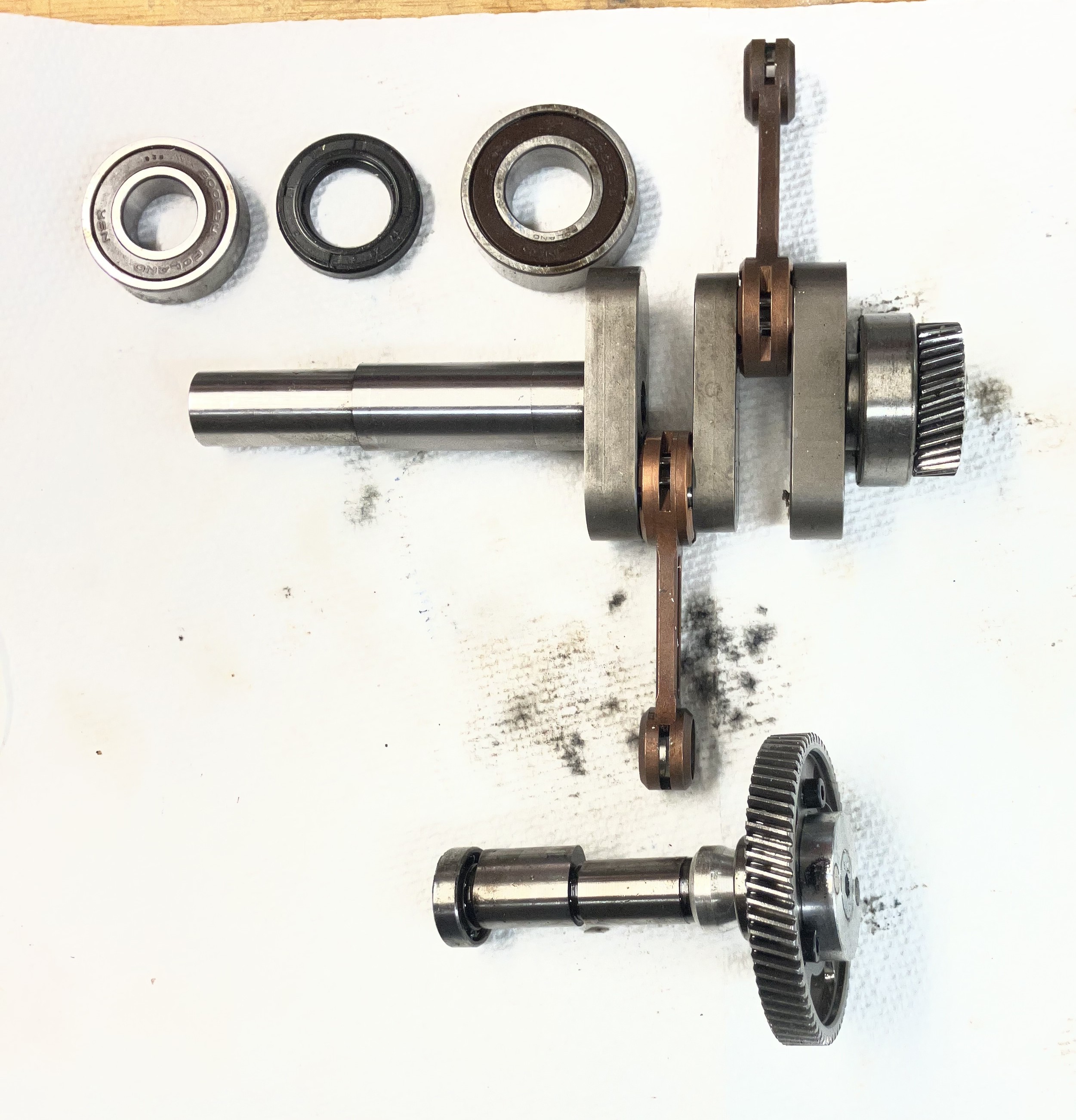

The crankshaft is a three piece design and looks to be robust. The crank pins are machined on the center throw and pressed into the front and rear pieces of the crankshaft. The crank is supported with 6002 bearings on each end and a 6003 in the center just ahead of the front journal. There is also a lip seal just behind the front 6002 bearing. The cam throws are wide to allow the tappets to ride.
The wrist pin bearings are individual needle bearings rather than a caged type, the journal end appear to the caged type. Should be fun getting the pistons back on.
There are two magnets on the cam to trigger the ignition. The hall sensor is mounted on the back case however there no penetration into the crankcase, I was expecting a hole there. There are very clear marks for putting the cam in time. The ignition failed on my first Roto and I sent it to CH Ignitions for conversion to RcExl, Adrian cut the stock pickup off and mounted the pickup on the front, just wondering why?
Both front bearing are double sealed along the the included lip seal. The bearings and the seal are shown below. They really didn't want the front bearing to leak! Should any oil get past the center bearing, a leakage port back the crank area is provided. There are five seals between the crank area and outside the front bearing. I do plan to eliminate the inner most seal on the 6003. A new SKF 6003 bearing and a 6002 Timken bearings are expected today.

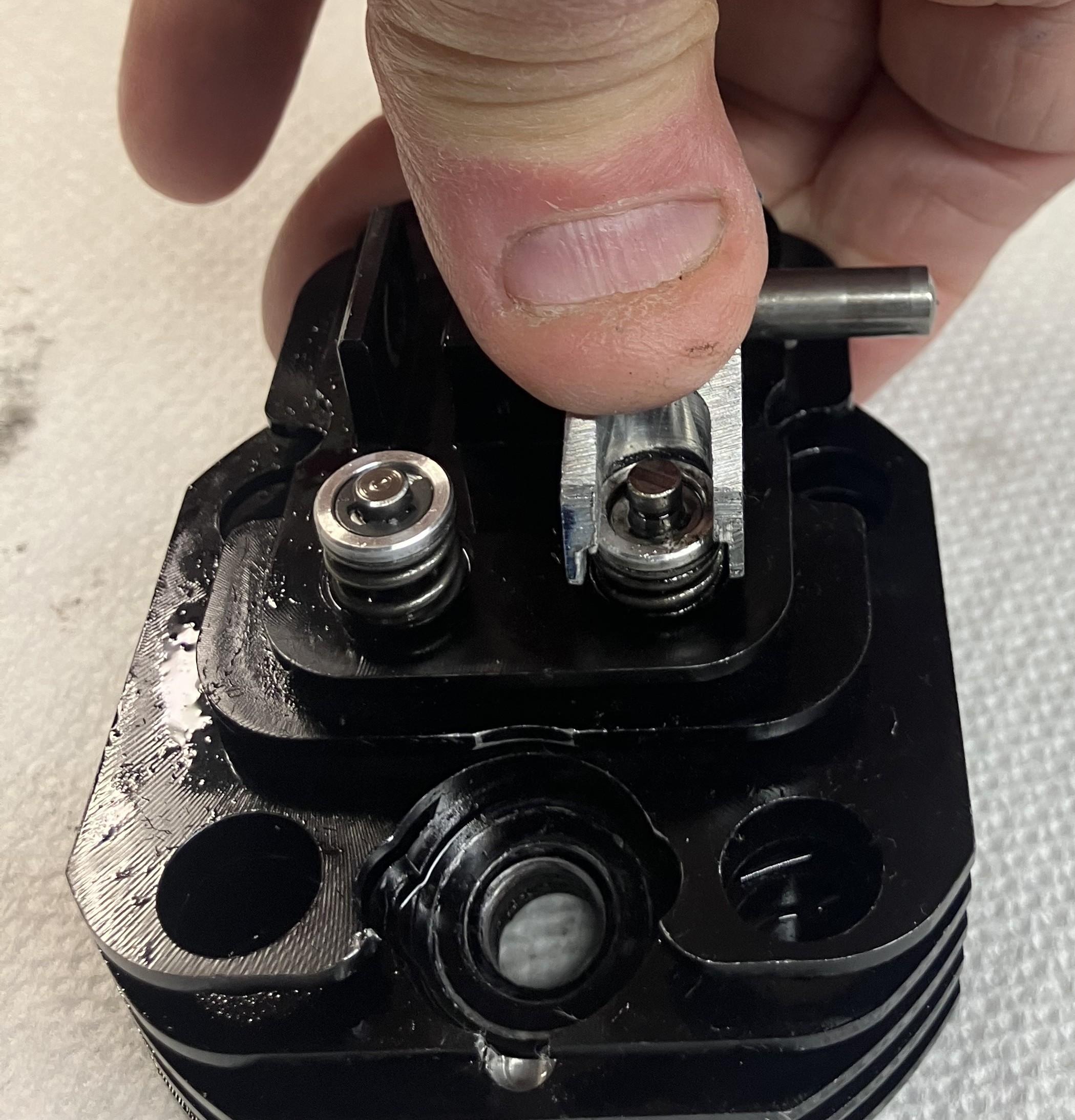

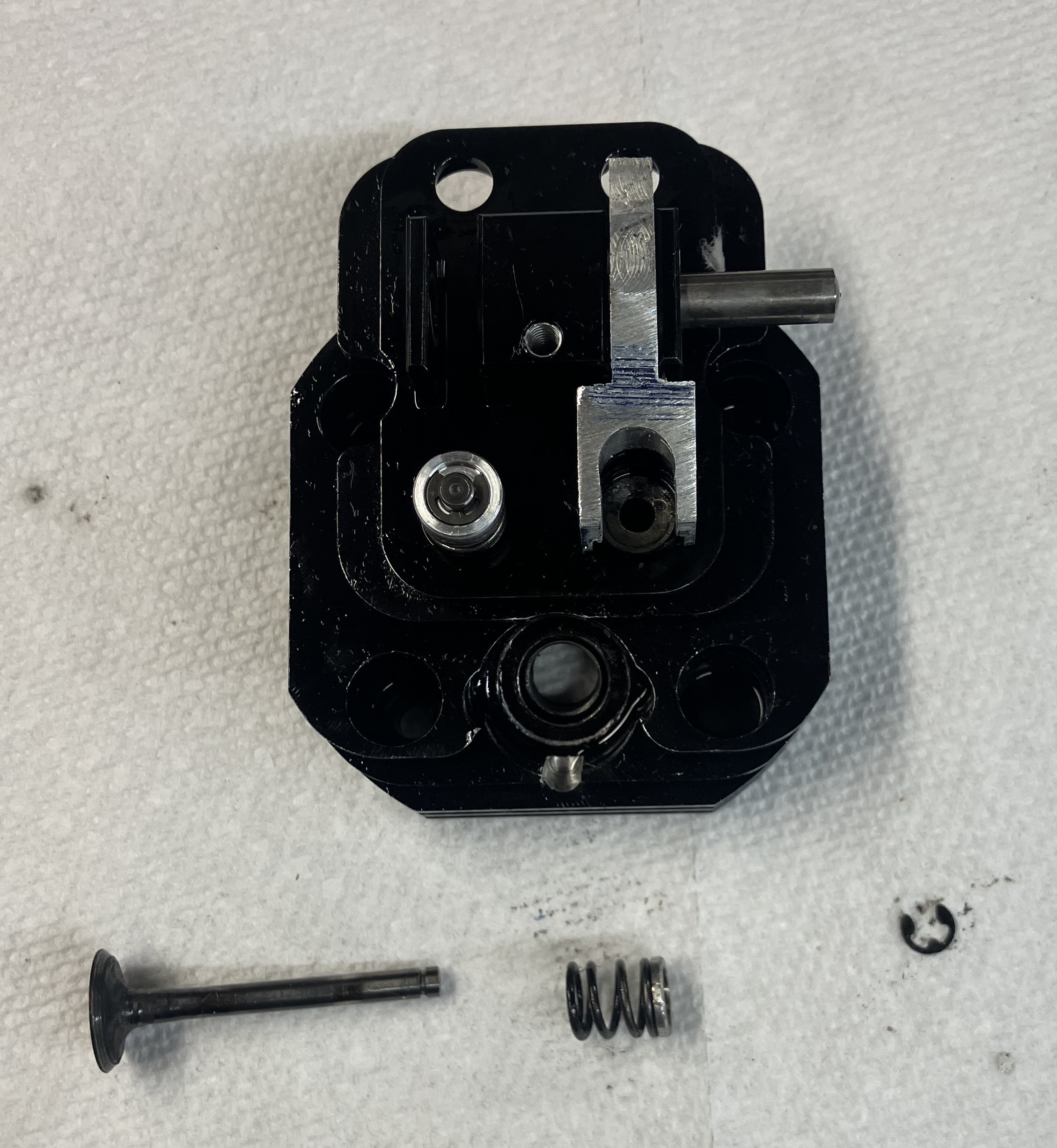

While apart both exhaust valves were cleaned. I'm using Red Line Racing oil at 40 to 1. The carbon deposits were on the soft side and cleaned pretty easy with an Exacto knife. The parts were soaked overnight and more carbon was removed. I don't remember how the valves were retained in the first Roto 85 purchased but I knew a tool was needed to get the retainers installed. On this engine the valves are retained with 1/8" E-clips. I know this because I dropped one while measuring to make the spring compressor. After a 30 minute search and rescue, I gave up and found a replacement. A clearance pocket was also machined for clearance of the plug temperature sensors. I had plug sensors installed but the fit was very tight. the pocket will make things easier for sure.

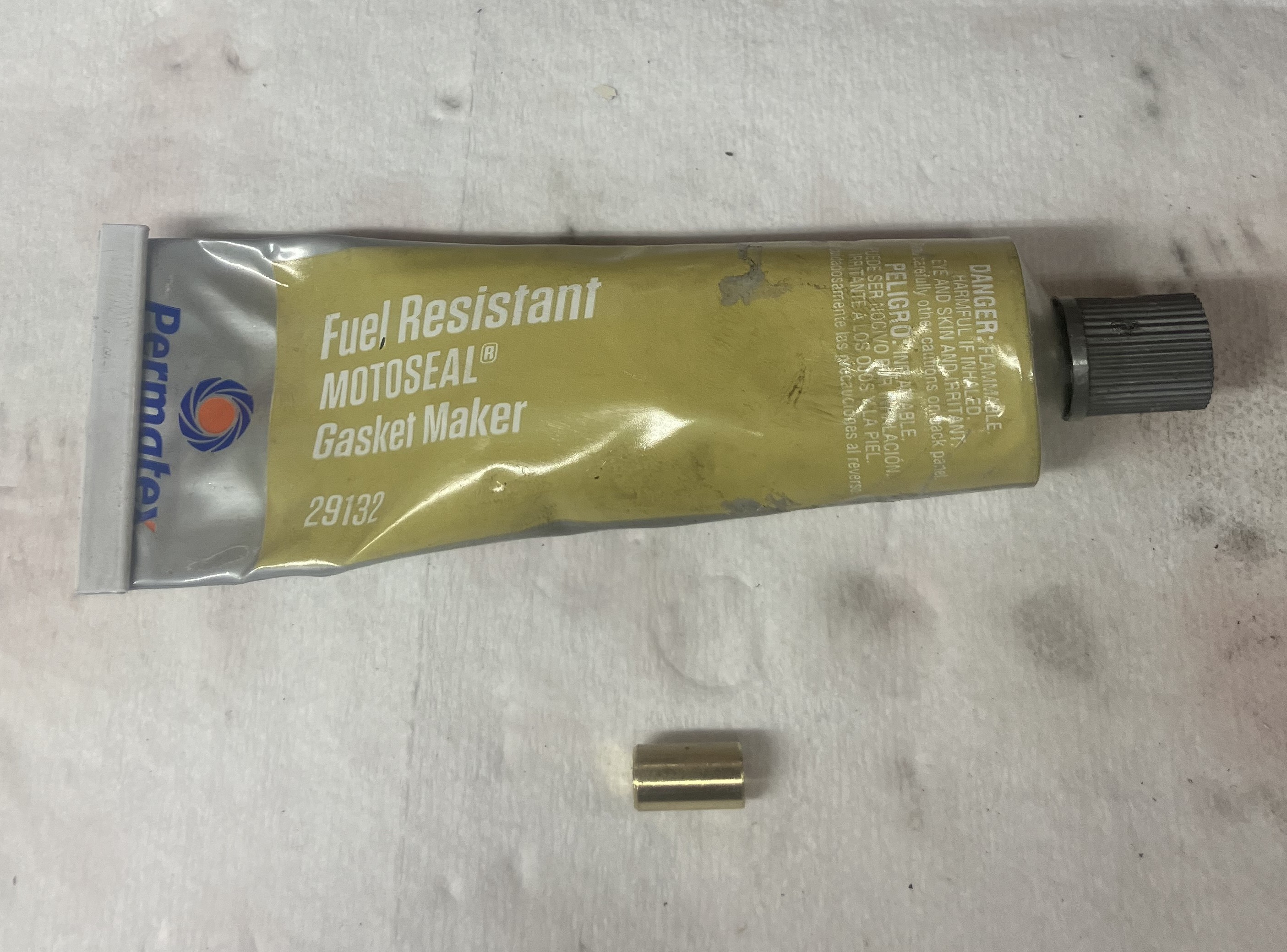

Used Permatex Motoseal to seal the crankcase.
Fiddled around for over a half hour trying to hold wristpin needles in place with grease, said to myself the factory has to have a better way. Turn a short piece of brass to the wristpin diameter and made it just short of needles and thrust washer stack, then assembled the needles and washers with grease with the brass in place, slide it into position and pushed the brass out with the wristpin. This reduced the assembly time to 3 minutes.
