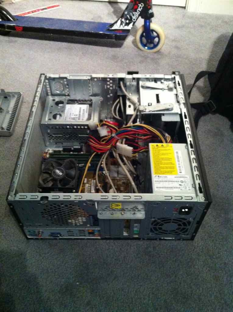

I would buy a icharger right now but I need a power supply. I don't want to buy one because I don't want this to go over 125$. I have a old computer (like around 2005) that is just junk now, can I use a power supply from that and if so what will I need to change on it for it to work with my charger.

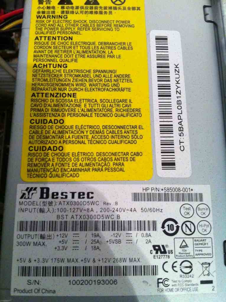

It's an HP, thats all I really know I can go pull out the power supply if that can tell you anything.
joshgluck
It will help because someone else has figured out what jumpers to short so will need the model number.

Well said. Also your ps is rated at 19amps and only 260w for 12v according to the face plate. Just don't want to see you spend a ton on a charger and be unable to use it. For my pl8 I have dual servers power supplies that we were throwing away at work. Know anyone who works in IT?
As for the one you have: You should pull it out and good the model number to see what wires you need to short to gnd to determine how to get the ps to send +12v. I you might not be able to charge as many packs in parallel as you want but it's free and will charge something at some rate of C.
