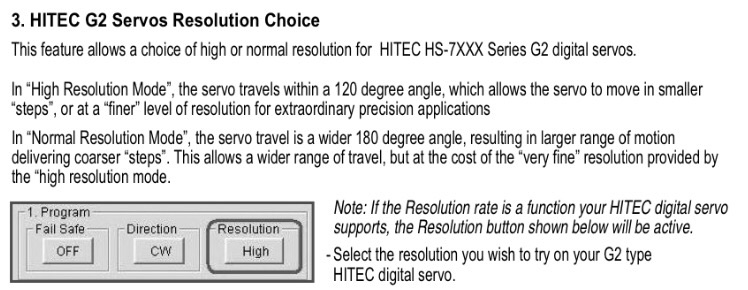

If I remember right they are programmed for high resolution (not sure that's the proper term) out of the box. On those servos it reduces the throw. If you set them for lower resolution the throw is normal? I'll have to go look up the actual terms...
camss69
I found it, it's "High Resolution" (default) or "Normal Resolution". High is 120* throw vs Normal is 180*. You need a programmer to change it from default High Resolution to "Normal".

120* of throw is standard for all Hitec digital servos. If you are not experiencing that amount of control throw then it may be an issue with your setup. If you program them to normal mode rather than high resolution mode you will see lots of jumping in the control movement due to it tuning the resolution back to analog servo status (512) in order to allow the servo to rotate a full 180*, rather than a smooth linear movement within the 120* degrees of motion. You can also ensure the servos are set properly to factory setting using the RESET function in the programmer. Please be advised that if you program from HIGH RES to NORMAL mode then you will need to set your EPA as the servo may want to rotate the full 180* (which likely will damage the servo and all that is attached to it) rather than the 120* factory.
What transmitter are you using? Certain brands do not use long enough PWM frequencies so you may see reduced control throw with high resolution servos. Also do your control horns allow you to move the linkage inward toward the control surface? This would be a more ideal method to get longer control throw out of the surface rather than reprogramming for lower resolution.
