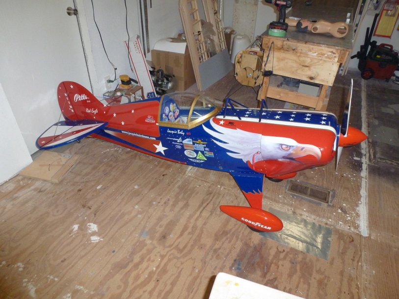

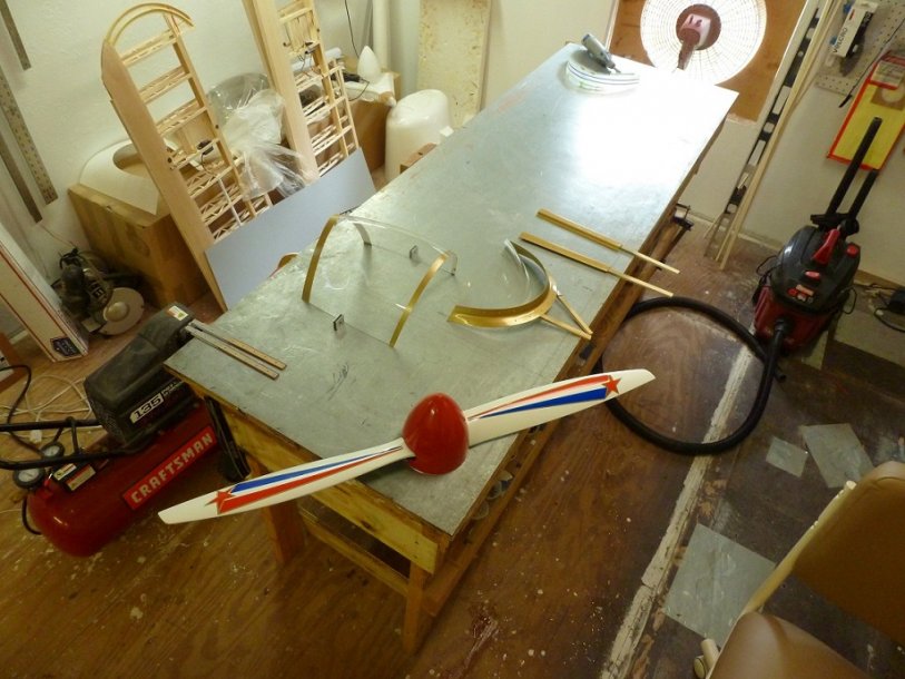

Here is the Plexi canopy and windscreen I pulled. Turned out great, especially after I bought the special drill bits. But it is brittle in a manner, had one corner crack during assembly, so I don't think it will last long.
