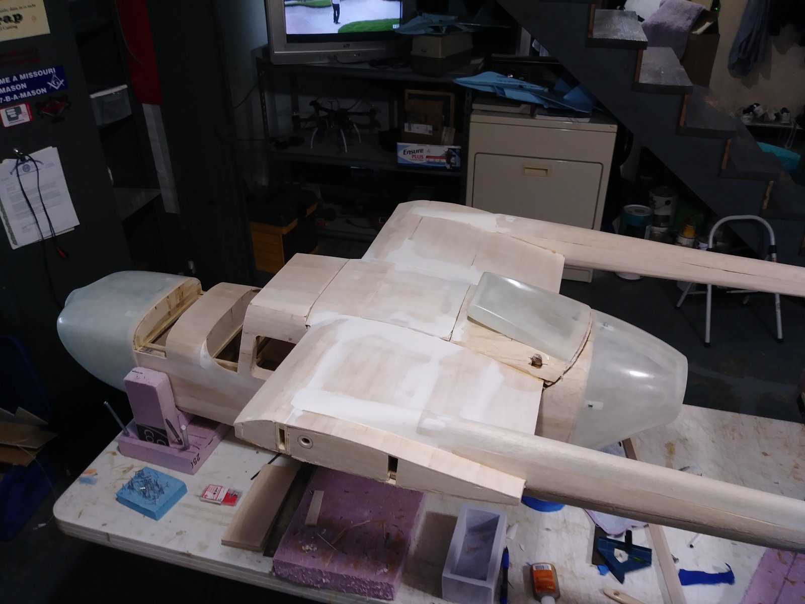

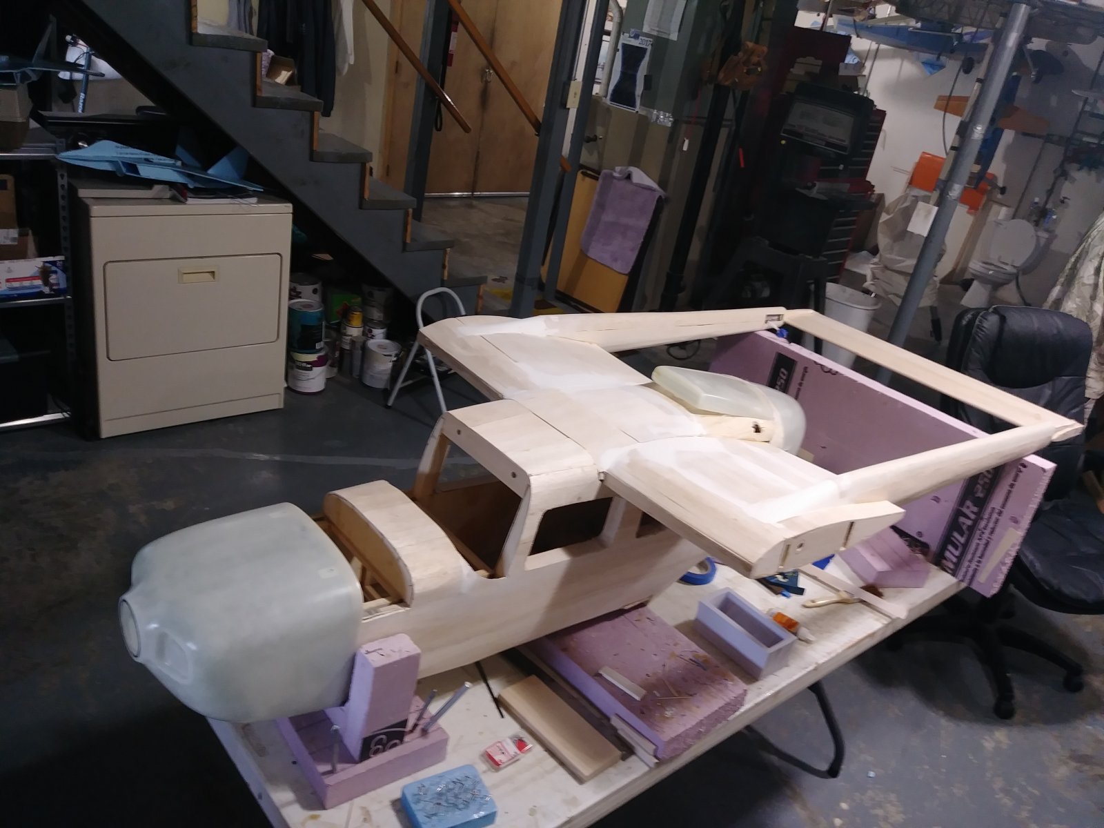

Looking good, I'm getting closer on mine my next purchase will be the gear so I can get the rest of the bottom finished
Looking great!!! I really like seeing other people building the same plane!!!
I got the gear from Abel Hobby, I think. It's pretty good, but not perfect. You could probably make your own out of aluminum if you have the know-how/skill to do so. I do not, so I'm okay paying for it.
