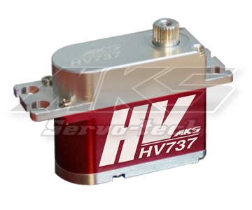

    70F8EF9C-BEF8-4879-8C25-5A31D74DA4AF.jpeg I have used only one of these servos and it is solid and one powerful servo but they are around 100 dollars.

    I like the SV-1260MG a little better than the MKS HV737, plus it's $25 cheaper. I have 1260's in the tail of a 60" slick, and 737's in the wings, I cannot notice a difference between the two in performance personally. But I'll keep buying the 1260's instead. I'm running 8V.
