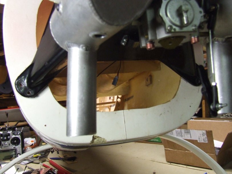

In your above post, next to last pic..... Close off that open area, in the corners where the top of the cylinders are (both sides). You want air to pass thru the cylinder fins. Air is very much like electricity. Takes the path of least resistance.
