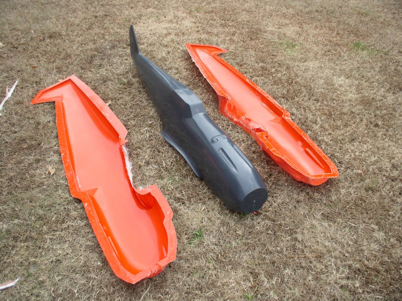

Larry, I would love to see more photos and hear the details of your models, especially the 109E.
Larry B

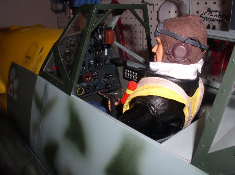

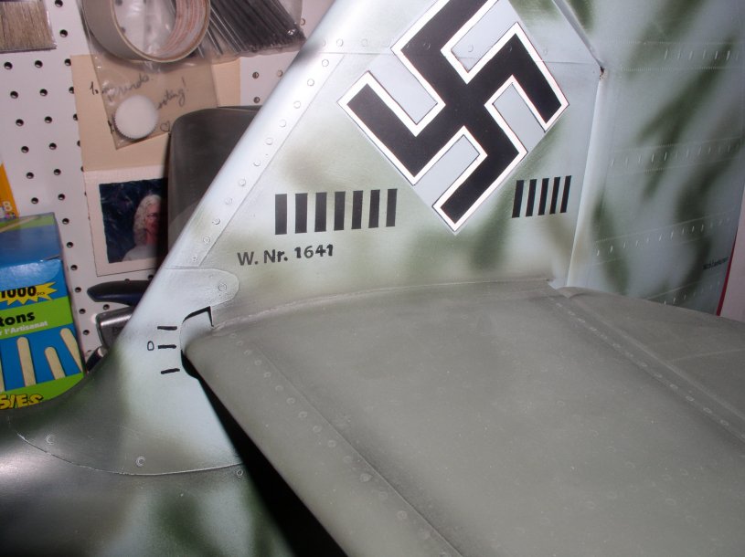

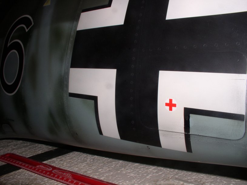

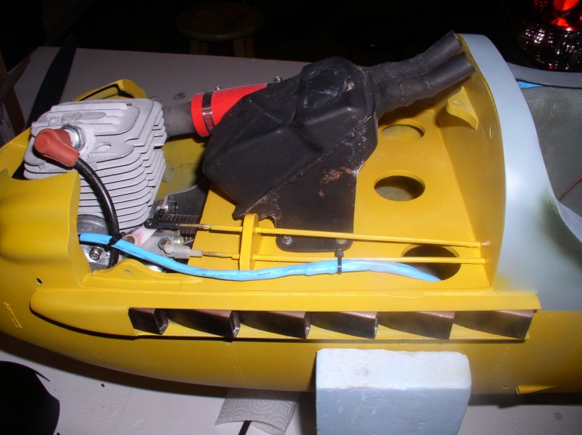

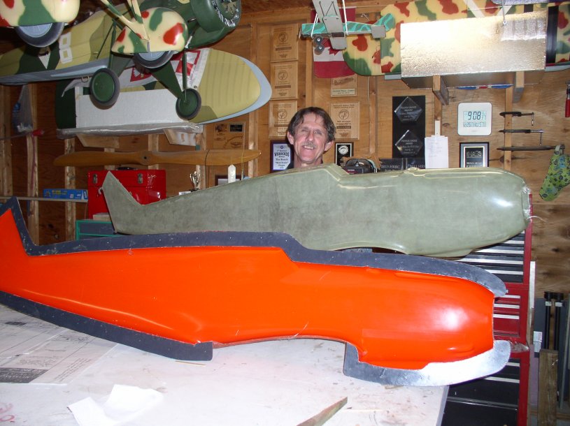

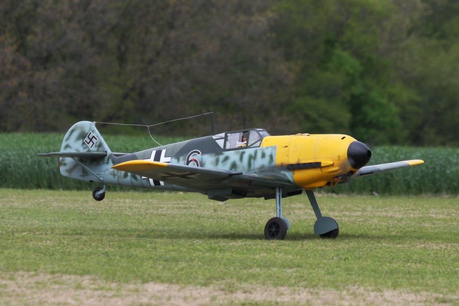

Here are some photo's of the project, I wanted to build a 109E-4 in 1/4 scale because there are no kits available, I started with a good 3-view and scaled it up to 1/4 scale. I then made a plug, molds, & finally the layed up a glass fuse. The wing and tail are foam cores sheeted in 1/8" balsa then glassed with Ziroli cloth. All the finish is Klass Kote epoxy. I went with the good old G62 for power and reliability. So far I have sold two kits of the thing but making kits really cuts into my building time for my new project.
See if this YouTube link will work, it was filmed up in PA during a Warbird fun-fly.
