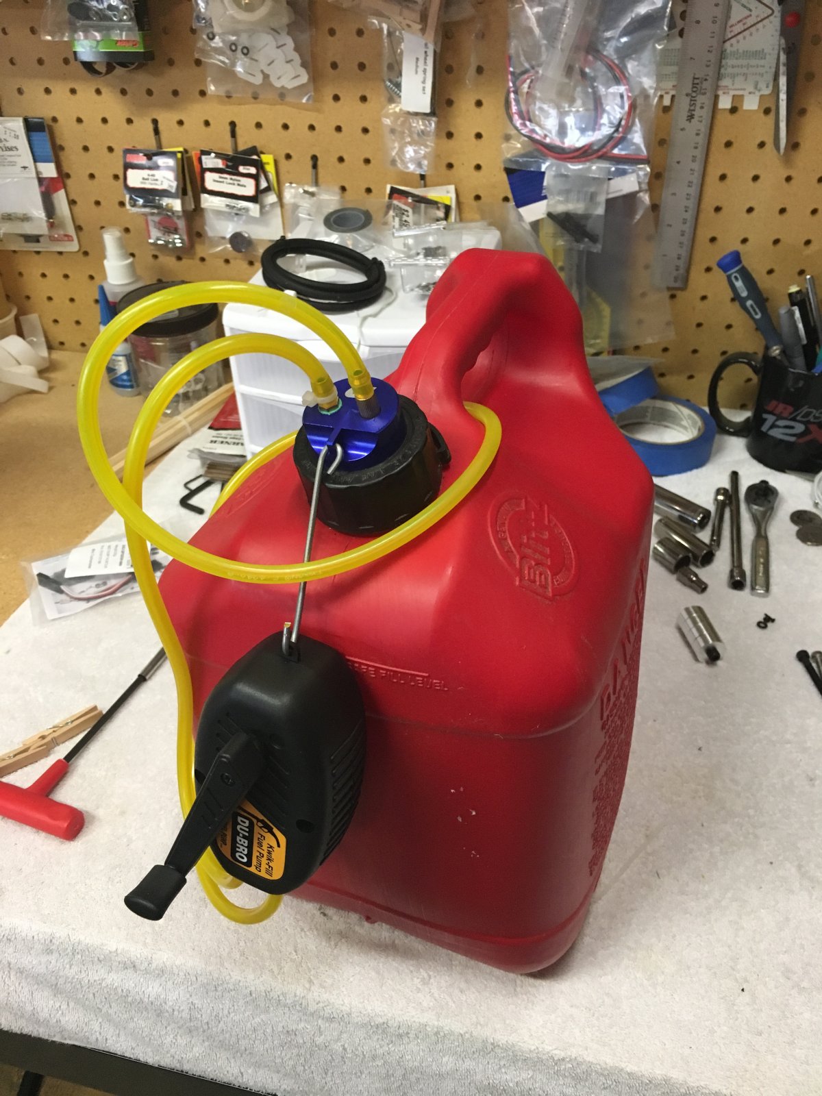

Got the gas can together for the Corsair since it's a different mix for the Saito. Stumbled across this Evolution brand gas cap, this thing is a deal! Comes with the fittings a felt clunk and a meter of what looks like viton fuel tubing all for $20.99. I had the hand pump sitting around and used tygon instead of the supplied Viton, I'll save that for something else, a nice cheap little setup. For how much I'll use it, it's perfect. Made the pump hangar out of an old pushrod.

HRRC Flyer
Hey @camss69
I like that gas can cap and stuff from Evolution. I need to get myself a rig like that for my Saito too. Thank's for the tip. . . :way_to_go:
Now hurry up and get that video posted of your 90 running. . . . :laughing:
David

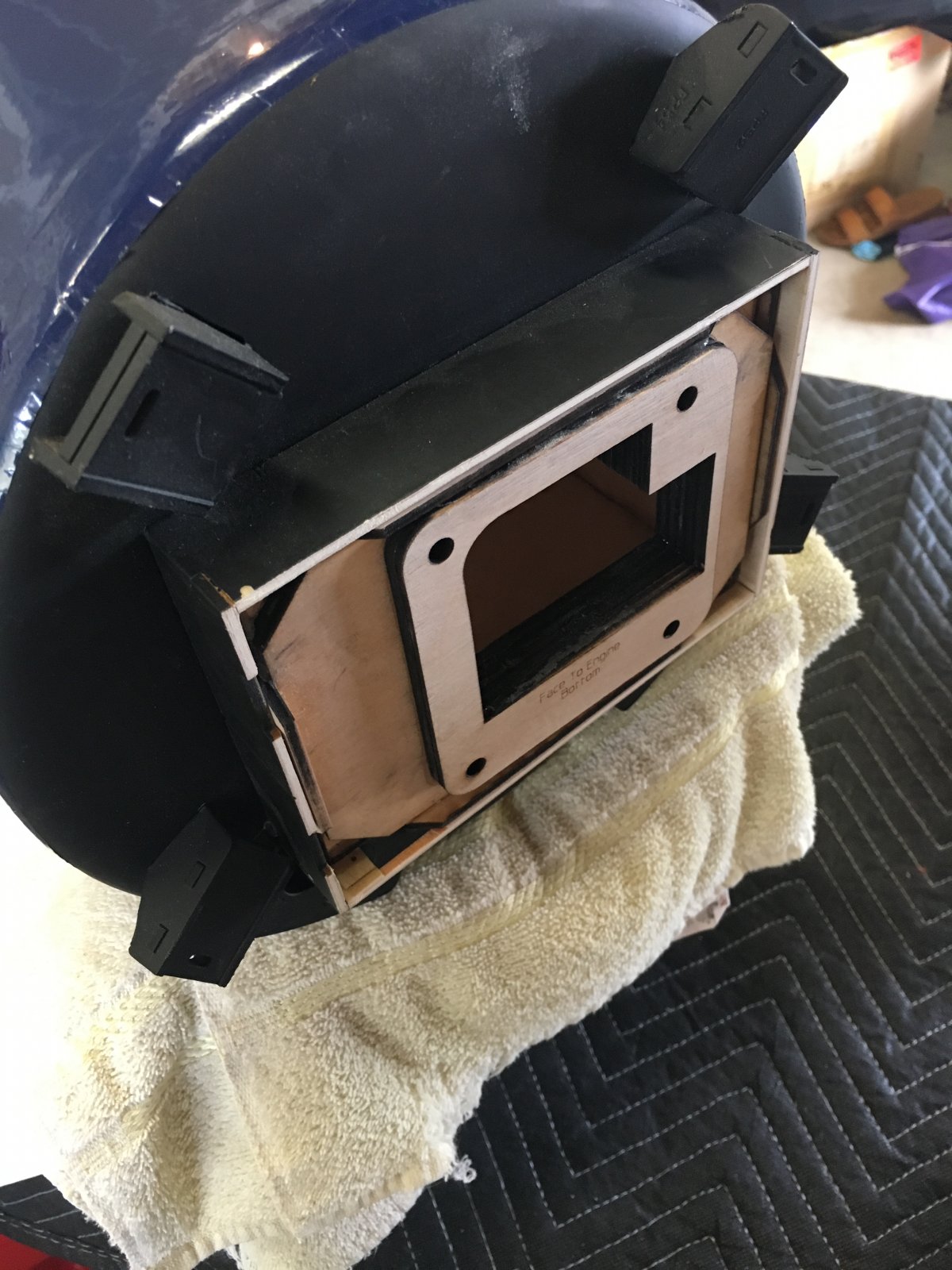

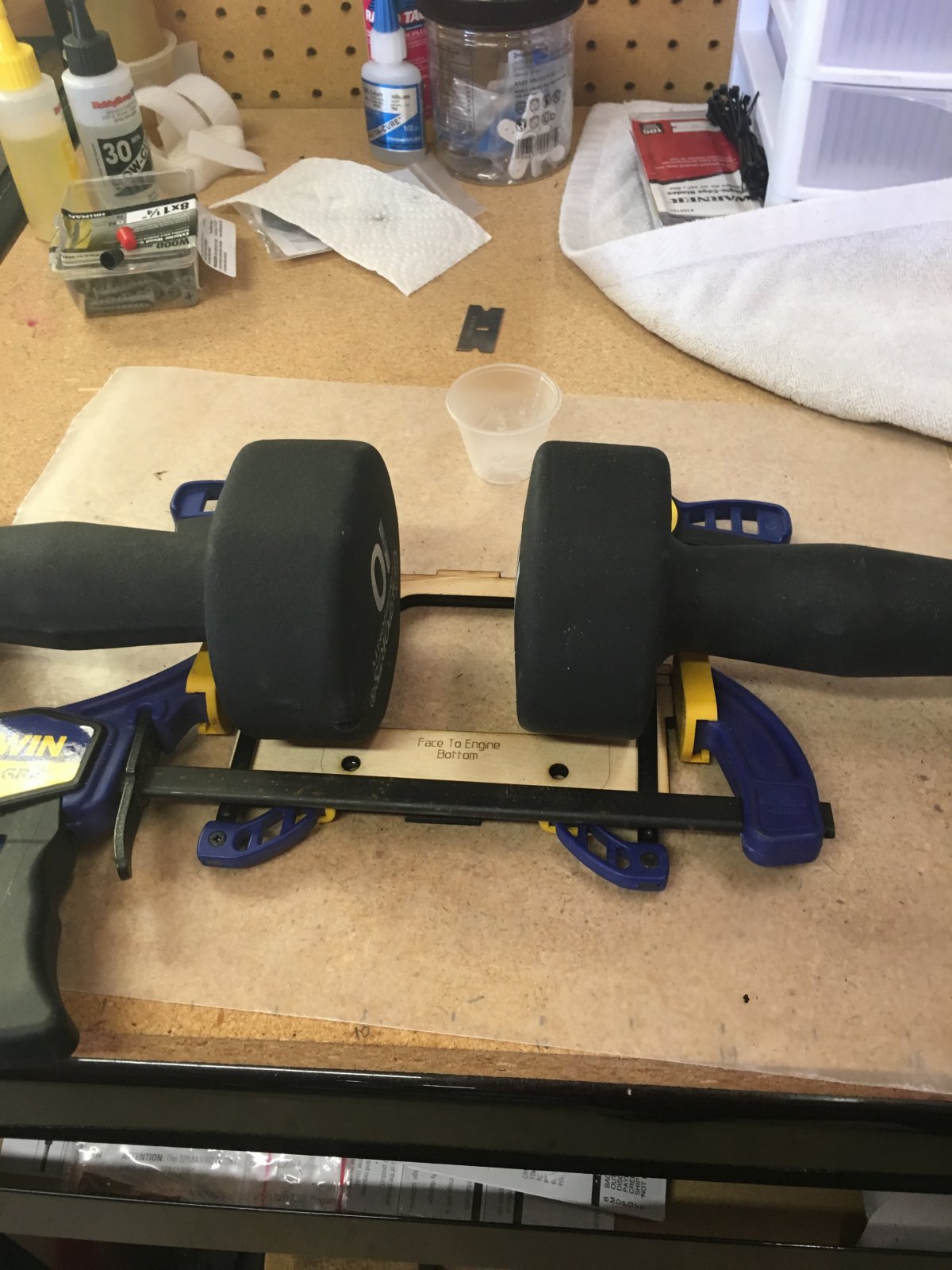

Well, as much as I wanted to hear the engine run this weekend it didn't happen. Saturday I was out of town all day for my daughters lacrosse. So yesterday I spent the day building a new motorbox. I had a problem with the first one, it came out warped. Long story short I ended up ordering another one and spent the majority of the day putting it together. This time instead of using the clamps to hold the pieces together I weighted them down on a flat surface and everything came out perfectly square this time. After a fair amount of sanding it fits as it should. Hope to get it epoxied in this week so next week I can run the engine. I only want to put the exhaust ring on once and I can't fit the engine box with the exhaust ring on.

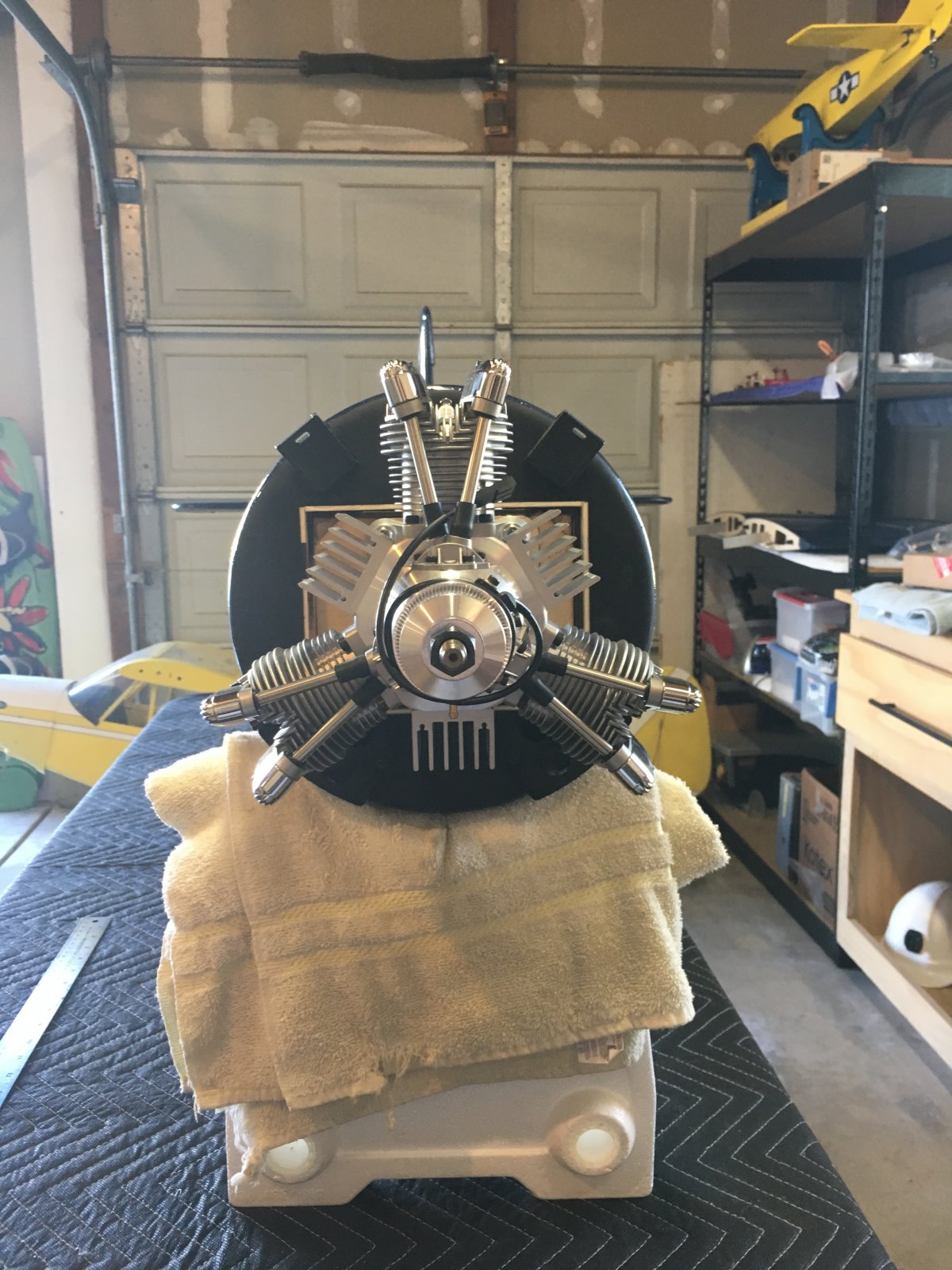

camss69

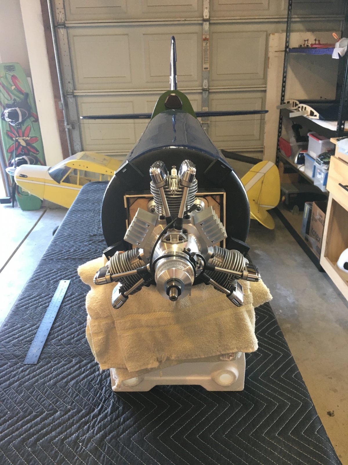

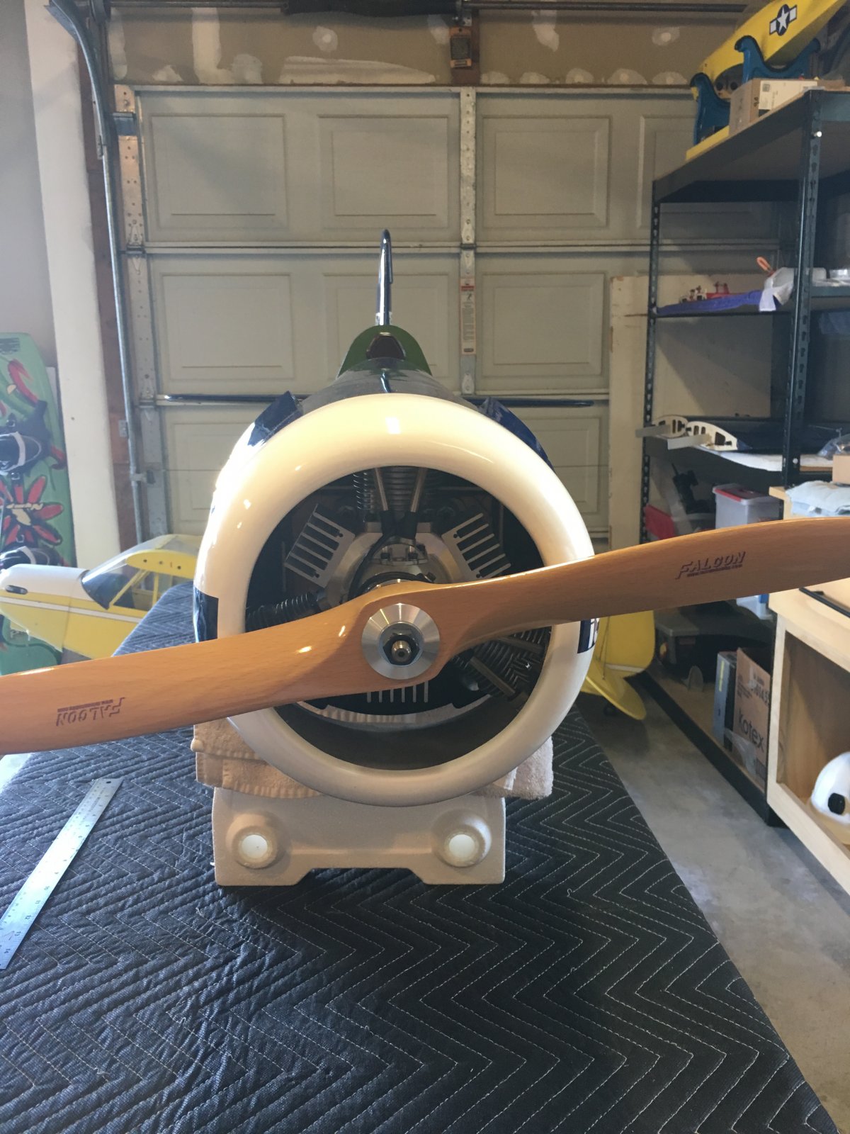

Got the motor on the plane today, only temporarily to figure out where to set the motorbox. Sure looked good on there though! It's a REALLY tight fit with the cowl.. I may have to cut some holes to clear the rocker covers.. I'm not sure yet. It's so close there was some excess epoxy on the inside of the cowl by one of the rockers, I had to sand it down to get every bit of clearance possible. I think I'm going to run dual 12oz tanks, there's not enough room for anything bigger. Then jam the throttle servo on the right of the tanks..

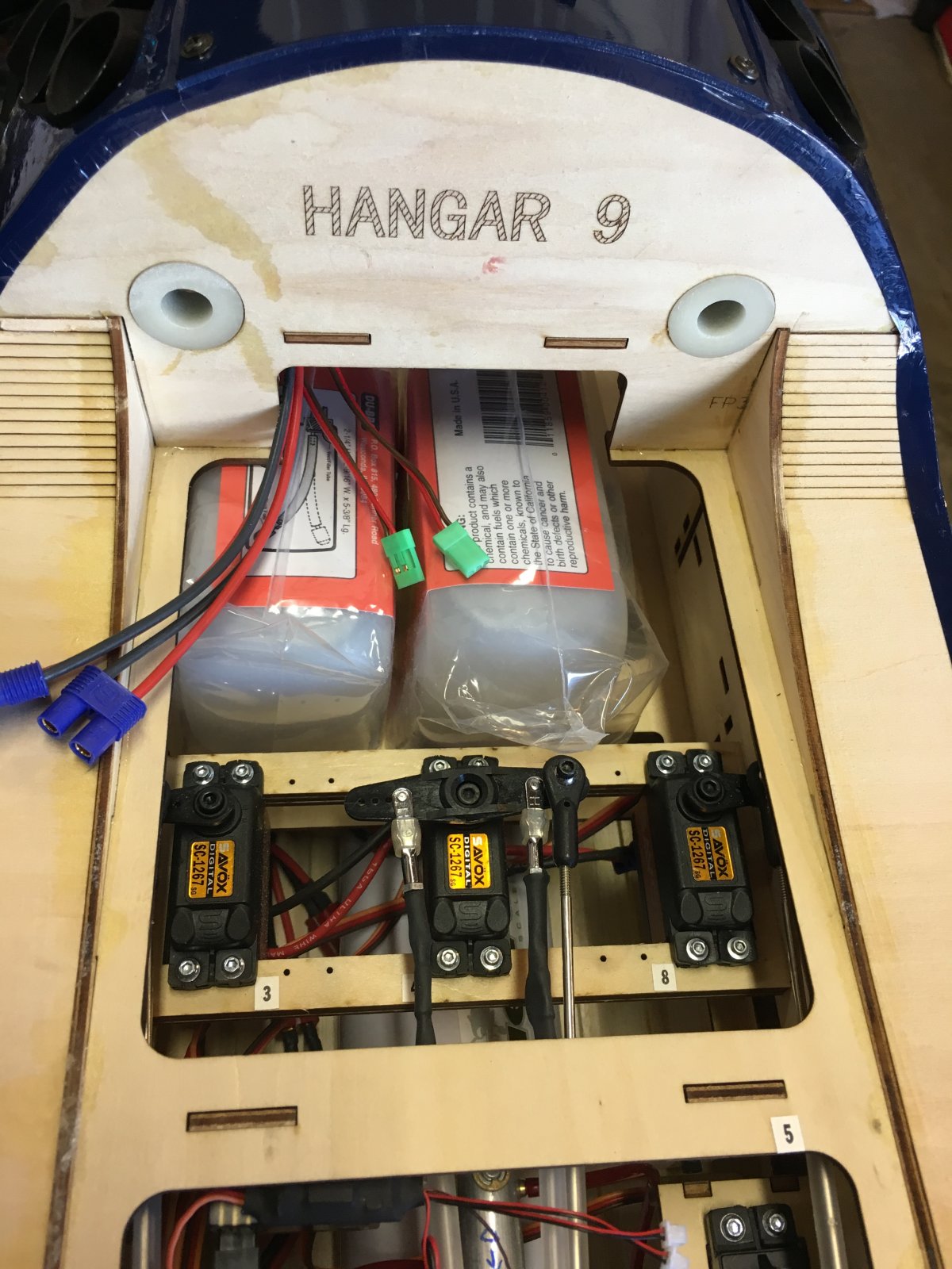

HRRC Flyer
WOW @camss69,
That Saito looks AWESOME bolted on the firewall of your Corsair. . . . . . . . :yesss:. I was curious if the Saito was going to fit in your cowl. A friend of mine put a Saito 450 radial in his kit built Top Flite Corsair and he had to shave a little off the top of each valve cover for clearance. Hopefully you can get the big Saito to fit without modifications. If not, maybe you can find some old Saito 150 valve covers and do the same thing. I'm guessing they are the same.
I see you are using Savox servos in your plane. I was thinking of trying some in one of my planes. How do you like them? The only negative comment I have seen about them is that they are a little noisy.
Keep up the great work . . . :way_to_go:
