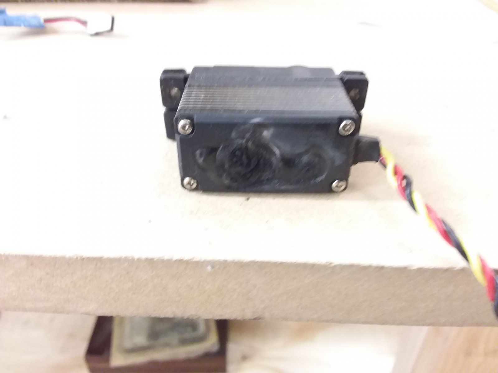

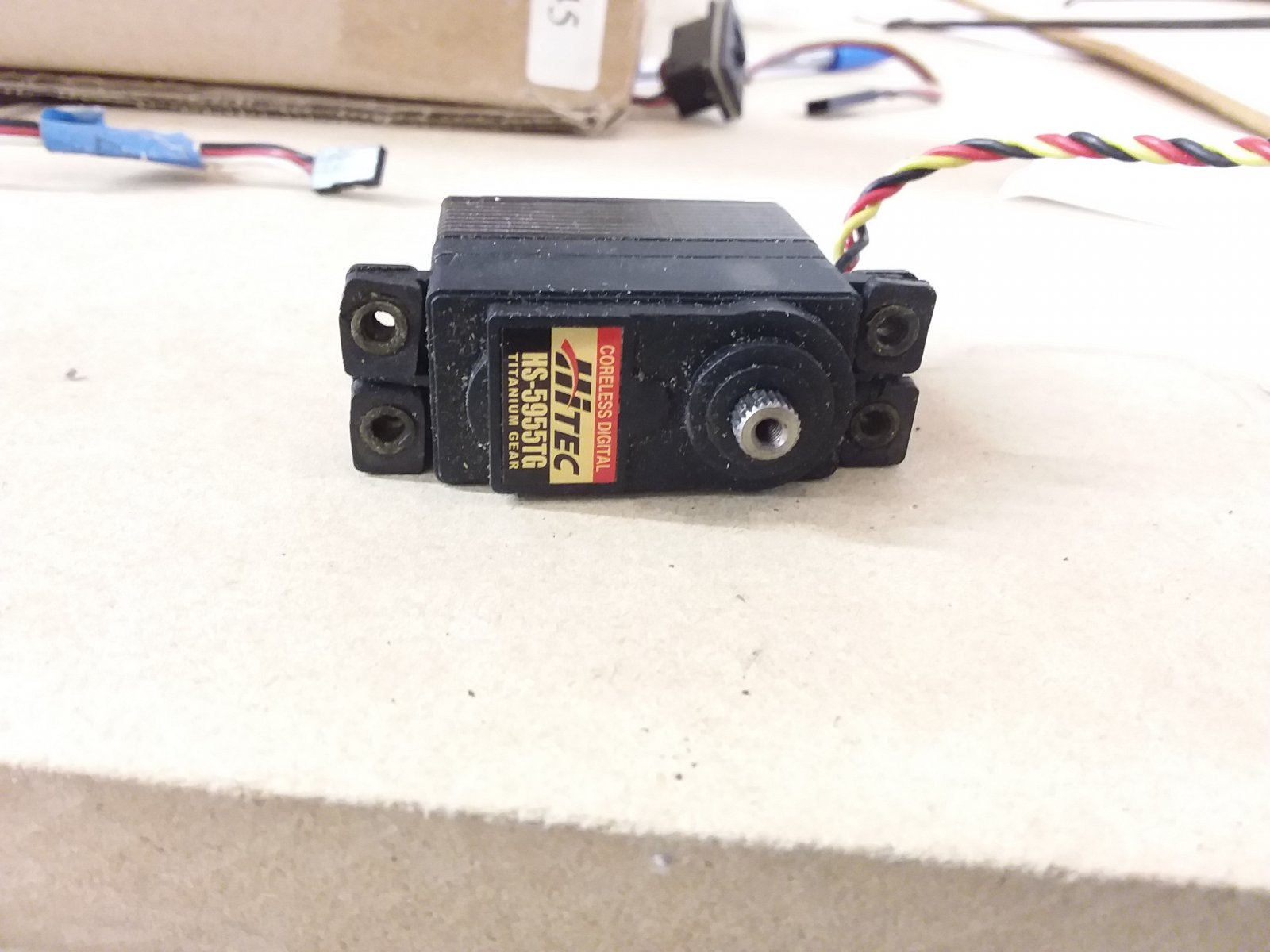

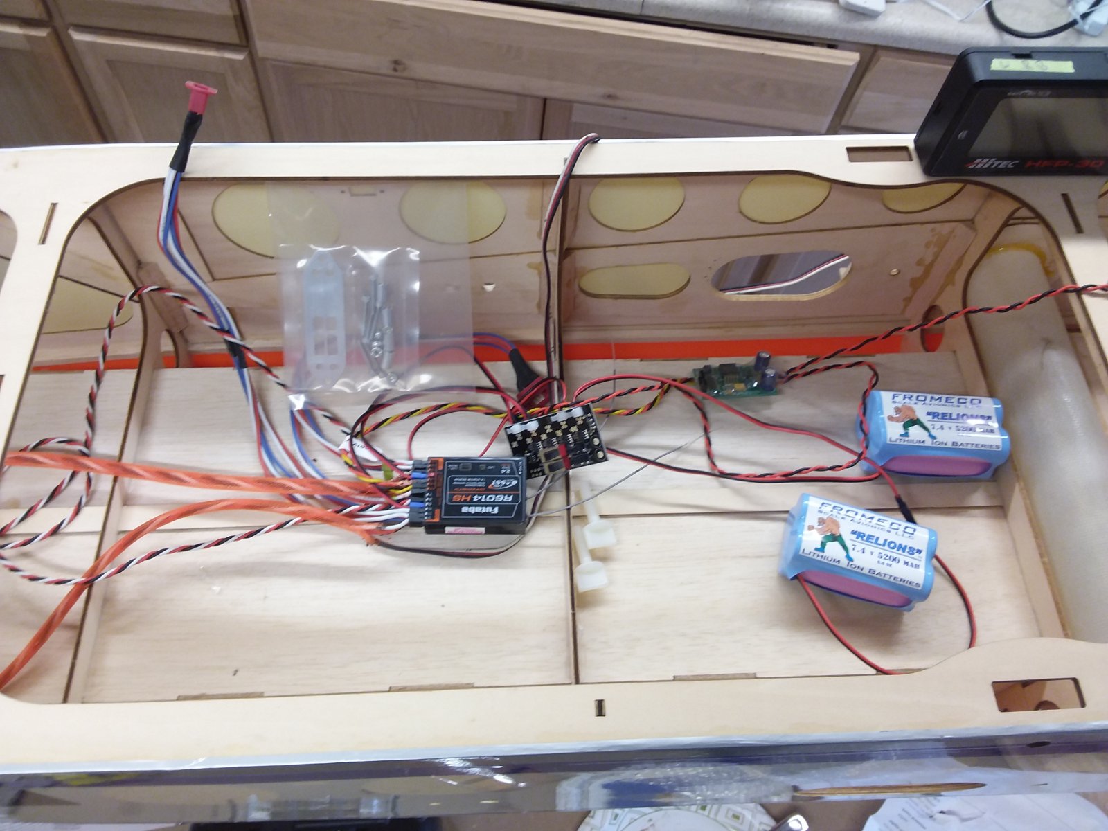

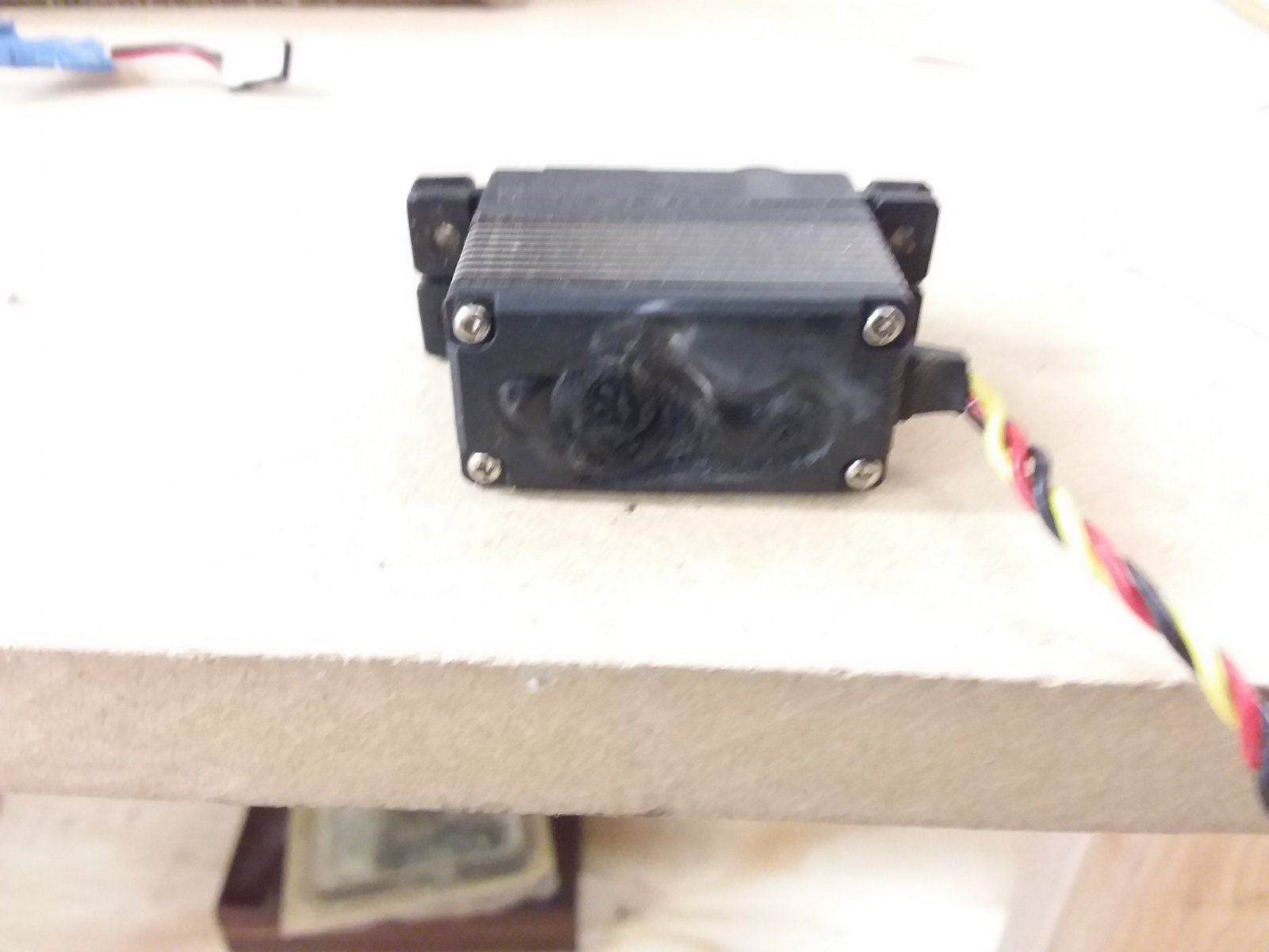

A few wires and controls going in.
Forgot that an old servo installed just to operate the throttle wasn't high voltage. I think this one is a goner.
