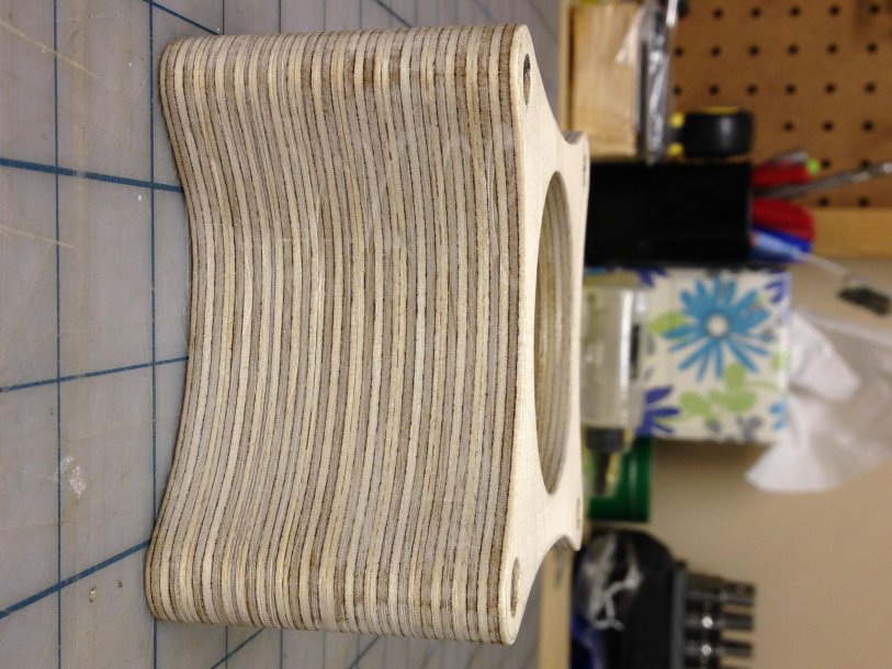

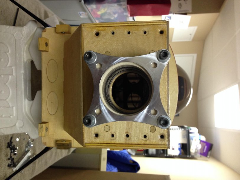

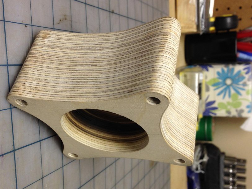

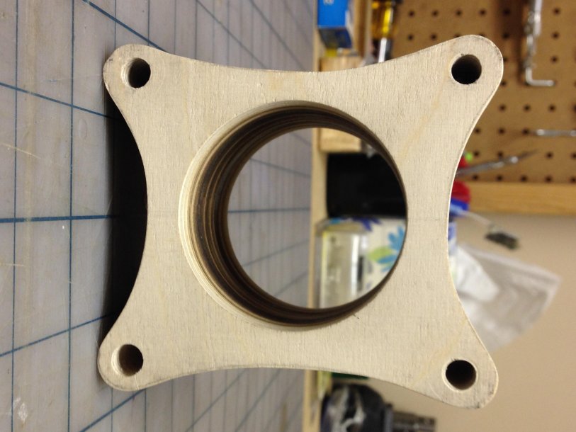

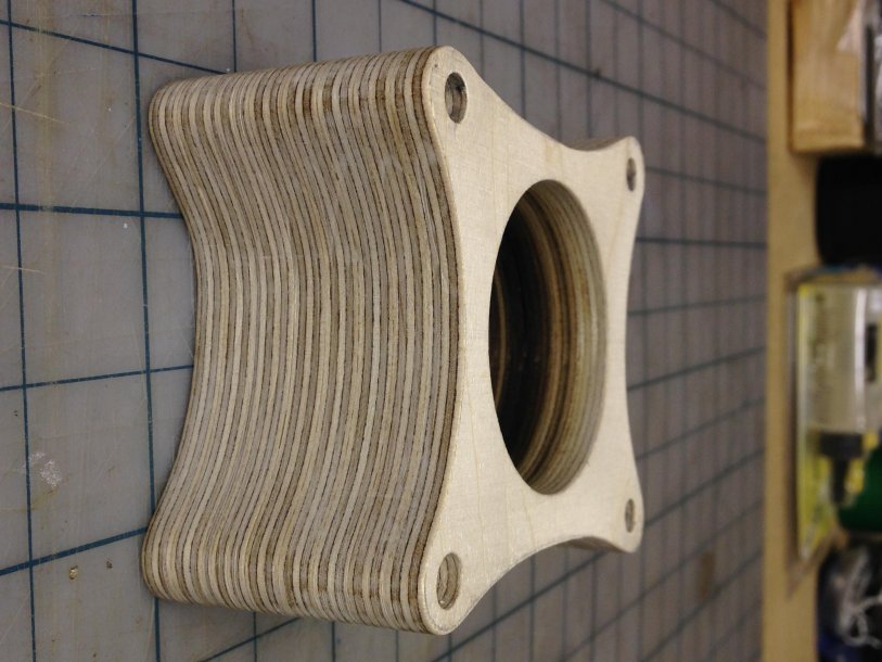

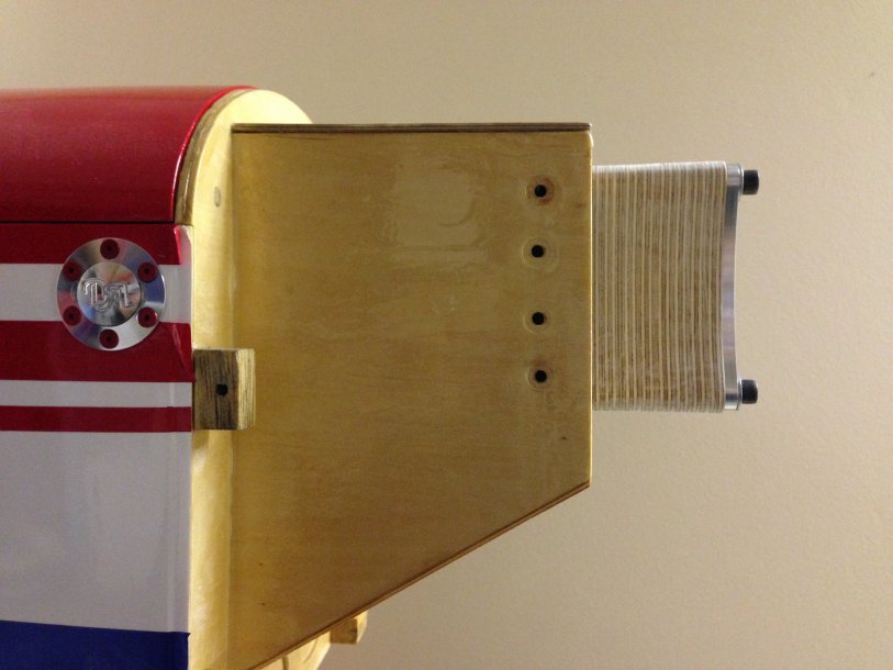

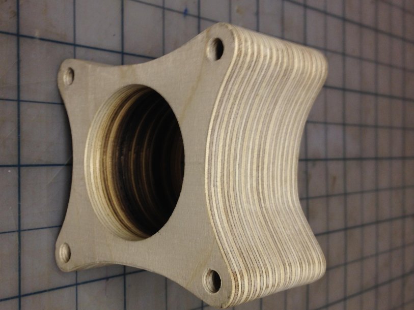

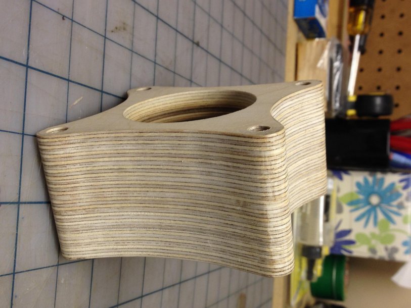

Thanks for the help guys. If at first or second you don't succeed, try again. Take a look, I think I got it. I was able to shave 3.18oz, the mount now weighs 4.88 oz. This is 1.98oz more than the aluminum stand-offs. Not bad I think, I was shooting for about ~2 oz of weight to balance the plane. The mount now weighs less than the spinner... :)
btw- sorry about the orientation of the images, I thought I posted them right side up. Some are rotated 90 degrees.
thanks Jaybird, do you coat the mount in thinned epoxy or use some other sealant? I used thinned epoxy, but its a balance, too much alcohol makes it rubbery and it crumbles. Too little and it's thick and heavy.
Terryscustom
50:50 max or slightly less works well and is still sandable. No matter what when you thin the resin it has no structural effect anyway so it becomes just a sealant.
