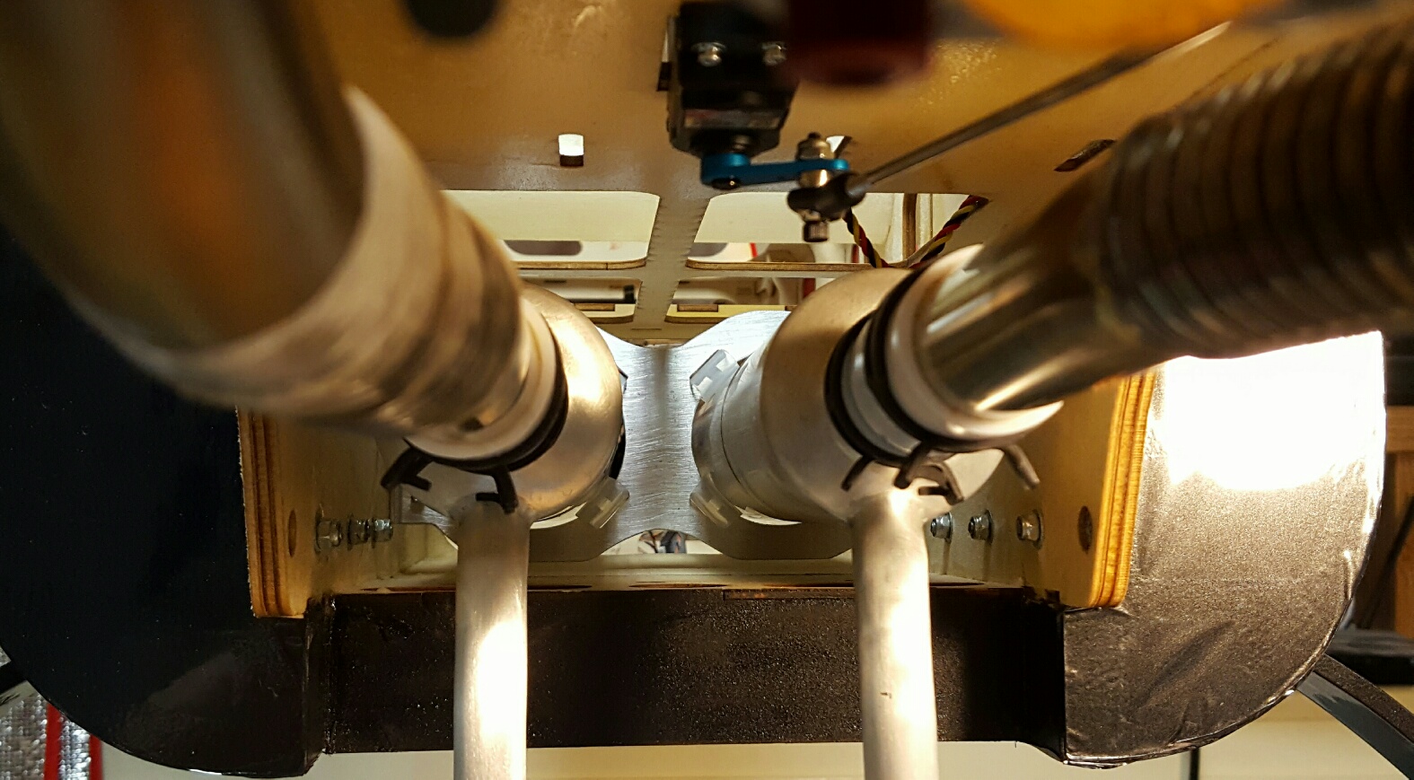

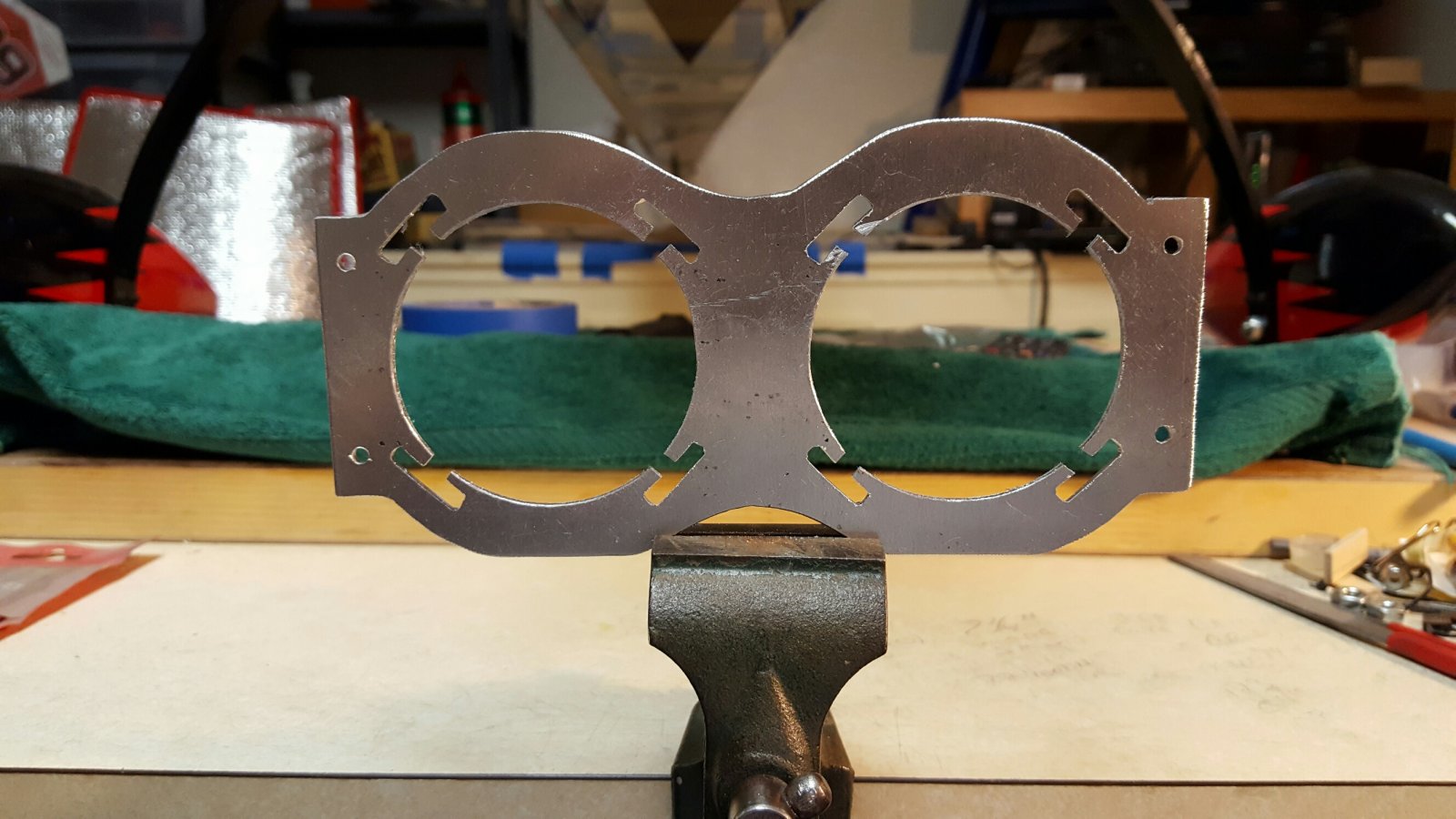

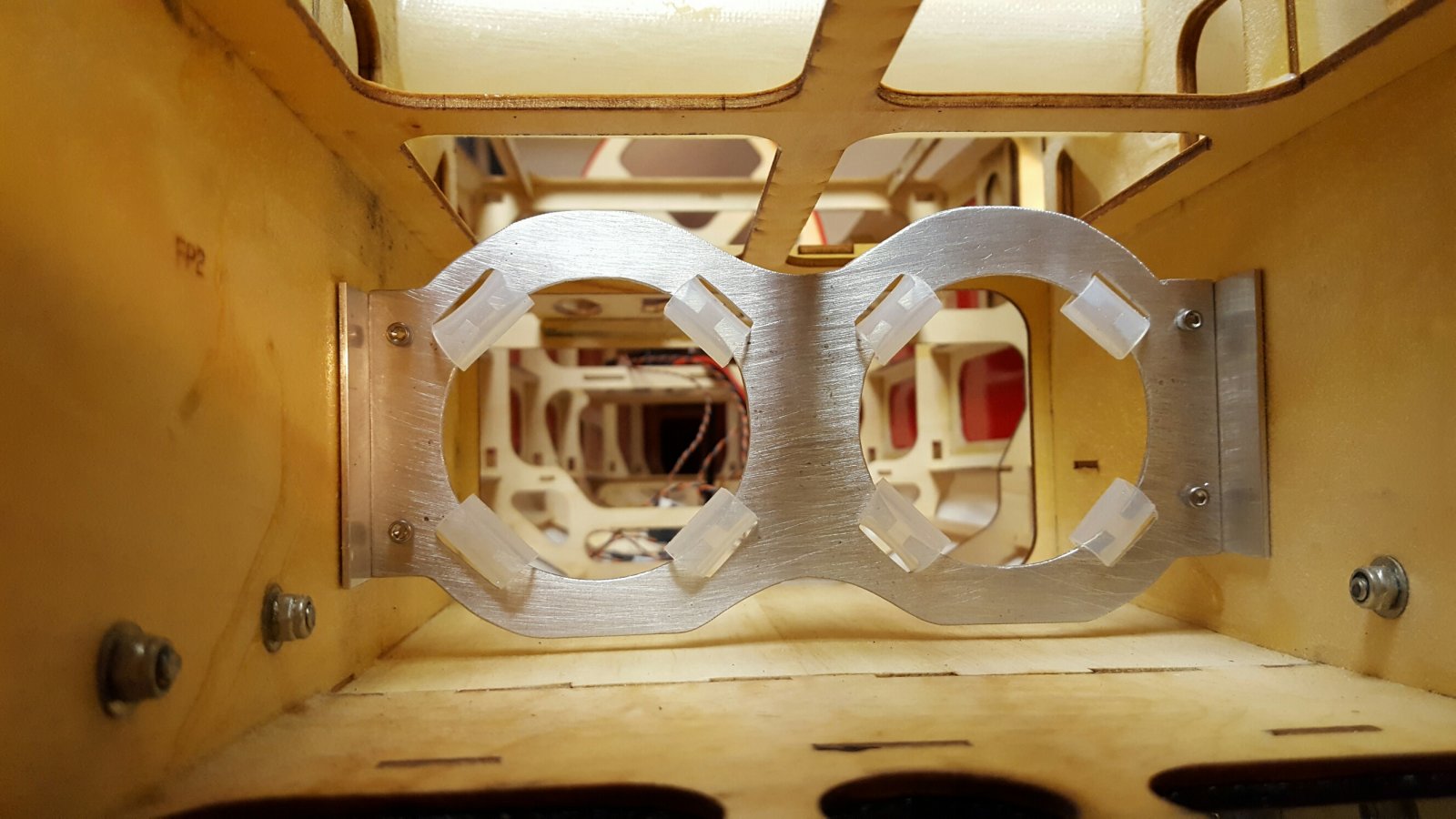

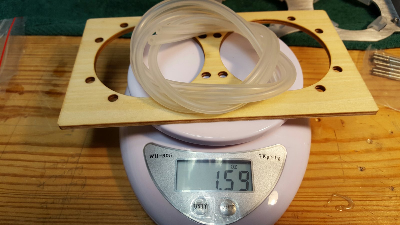

I've been working on my homemade canister mount. It's looking pretty good I think. It doesn't weigh much more than the stock one.
I thought an aluminum one since it can be smaller would have better air flow around it. The stock wooden one blocks off quite a bit of the tunnel.

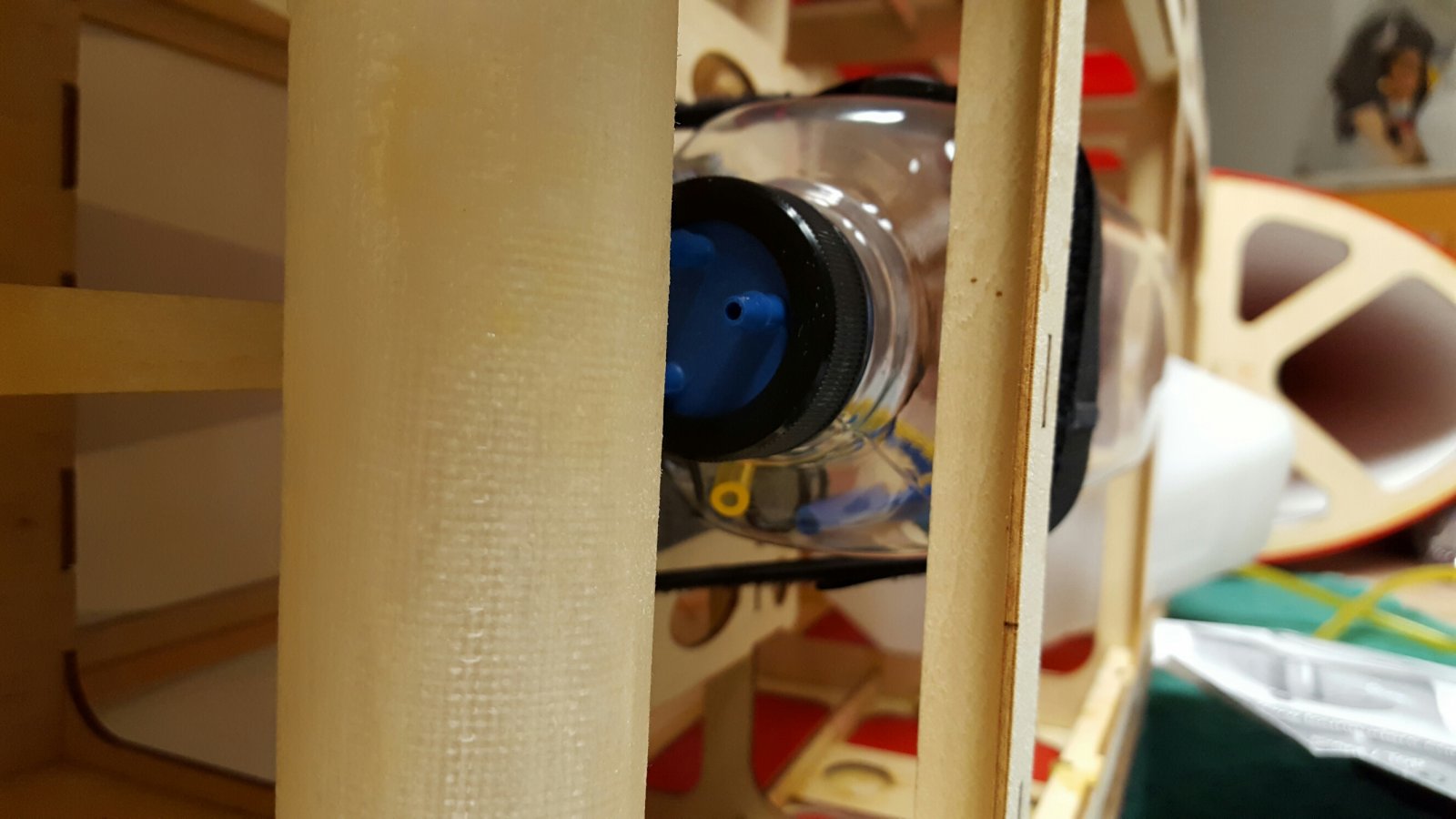

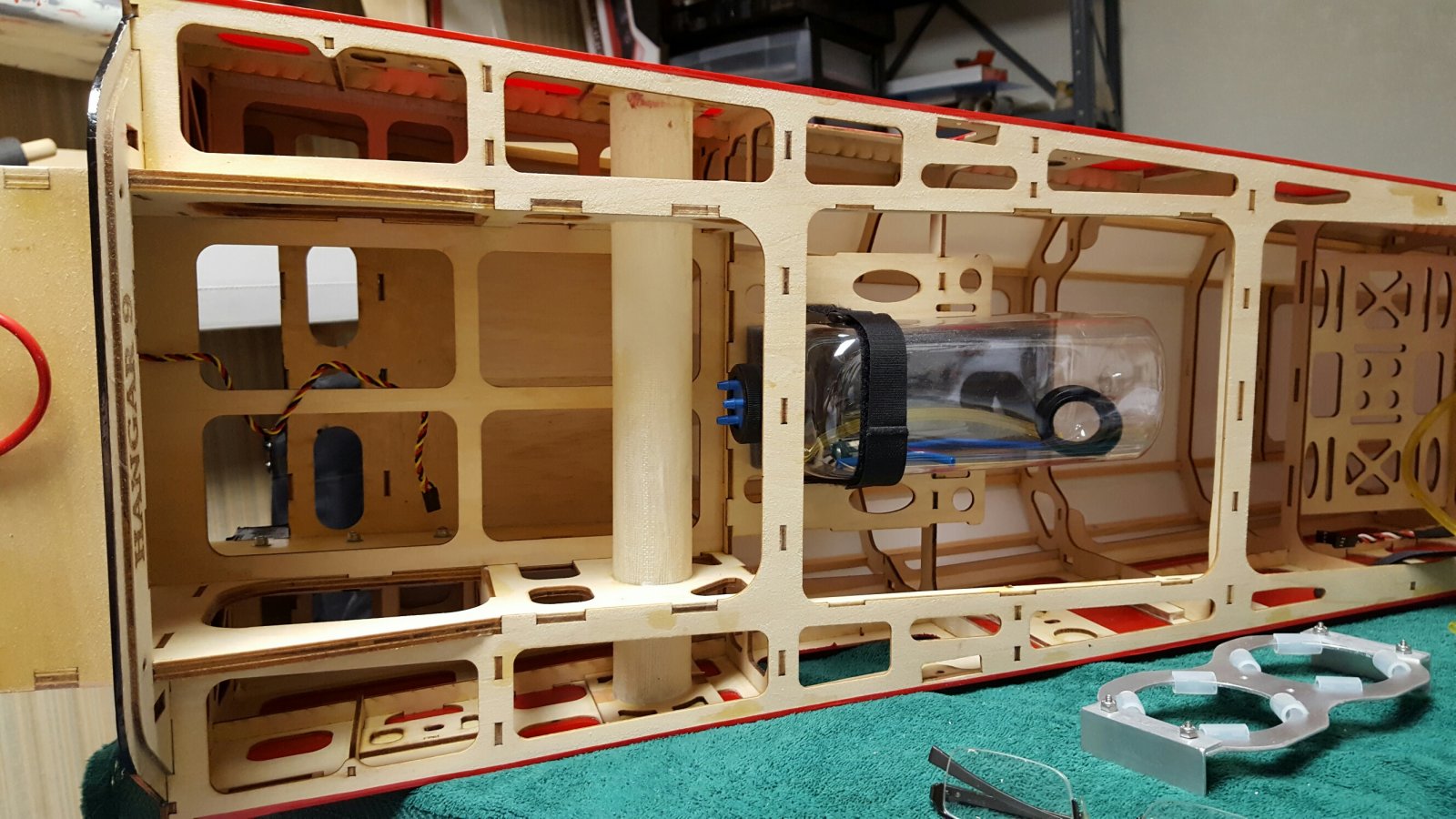

I was checking out the fuel tank tonight. They mount this one behind the wing tube which is kind of odd, but from everything I've read they work fine there. My problem, is the stock tanks outlets are set really high in the tank, and mine come out in the center so the wing tube is in the way.
I could use PSP fittings and make one which raises the vent and fill line, but the clunk line still comes out in the center. I could move the tank in front of the tube, which I've seen other people do. I'll need to give it some thought.
