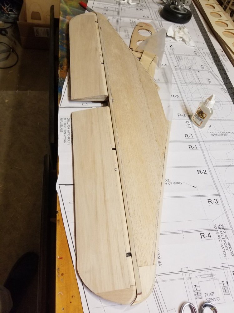

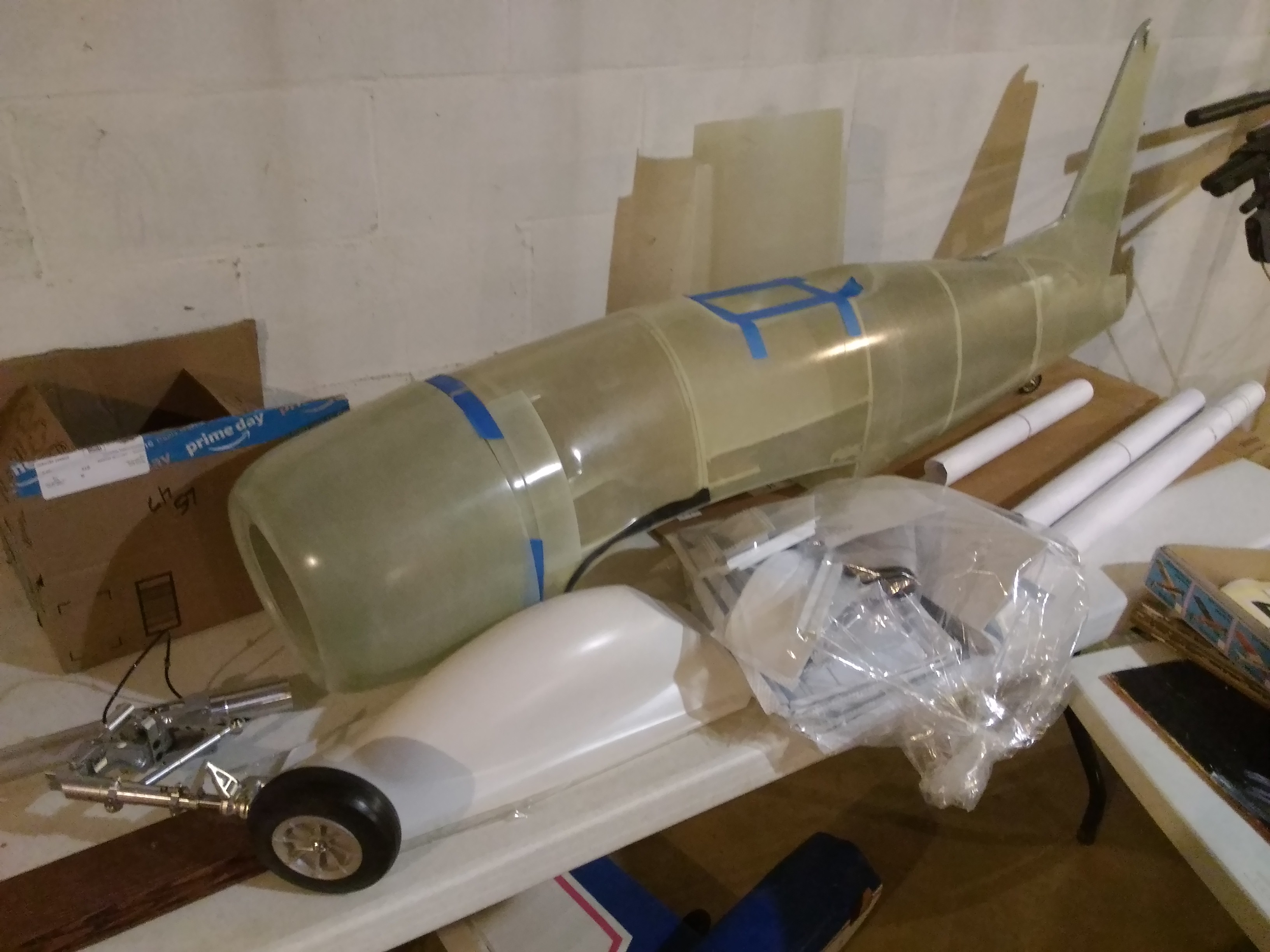

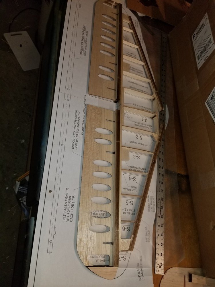

  1. I picked up a Vics rc fiberglass fuselage with Sierra retracts this past summer. Got the laser cut kit for the winter build. I did finally start the build with the horizontal stab and elevators so I thought I'd start to share a little progress.

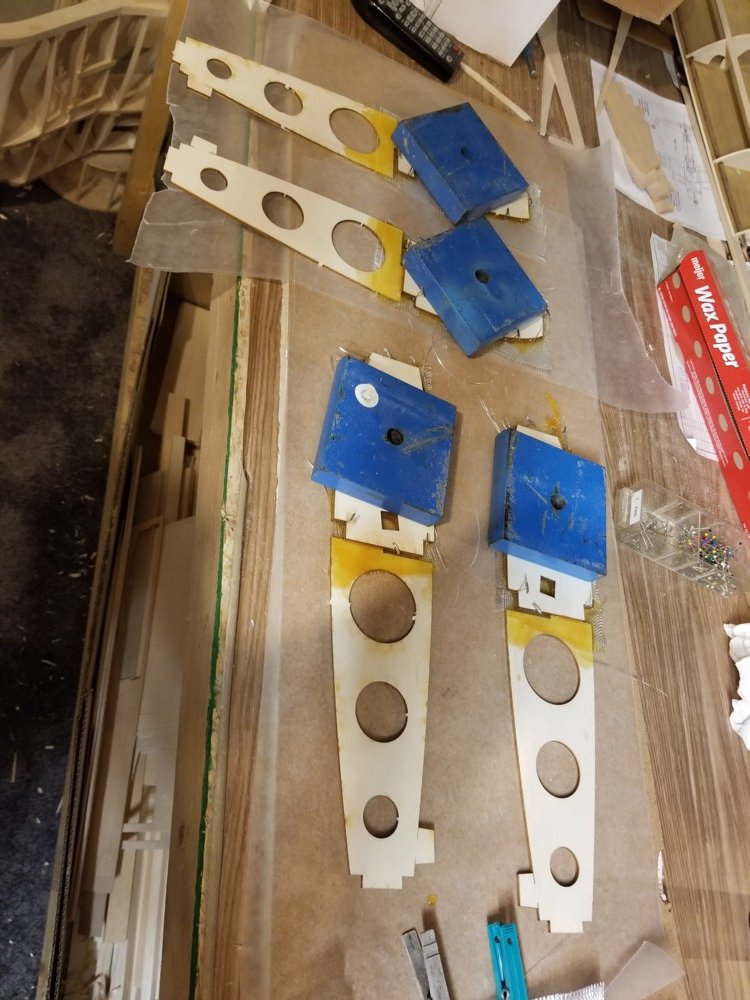

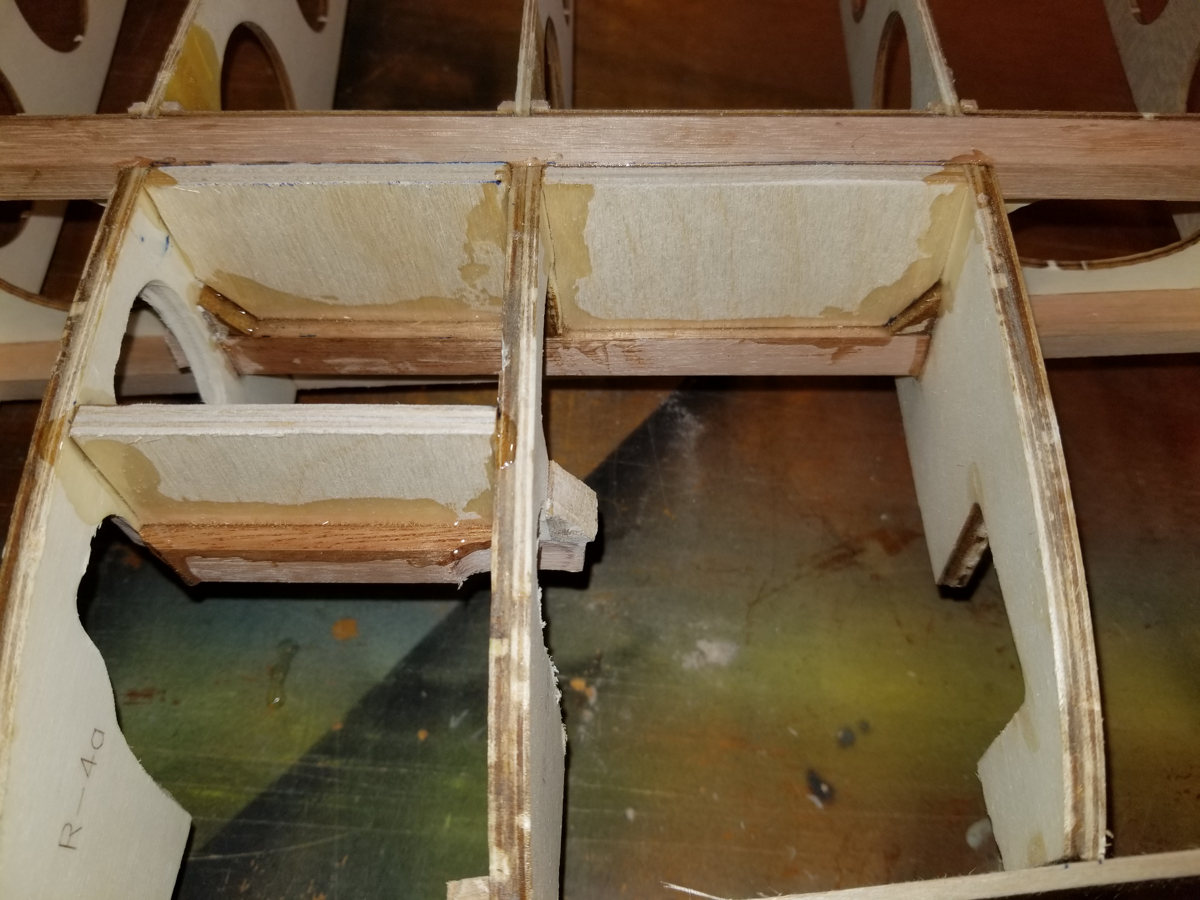

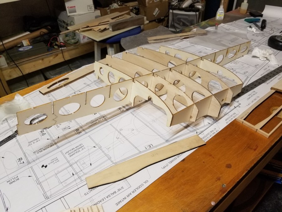

  2. Moving onto the wing, with having the Sierra gear, the wing ribs need alot of material removal to make them fit so I decided to laminate fiberglass between the plywood rib reinforcement.

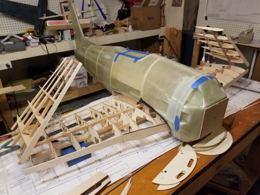

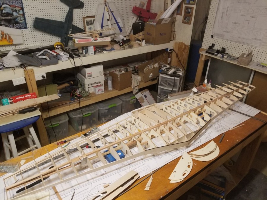

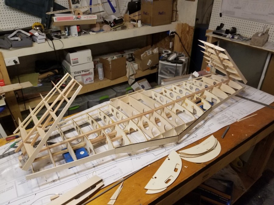

  3. Now onto the challenge. "FOLDING WINGS" Wasn't really sure how to approach this one but I think that I'm on the right track with it. I've made the hinge line and got the tips folding but I still need to figure out the mechanics of it. I also had to put it somewhat together just to tease myself

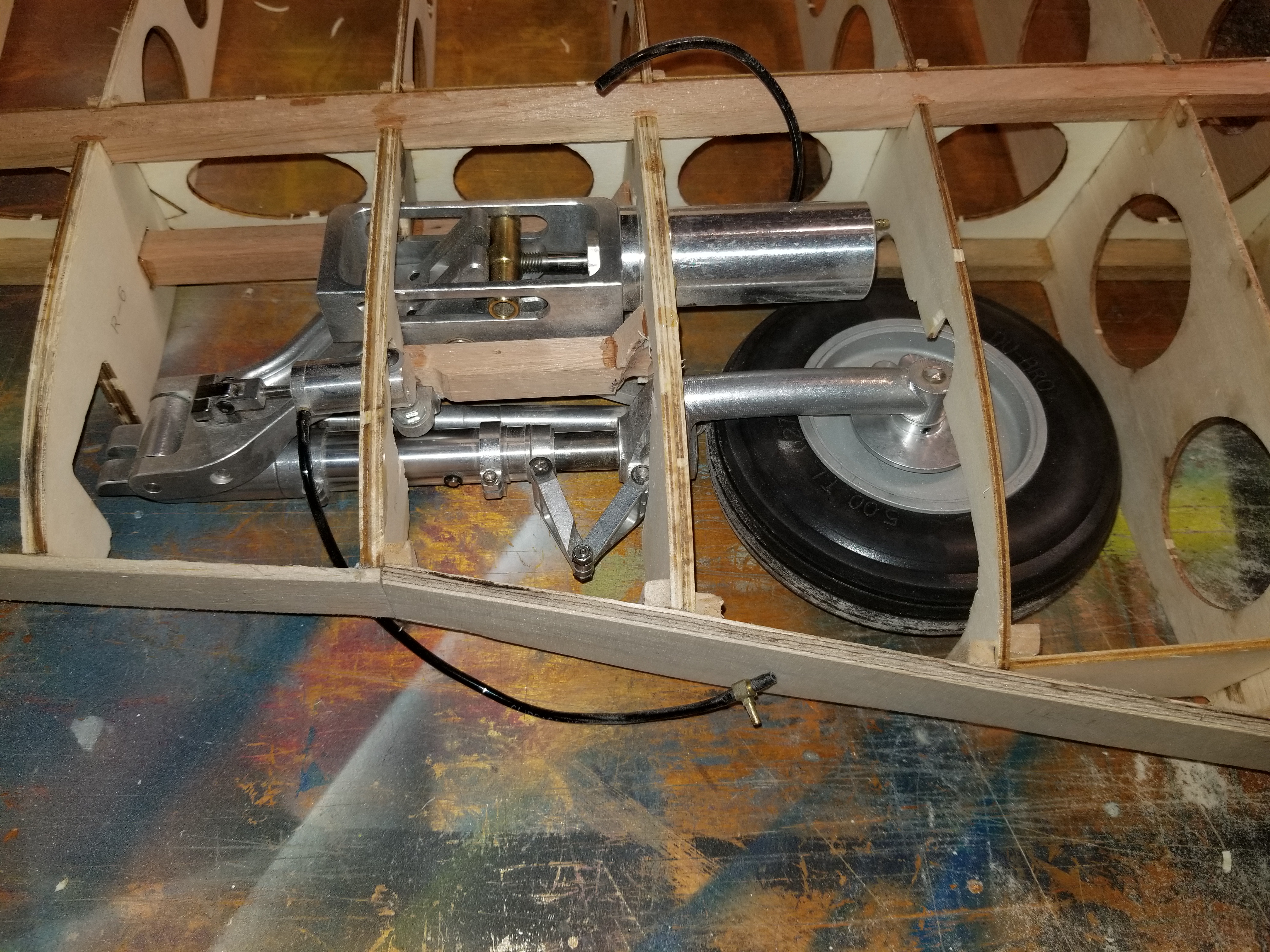

  7. Gear have been installed. This was a bit of a challenge. These gear take up alot of room. I was able to install some plywood reinforcements that are glued directly to the main spar so I feel confident that they should hold up.

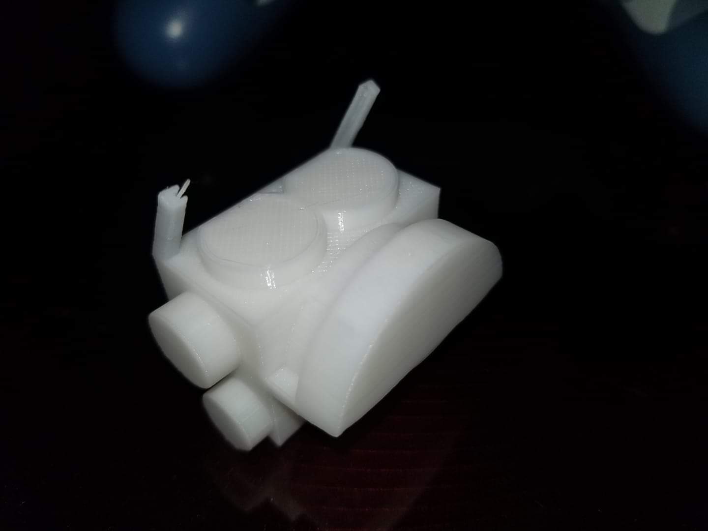

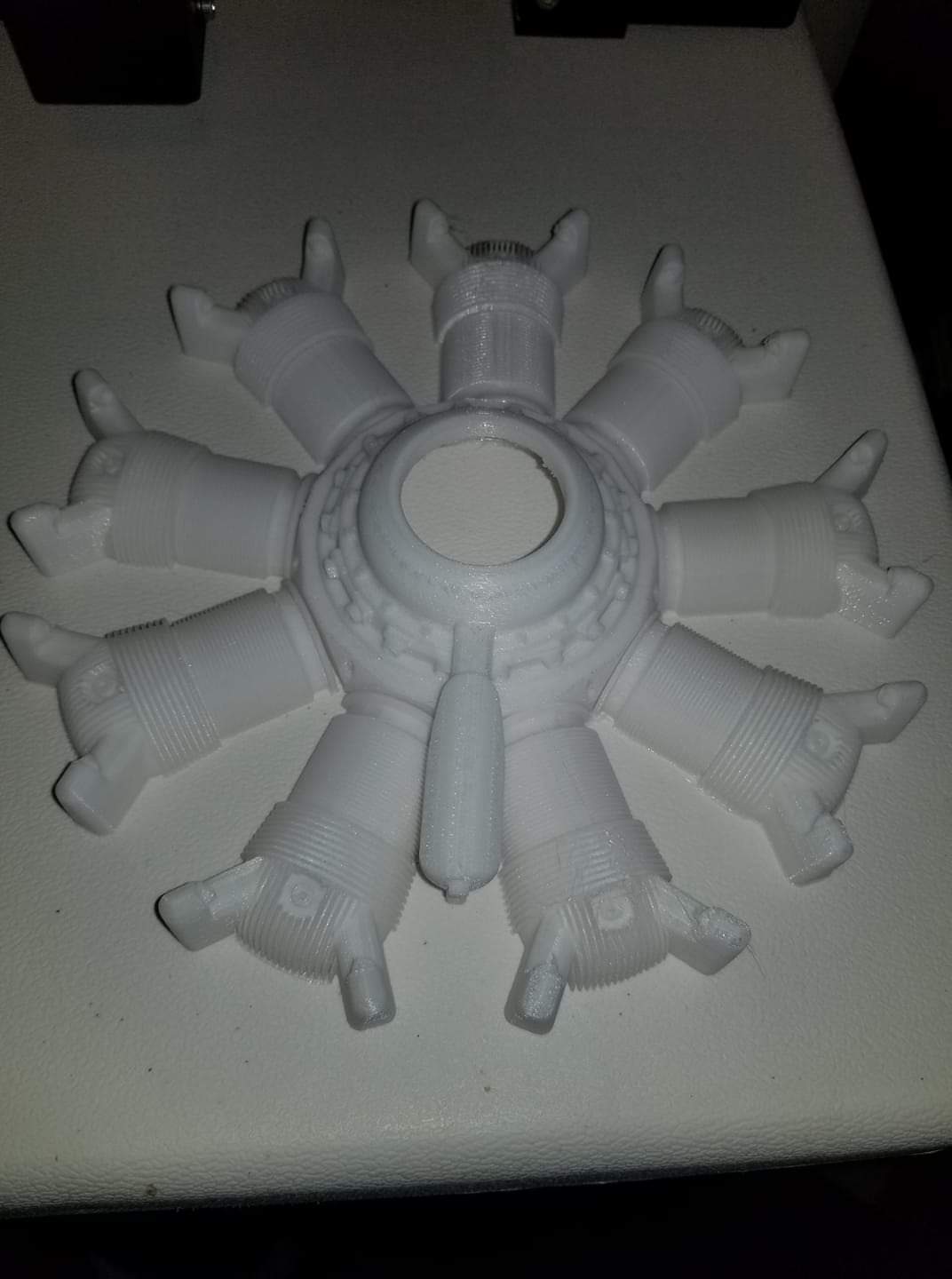

  8. Just a little extra that I've been working on. I got myself a 3d printer and started with a radial engine which I still need to finish and last weekend I drew up a gun sight and printed that out. I want to also create a plastic prop hub to go around a 4blade prop. Still need to confirm engine and prop 1st though.
