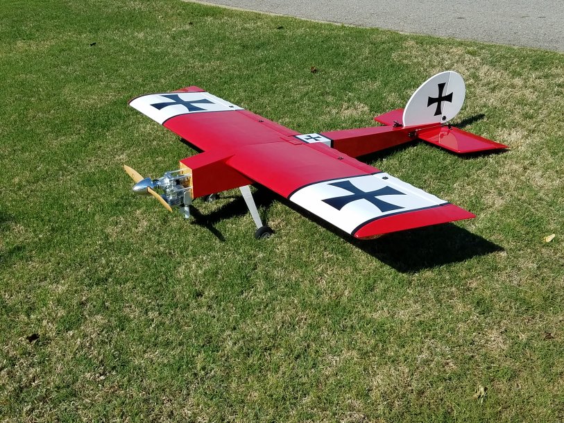

The DLE 35RA fired right up and I had no issues at all with the maiden! Got 4 flights in. Only took a little trimming and was flying great! Very good day today.
