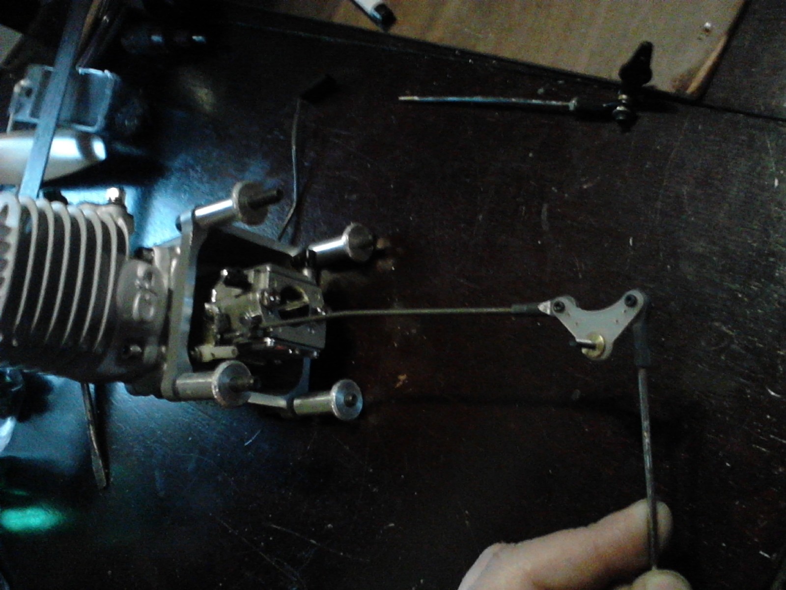

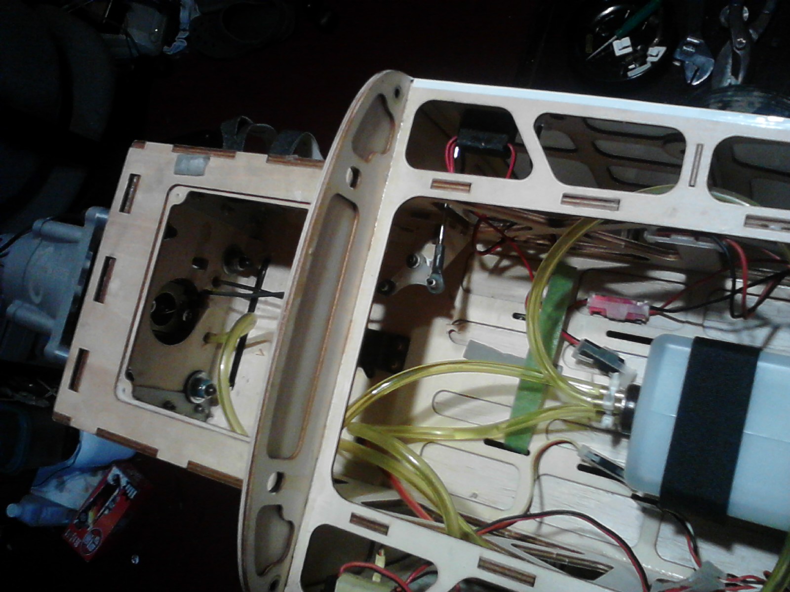

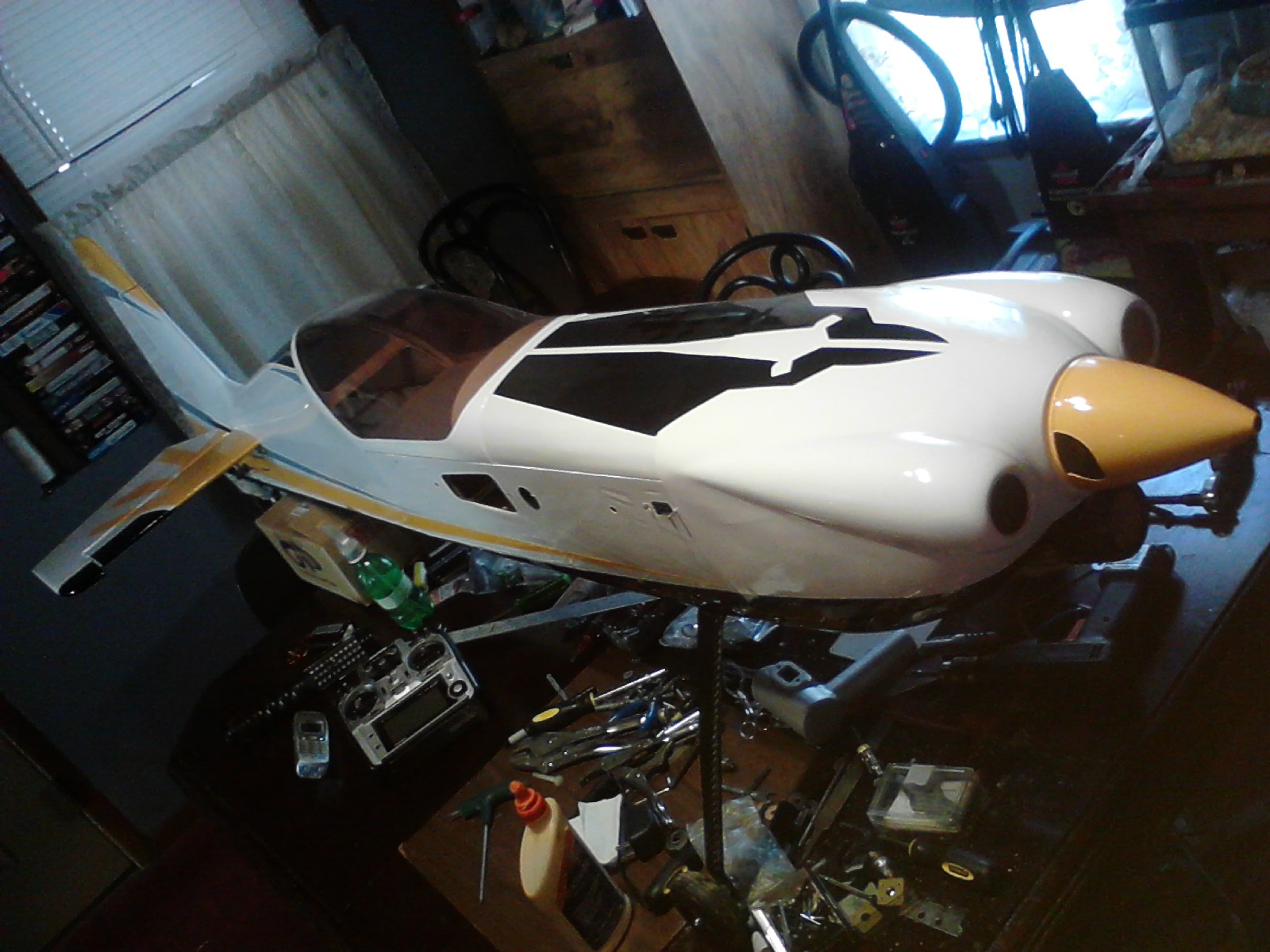

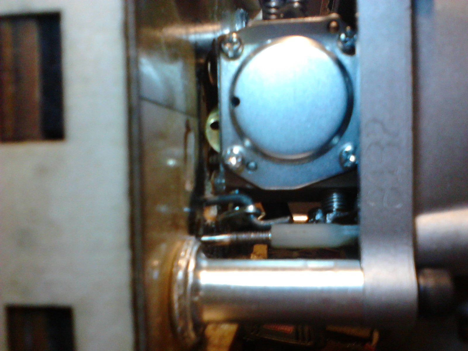

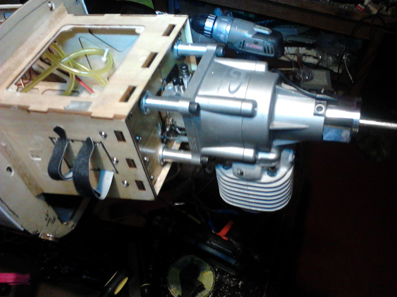

Just getting started with mine.... GP-61 mounted and linkages set up......
(91" Corvus Racer -- replacing previous DLE-55 that just went to another plane)
Used 1-1/4" standoffs I made on my lathe to match the old DLE-55 length......
Going to go with a 24x9 Falcon Carbon prop.....
