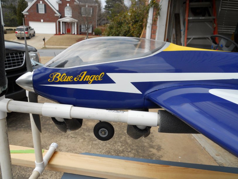

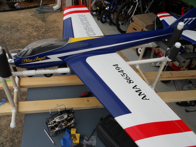

I fly ARFs but build classic pattern planes. Her is a scratch built MK Blue Angel I did a couple of years ago. The build thread is on RCU in the classic pattern forum.

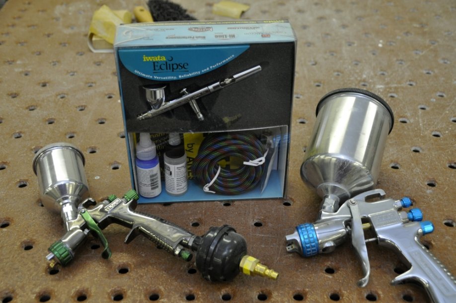

This is just the rules I go by, I'm sure I'll learn more as we go on here. Maybe myself and some others can do some quick vids. I know I'm going to airbrush flames on my Viper and I will probably do a time-lapse deal of that. Got myself a new airbrush for that because my old Grex is pissing me off and my Talon has seen it's better days. Finally stepped up to an Iwata:fist_pump:

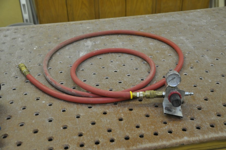

This is my entire hobby arsenal of spray equipment. I use a full size gun for clear and primer, I use a quality touch up gun for colors because I find I can get around on an airplane better with a small gun. Also with basecoats they dry flat so you don't need it all to flow together quite as much as with clear so the smaller fan pattern works well. Then you just need a hose with a simple regulator.

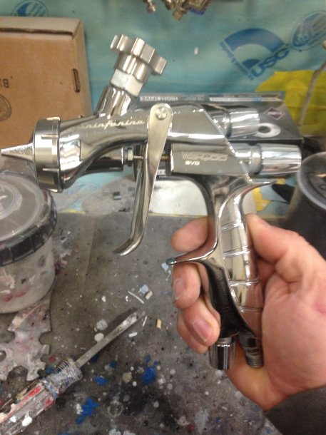

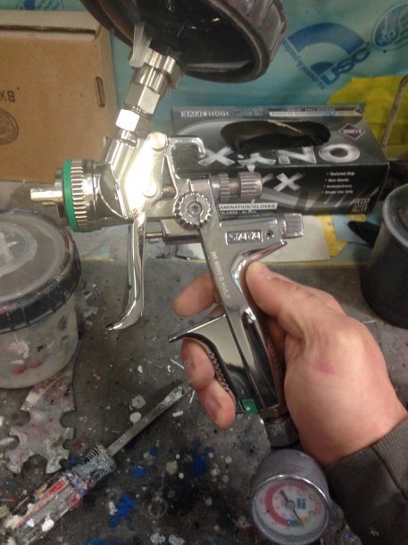

Jetpainter is right. Paint guns are all preference. I use sata and Iwata. Sata for primers and dealers and base coat, Iwata for clear. I use waterborne basecoat. It's not the best for home use. You need a lot of airflow to get it to dry or a lot of time. Older basecoat is nice. You don't wanna hammer it on(sorry terry), because you don't want to trap solvents. The main thing is just taking your time. I have tried cheaper paint guns and they just don't last. I bought a sata 2000 back in 2000 as well, and it is still going. I paint a lot. Too much. Never forget your respirator guys. I am 33 and I can say I am not liking the effects this stuff has on my body day in and day out. Good ventilation too. I have a supplied air respirator, bu not needed for home use
Dooinit

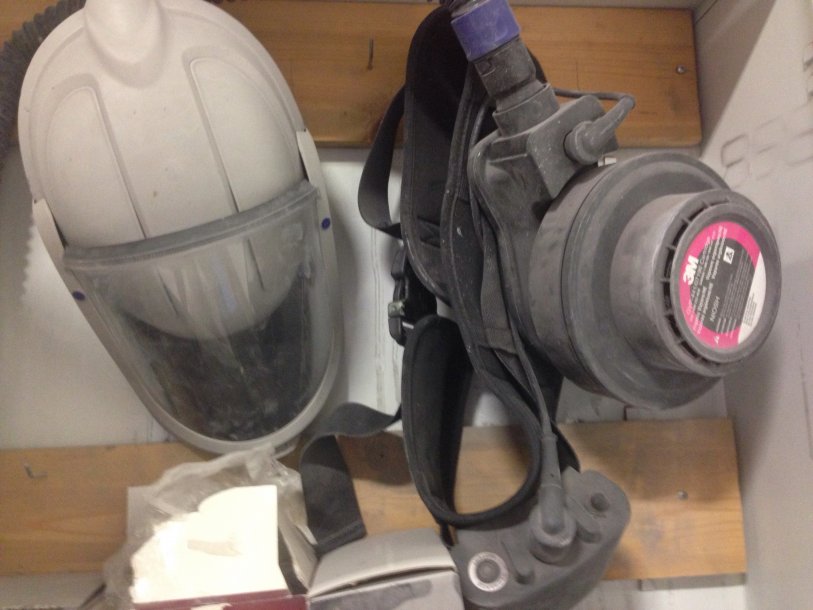

That is a 3m papr unit. Real nice if you don't have super clean air from your compressor. The Iwata is my clear gun. Best one I have used to date(I have tried LOTS) 1.3 tip. The sata 4000 is a great base coat gun. It has a 1.4 tip.
