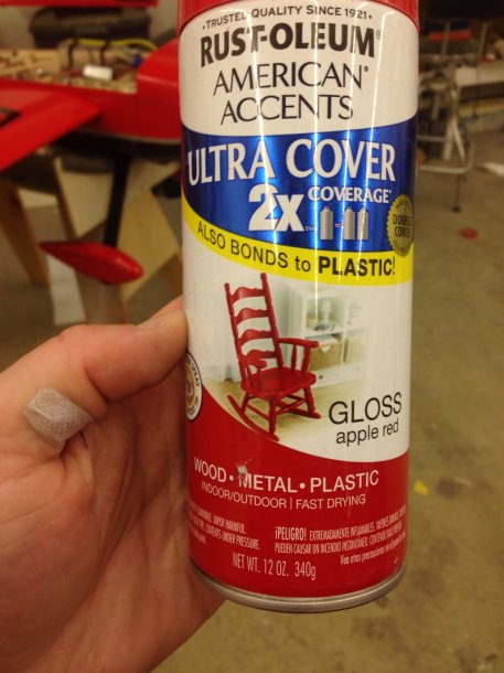

If you are recovering the whole plane and you use ultracote, I found a red bomb can that matches extremely well.

This matches true red

Dooinit
But I see you are using deep red. Orthobird used a company that matches covering colors. You could message him
