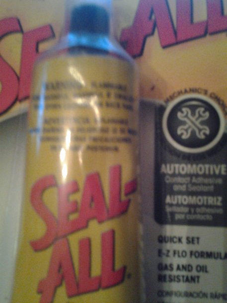

Can anyone recommend a fuel proof sealant that I can use to reseal the cap on a Fortitude tank once I have opened it up and replaced the cap?
Seal All found at most any auto parts stores
Terryscustom
Seal All works but like any other like it, it is "fuel resistant", it will still dissolve in fuel so you need to make sure you don't get any in direct contact with the gas or it dissolves and makes a mess out of the little passages in your carby.
