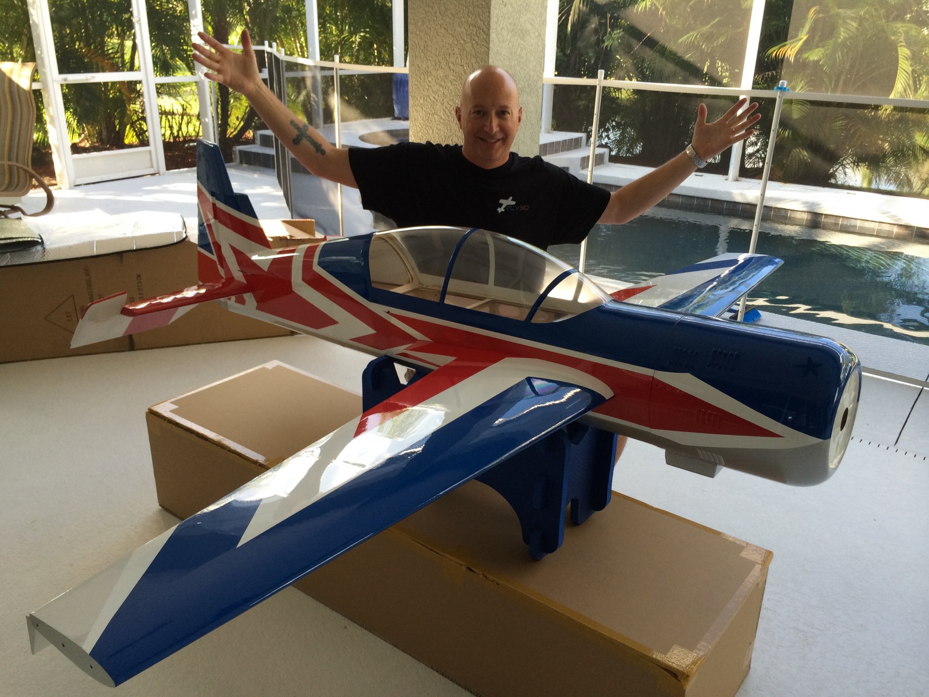

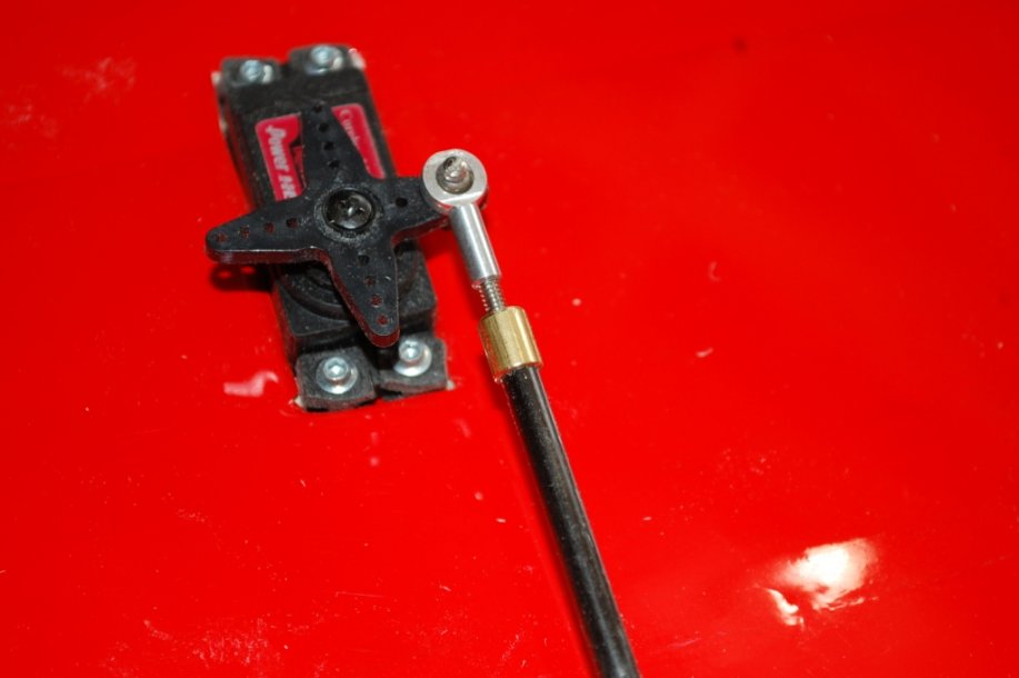

Airplane is in the house :) IMG_3731.jpg

Airplane is in the house :) View attachment 17604
