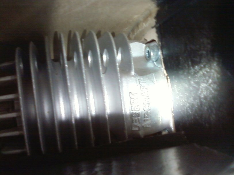

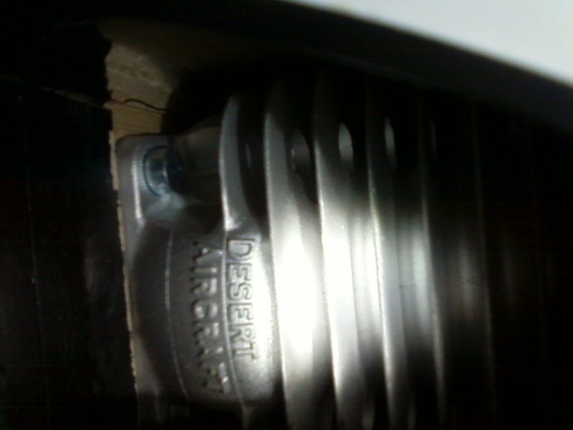

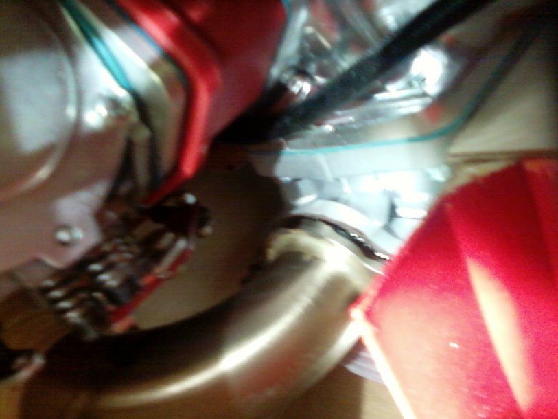

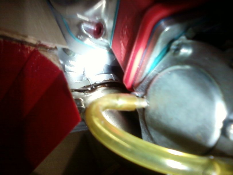

@orthobird I know you have been anxious about the cooling temps the duct work provides but sad to say numbers through telemetry will be postponed even longer until I can get my new radio (Futaba 14sg) back.
Here are some pics I just took showing how clean and new looking the engine still is and no signs of any kind of heat stress. Engine just fully broke in on me last time out. About 7 gallons of fuel through it. The dark residue you see at the exhaust ports is hardened gasket sealer that has been there since I installed the headers to the engine. Appears the system works exceptionally well with out having to gut the bottom.

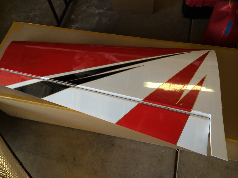

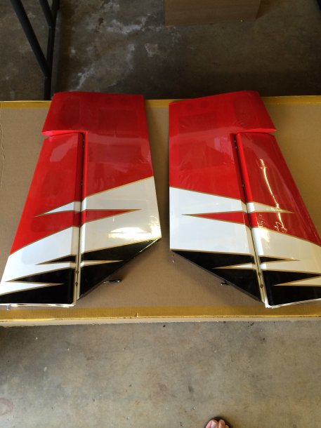

Something the guys at my field have been doing, that I have yet to do, but looks pretty awesome on this plane is pin striping the covering, it really makes it pop! On the red I've seen them use gold and silver on the blue scheme. Here is a pic of the red with gold, these are the wings and stabs that were given to me. I think the gold on the red/black looks AWESOME and the silver on the blue looks really good too... I'm thinking I'm going to do it, just gotta find the time. They are using automotive pin-striping from the auto parts store, it's WAY cheaper than buying ultracote or monokote pin-striping..

Camms that is some tidy insides you got there. Nice wiring.

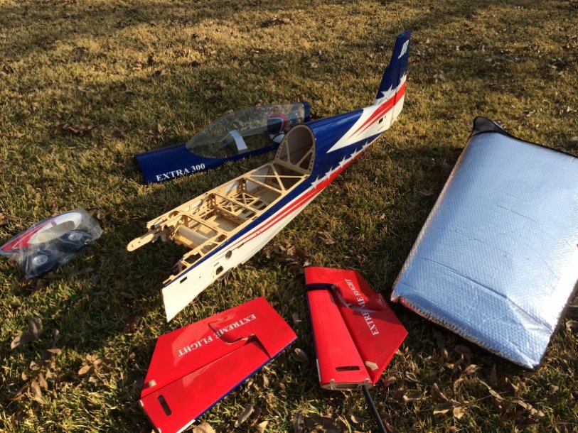

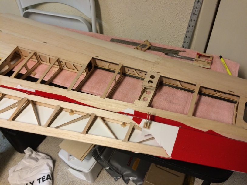

I picked up some parts for the 104" Extra from a pilot that recently pancaked his in. Fuse and elevators are pretty busted up but the canopy with instrument panel/pilot are in very good condition. Also came with the SFG's and one wheel pant and two wheels. Cowl was included but will need some fiberglass work and paint. Mainly purchased the parts for the two wings; R wing is perfect and the L wing had a LG/wheel pant punch through the covering and mess up a rib.
I'm going to split the ailerons on the two wings. I'll start with the outboard aileron for control surface and have the inboard fixed. If I don't like the performance I'll setup the inboard aileron as well. I'm also going to change the outboard servo from the horizontal surface mount to a vertical internal mount covered by an access hatch. I think those look much cleaner on the bottom of the wing. Once done I'll recover in red/white/black with a scheme that is more IMAC friendly to my eyes, I like straighter lines on the fuse and wings.
I'm impressed with the structure of the EF wing. Almost every balsa/ply joint that I can see is laser cut with either a dove tail or locking tab assembly. There are also four carbon fiber "stringers" (two top of wing, two bottom of wing" that run on both sides of the wing tube from the wing root to the wing tip. Another thing, the wing tube sleeve is completely boxed in. I'm not an engineer but the construction looks awesome.........great job EF.
Once I repair the cowl I'm going to attempt to split it into upper/lower halves. Having seen several done on GSN it doesn't seem overly difficult.
