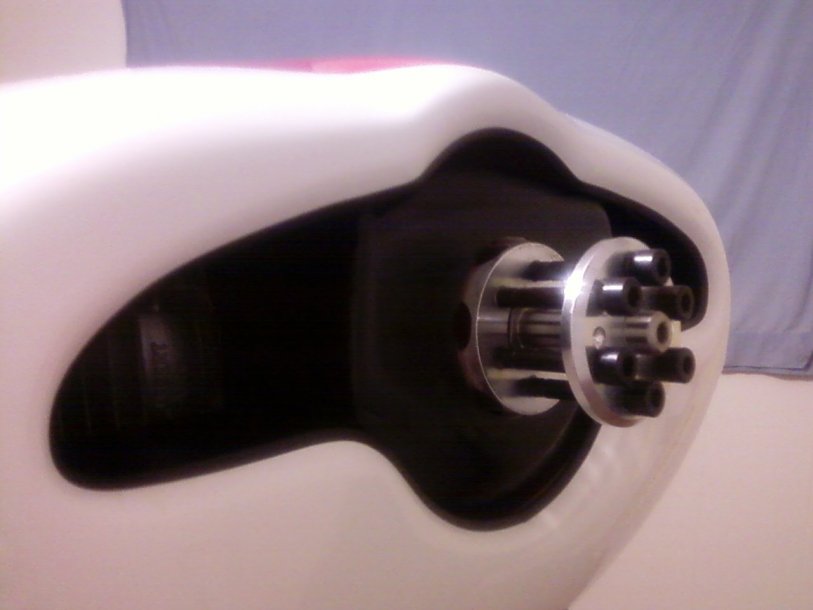

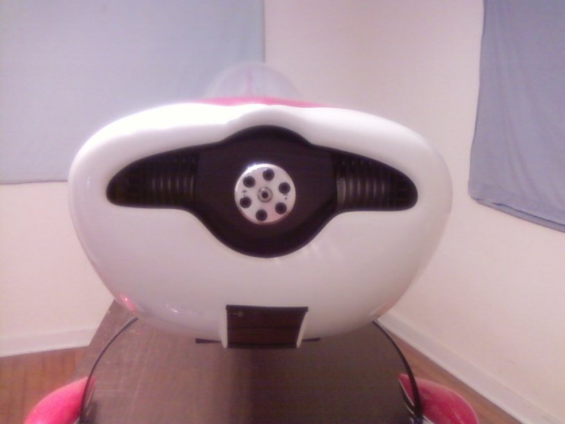

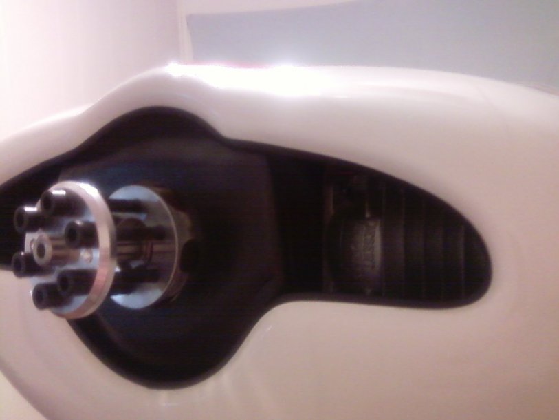

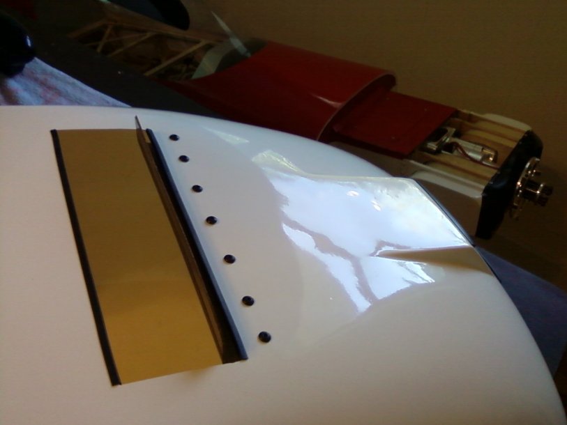

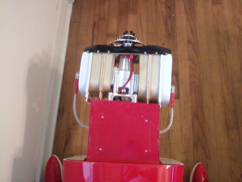

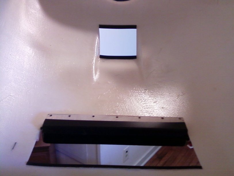

A few guys were interested in the ducting I did for the 104. It has operated and cooled the DA120 extremely well ( as best I can tell) but I have no temperature data as of yet. Figured this is good as place as any to follow up with some numbers once I get the new telemetry radio set up and the choice/type of sensor. Now I am not going to get all technical with btu's hr per cfm sort of thing. Just the peak temp during stalled flight over time in minutes and average temps. One huge advantage that this type of duct offers is that heat soak does not adversely effect the bonnet top of the cowl since the 104 cowl is a soft fiberglass and the air exit does not have to be huge. I have some pictures I will post and will take some current picks as more gallons go through the engine. I have little time on it (about 6 gallons) and so far the wood construction and paint still look brand new and no signs of fatigue of the duct structure or its mounting points.

Construction was done with 1/32 sheet veneer, 1/8 lite ply, 1/16 balsa sheet, 3/8 square hard stock, popcicle sticks, 2x12x4 balsa block, 1/4 laminated light ply, enamel paint, 4-40x3/4 hex screw and long hex cap servo mounting screw.
I apologize for I no longer have pics of construction sequences.
