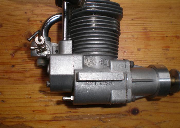

    Hi guys,
    I've got an Enya 120-4C that was on a Cub I picked up a couple of weeks ago. The bearings that were in there were rusty so I ordered new ones but the original main bearing had open bearings and the front bearing was sealed in the front. The replacement bearings that Boca sent me are both sealed front/back.
    Any suggestions? I sent a message to Boca but haven't head back yet. Thanks!
    Bart

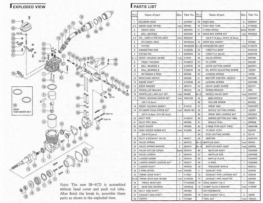

    Not very knowledgeable on Enya engines but if it was an OS 120 you need to remove both shields from main crank bearing the oil needs to get to the cam gear and lifters. The only oil that gets down there is a controlled blow bypass so you need the lubrication.

    The bearings from BOCA are sealed and lubricated. You do not need to remove the shields. The cam gears and bushings get lubricated from blow by oil as snoops described. The camshaft drive ball bearing in the rear (driven by the crank pin) can remain sealed as well if you also got that particular bearing.
