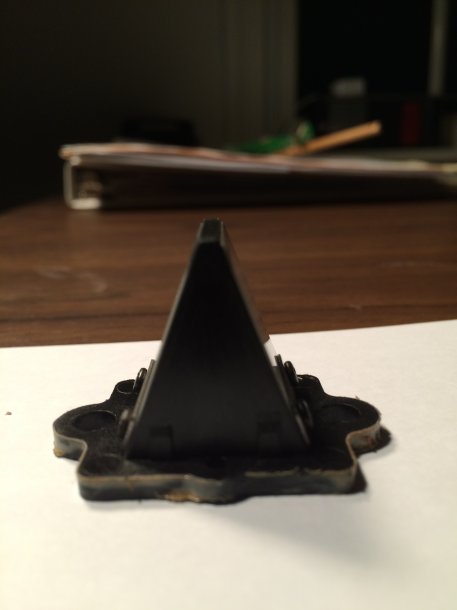

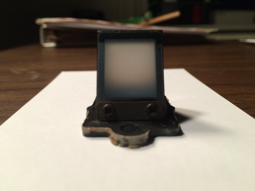

are you sure the rings that are in there aren't stuck in their grooves from lack of use?  shoot some carb cleaner in there and let it soak in to loosen them or just pull the head and look at them.
did you replace the gasket between the carb and insulator block? the gasket between the insulator block and engine case? are you sure they're both installed in the right direction? no scoring on their mounting surfaces, right?
gunk in the debris screen? pull the plate off the carb and check the screen under the fuel pump diaphragm, you could have gunk coming in from your fuel lines that would have affected both carbs
just curious, where would there be a reed on this engine? it looks like it uses cylinder porting and not a reed in the intake for fuel flow control.
