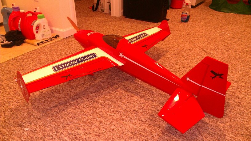

EF 48" Laser EXP
working on putting the laser together tonight got a lot of it done so far (after a few planes these things go together so fast) All i have left is the aileron servos, esc install, drilling holes for the cowl screws, and setting up the plane. Decided to change things up from the original plane and put the SunnySky 800kv motor w/13x6.5 apc, ZTW 50amp, HS5065mg on the elevator, Align DS410m on all other surfaces

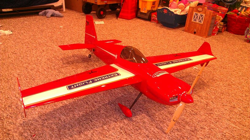

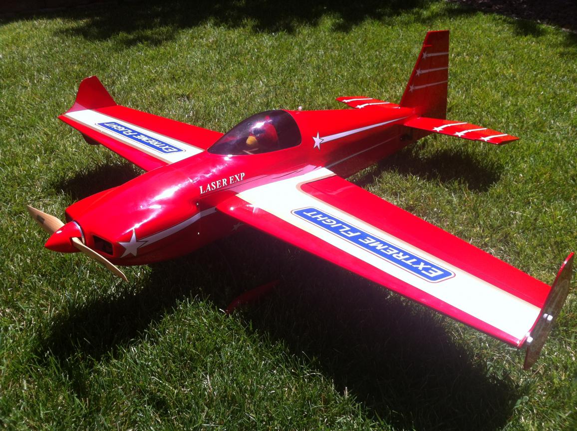

Done! I went with a bit more understated design. (I.e. I got tired of stickers). But I like it!
[Hmmm... Really bad light. I'll have to take a better pic tomorrow...]

Congrats, looks really good! Will you maiden tomorrow?
-G
njswede
Tomorrow or Sunday, depending on weather. Tomorrow looks a little bit breezy.
Any opinion on the 14" prop? It's REALLY close to the ground...
gyro
GSN Contributor
You should be fine. I flew my laser with a 13, but flew the 14 on my MXS and Edge with no problems. I can't see the ground clearance being significantly larger for that EXP versus the others. You're not landing nose first (at least you shouldn't be) anyway, so you should be fine. that said, I probably broke a prop every 3 or 4th weekend anyway, but my field is rough, and I flew a lot of wood props with really can't handle any type of ground contact, whereas the APCs are a little more durable.

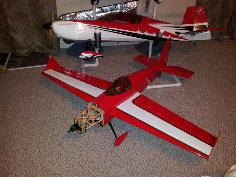

Almost done even got the pilot mounted tonight. Just need to mount the cowl and install the prop
