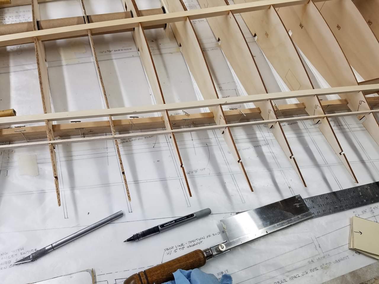

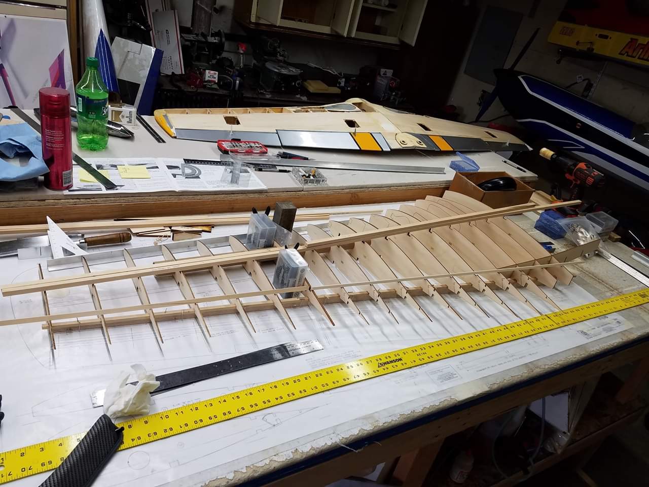

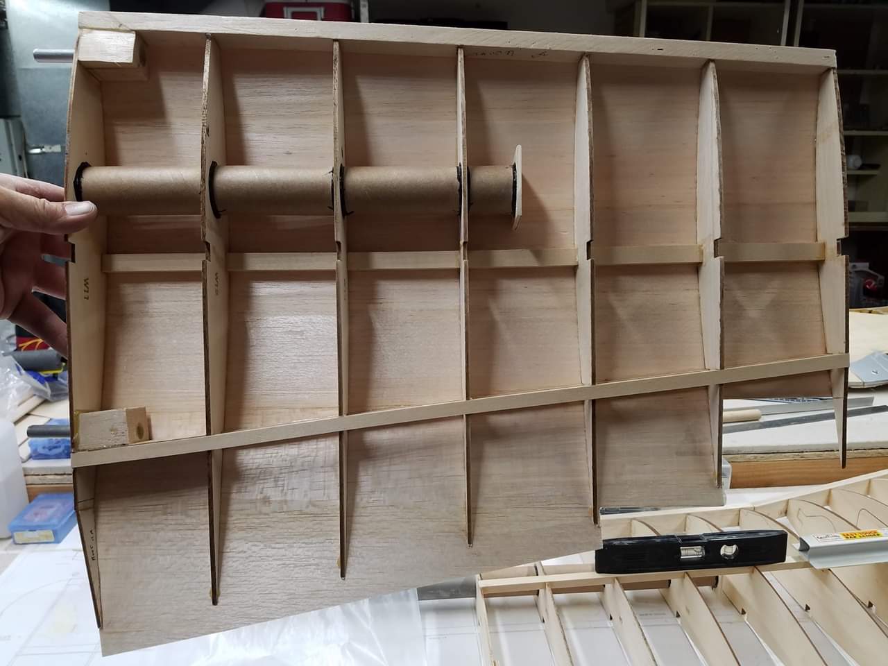

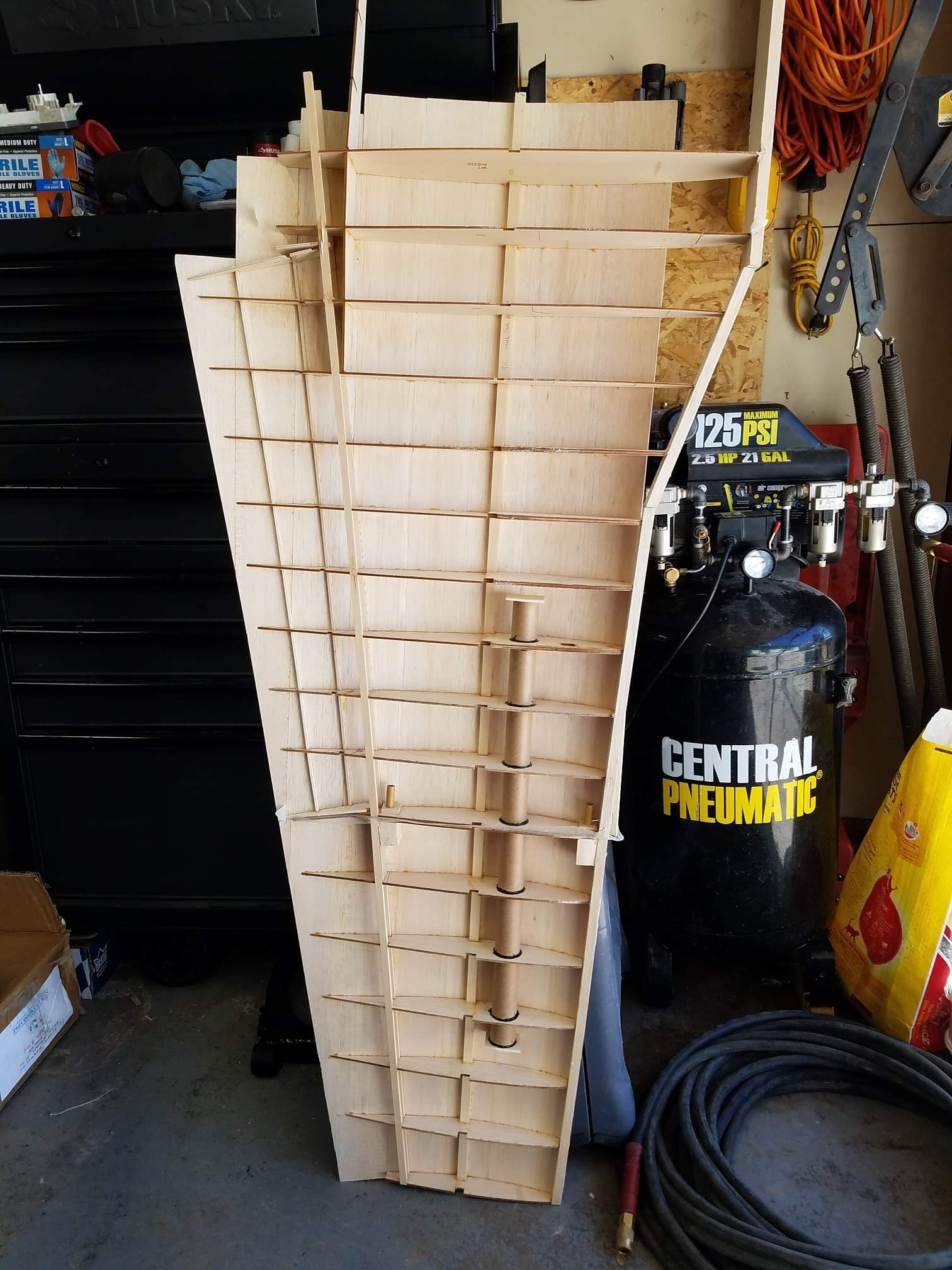

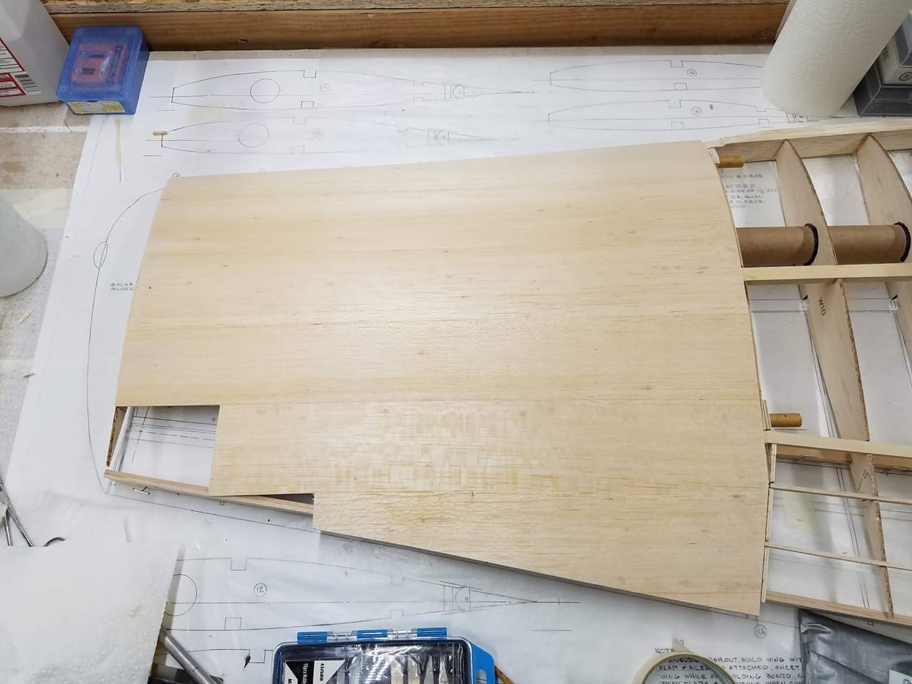

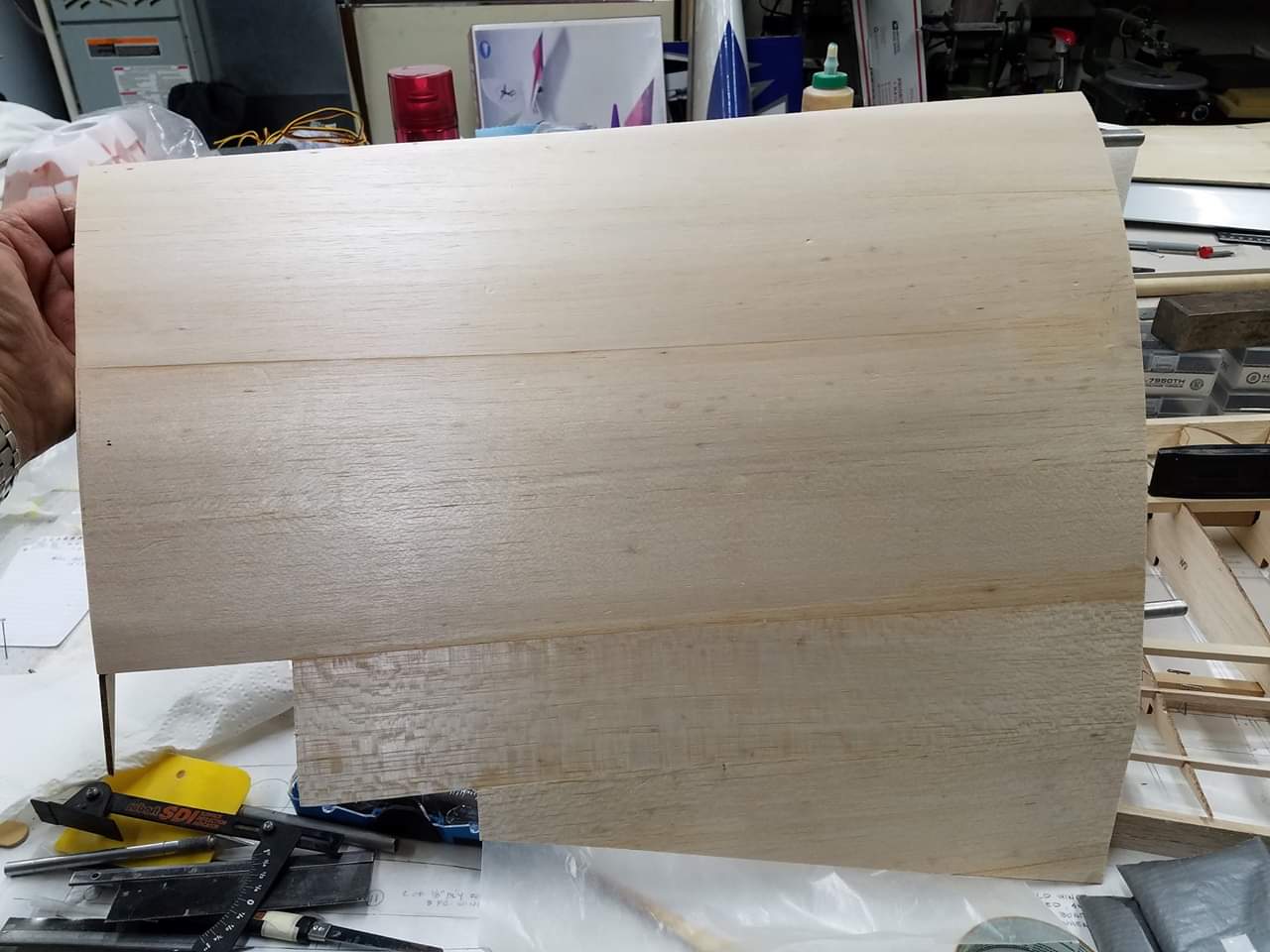

Maybe I owe you all a little update? Maybe a sniff to tantalize your taste buds? Just a sneak at a little eye candy?

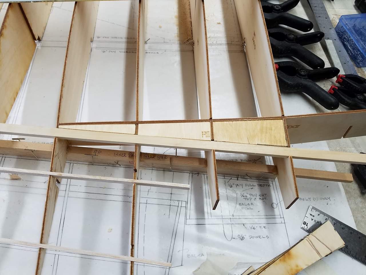

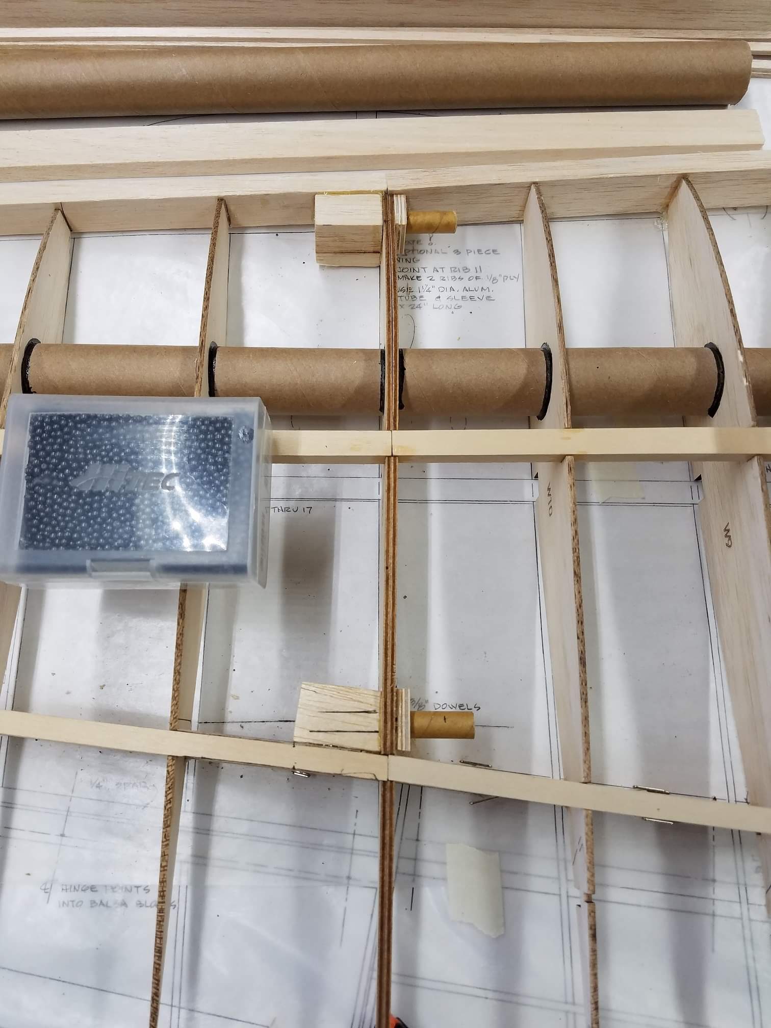

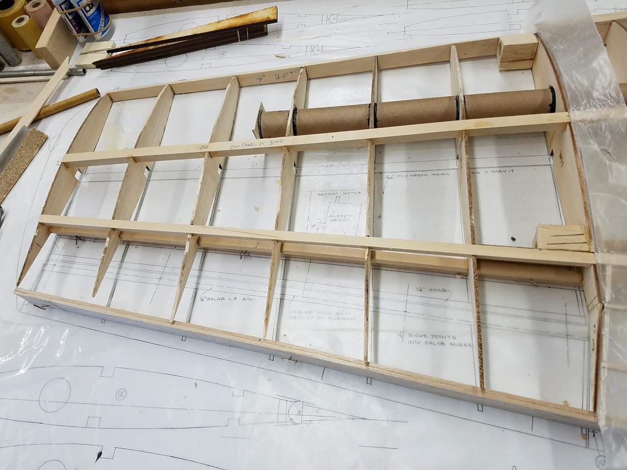

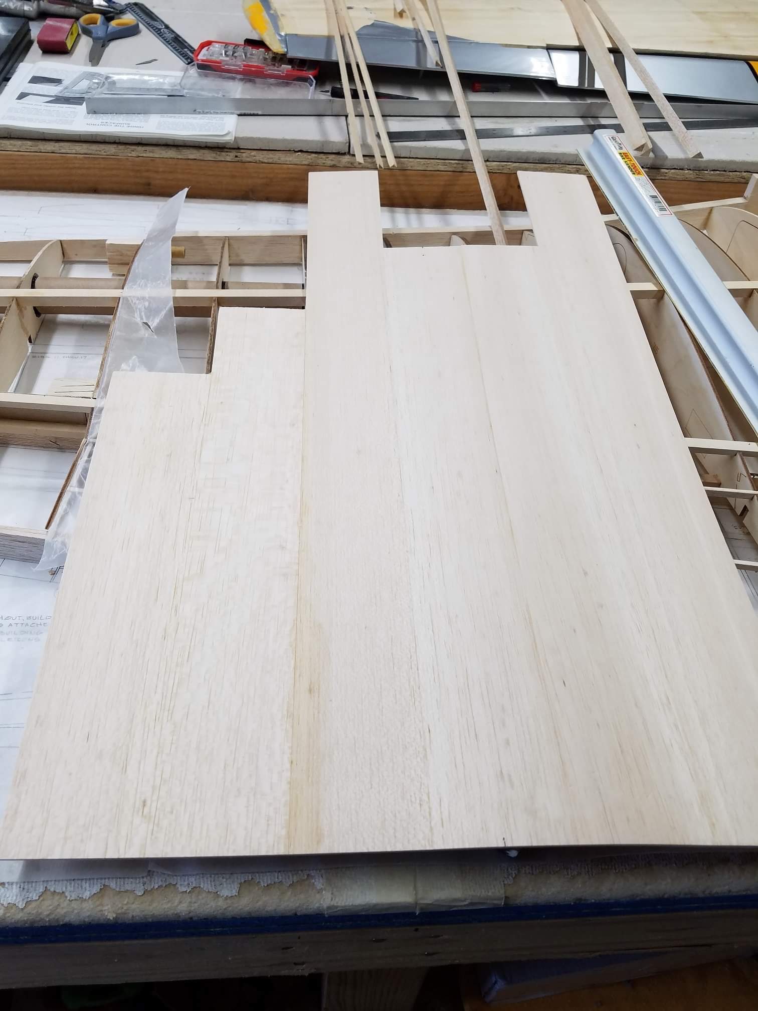

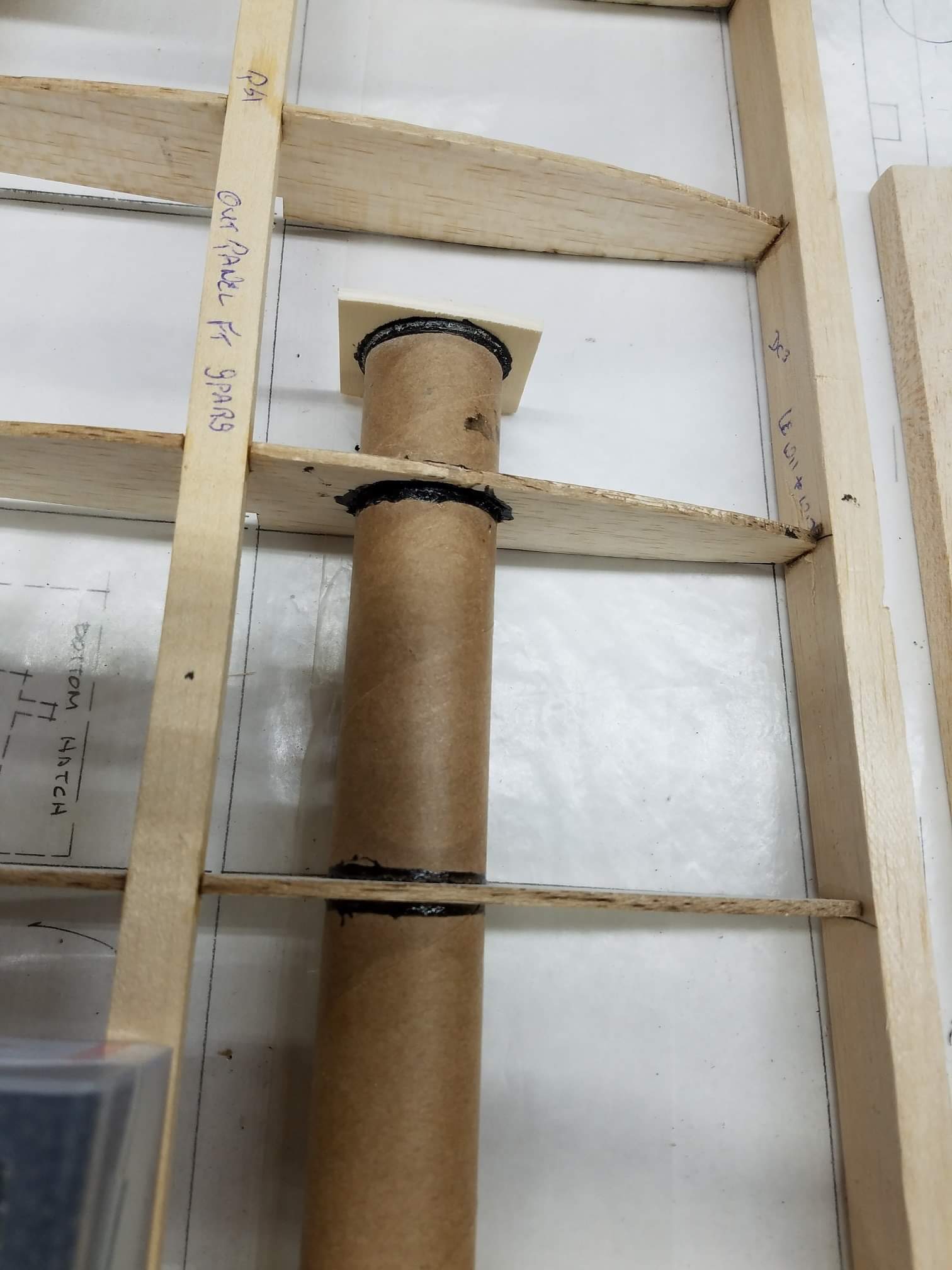

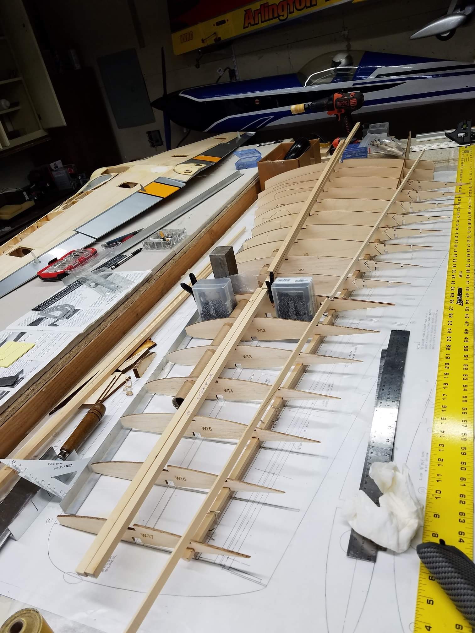

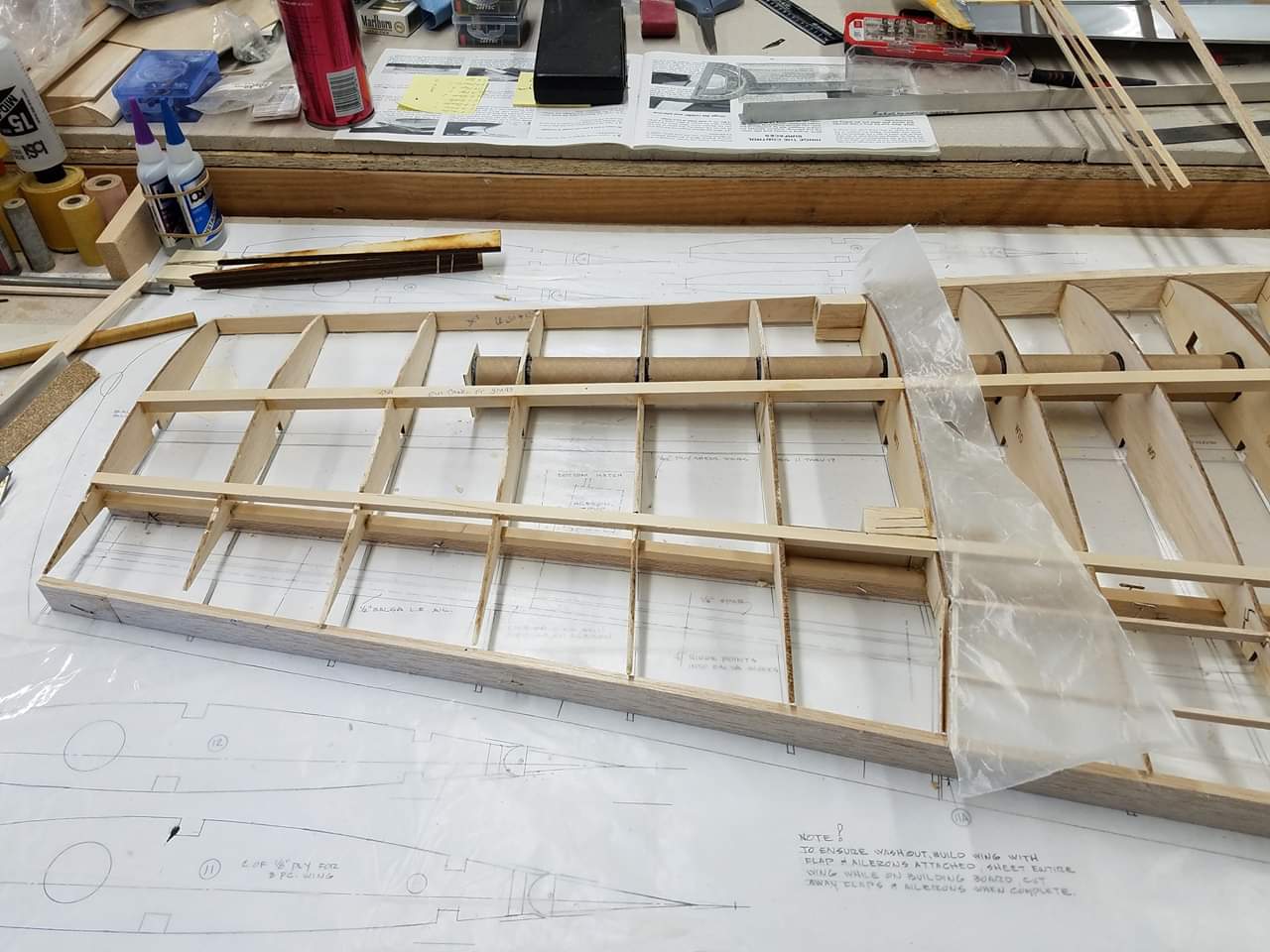

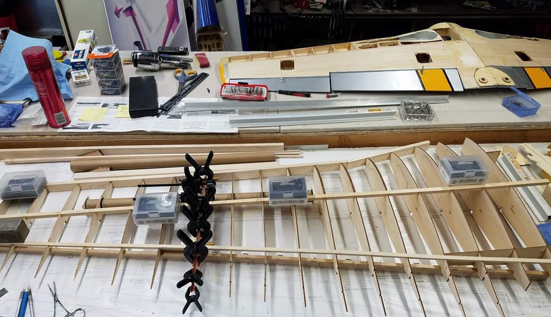

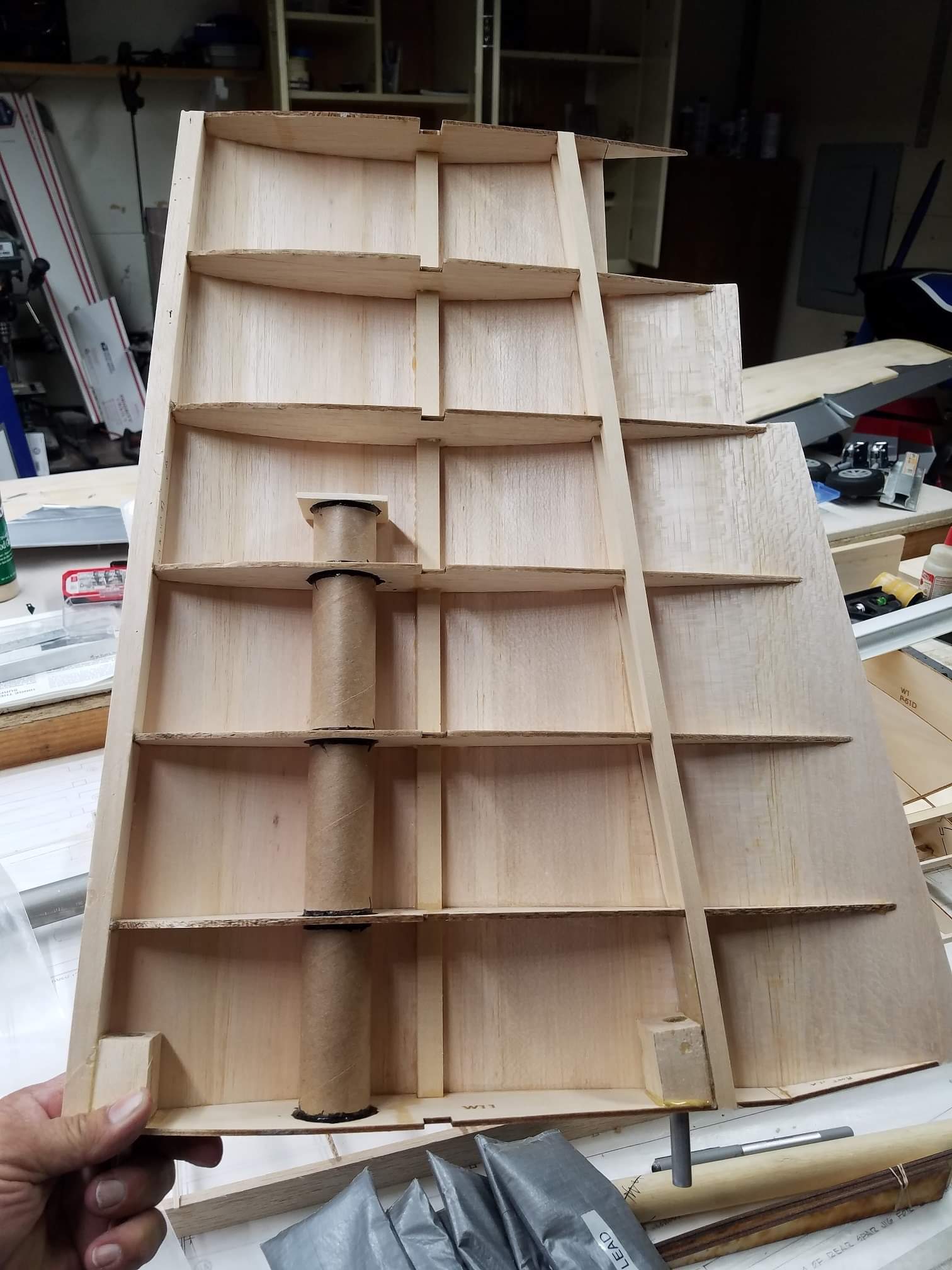

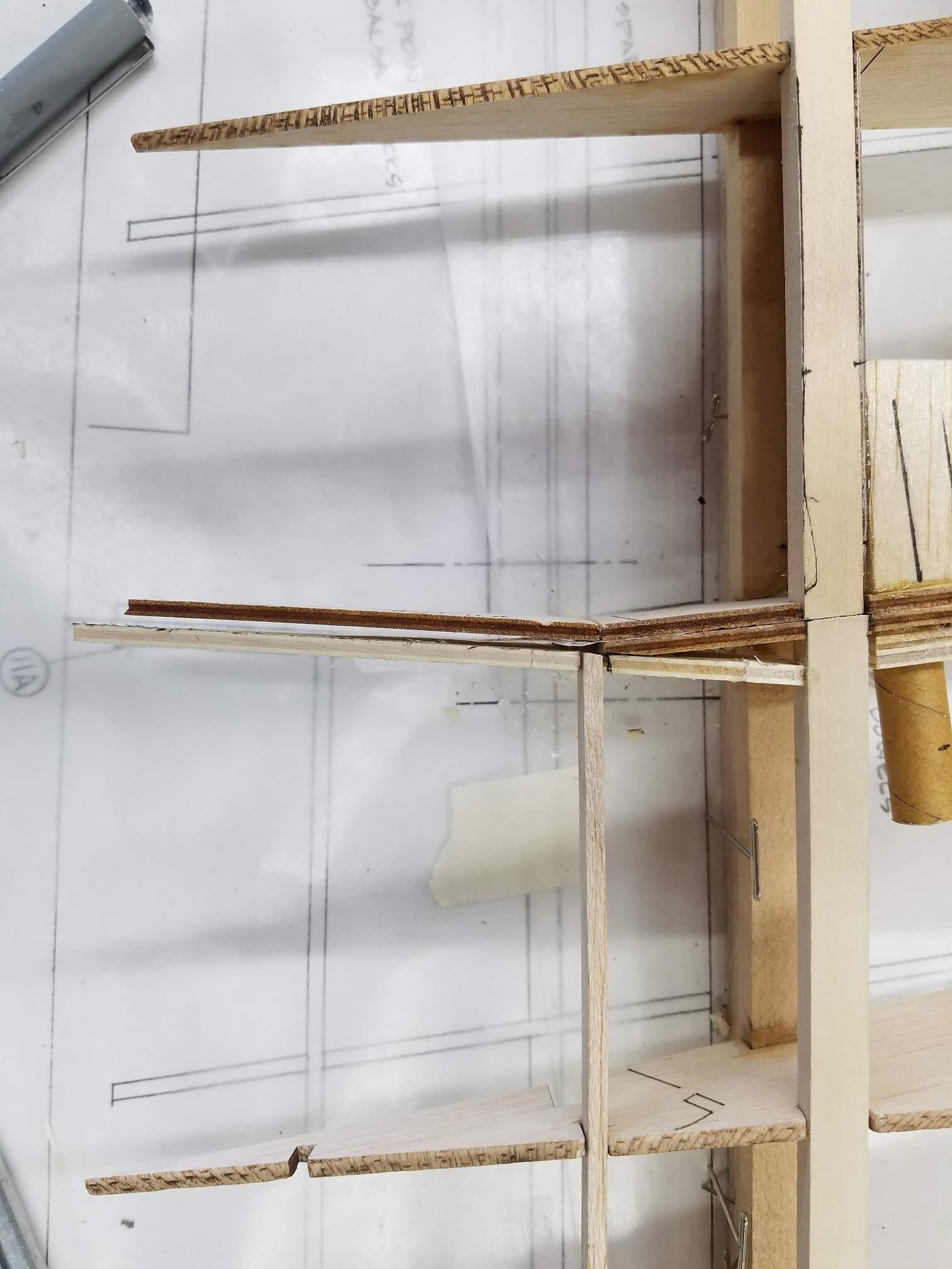

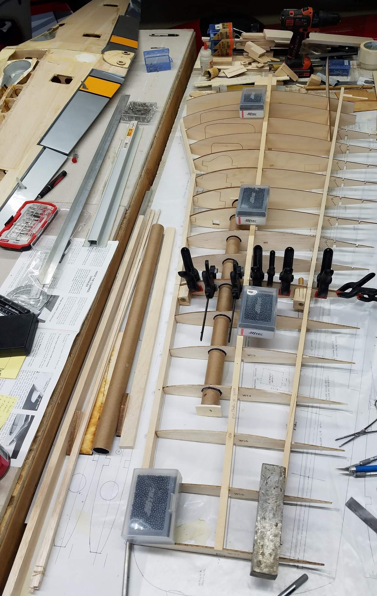

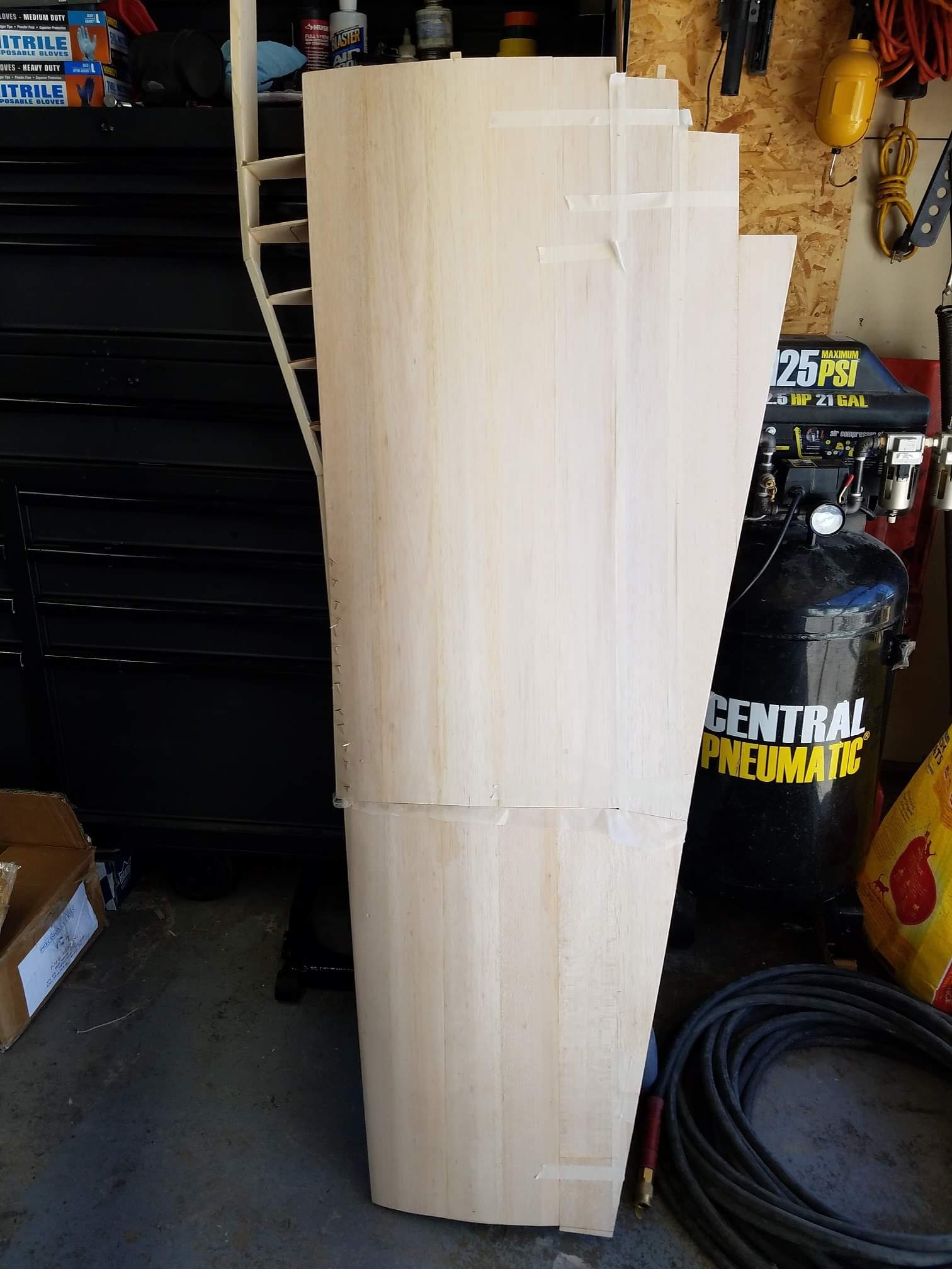

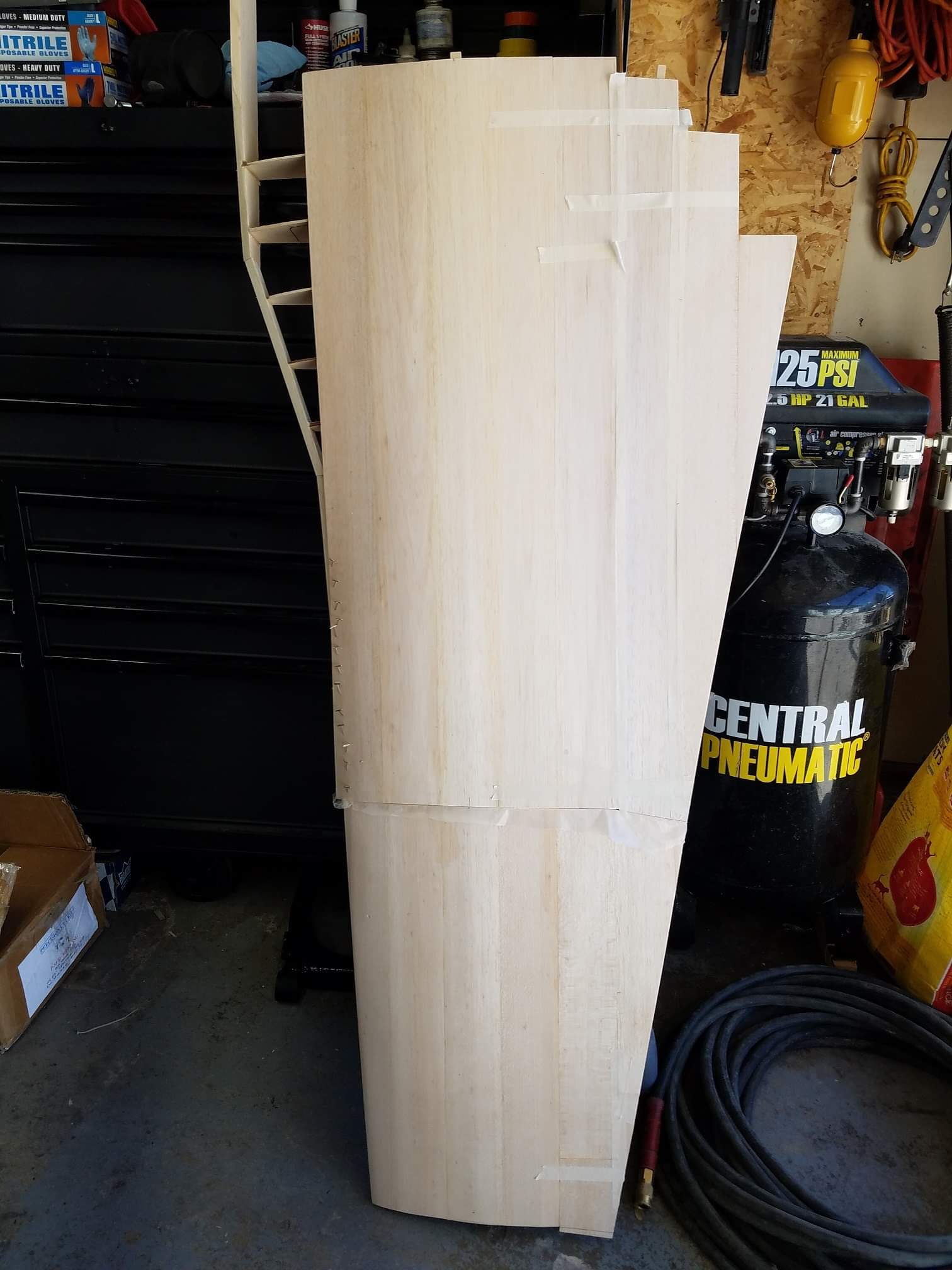

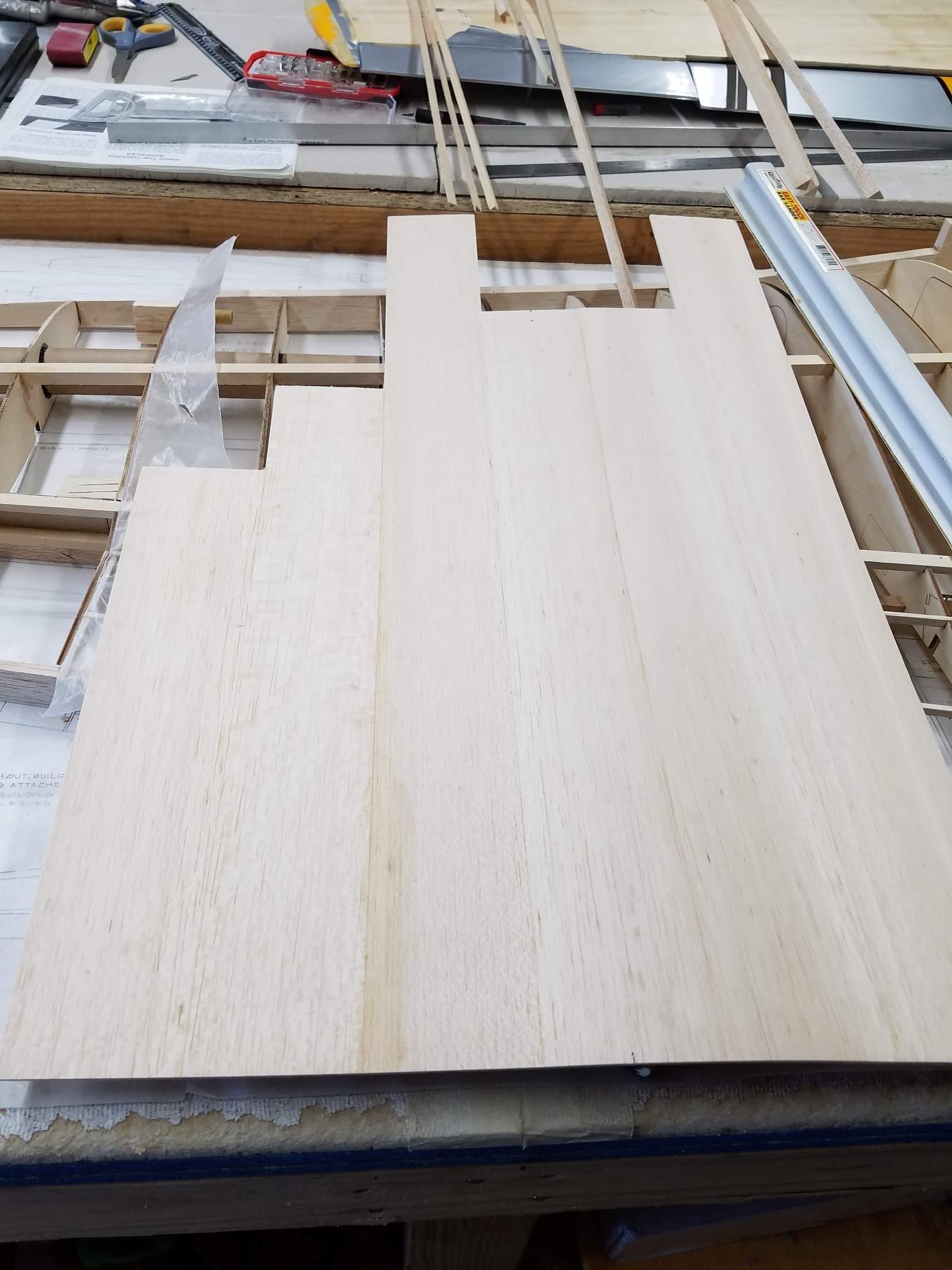

Got a pretty good start on the top half of the right wing. Trying very carefully to build this strong, but no extra weight. I have built some pretty darn straight fuselages and tail feathers in my day. But one thing I've learned really well, is the overall handling and flight characteristics are 90% dependent on the construction of the main wing. So I spend way more time, (maybe too much) on the accuracy and structural integrity of the wing as i do any other part of the build.
I apologize in advance if the photos are not in chronological order.
FB_IMG_1569281725410.jpg FB_IMG_1569281690504.jpg FB_IMG_1569281694760.jpg FB_IMG_1569281722448.jpg FB_IMG_1569281821306.jpg FB_IMG_1569281704294.jpg FB_IMG_1569281824367.jpg FB_IMG_1569281707532.jpg FB_IMG_1569281731216.jpg FB_IMG_1569281698038.jpg FB_IMG_1569281734013.jpg FB_IMG_1569281700954.jpg FB_IMG_1569281716274.jpg FB_IMG_1569281718856.jpg FB_IMG_1569281713591.jpg FB_IMG_1569281686707.jpg FB_IMG_1569281728221.jpg FB_IMG_1569281653329.jpg FB_IMG_1569281710961.jpg FB_IMG_1569281649316.jpg
