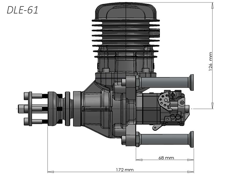

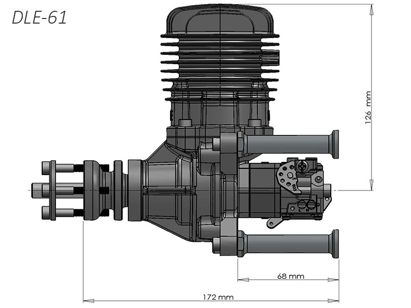

well from the diagram I added it said from the prop hub to the engine mounting holes was 172mm...well the plane I have from the firewall to the cowl opening is 6 13/16 inches (173mm) the motor head would be up on the firewall according to my diagram
the diagram that you provided from prop hub to standoff ends is 172mm so I get some spacers and I am good, with no mods to the firewall
Here is the correct diagram. View attachment 12965
Well that is perfect then. I assumed you were going off the DLE measurements. (Did seem a bit much)

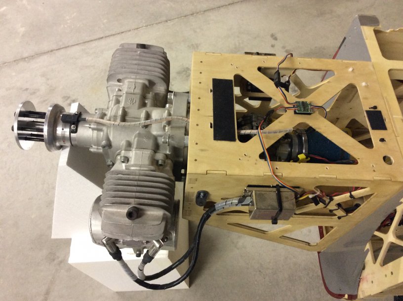

Actually, you can recess a hole in the firewall. Seen lots of them done this way. With my 50% Edge, that is the only way you can get the 3W 275 to mount.

OK, I'm confused. It appears the engine would fit just fine from the dimensions given by the OP.
I am not trying to confuse..
when I was looking at the diagram that Tower-hobbies has...I was adding the 172mm and 68mm cause of the way the diagram looked...By the diagram the engine is way to big for the plane I have. Then you added the correct diagram that shows the correct dimensions of the motor...which means that the engine will fit just fine..
