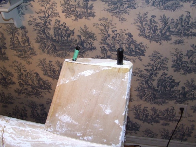

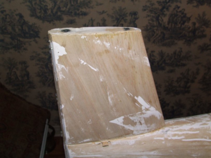

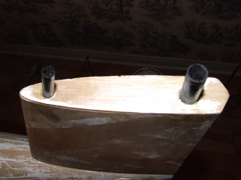

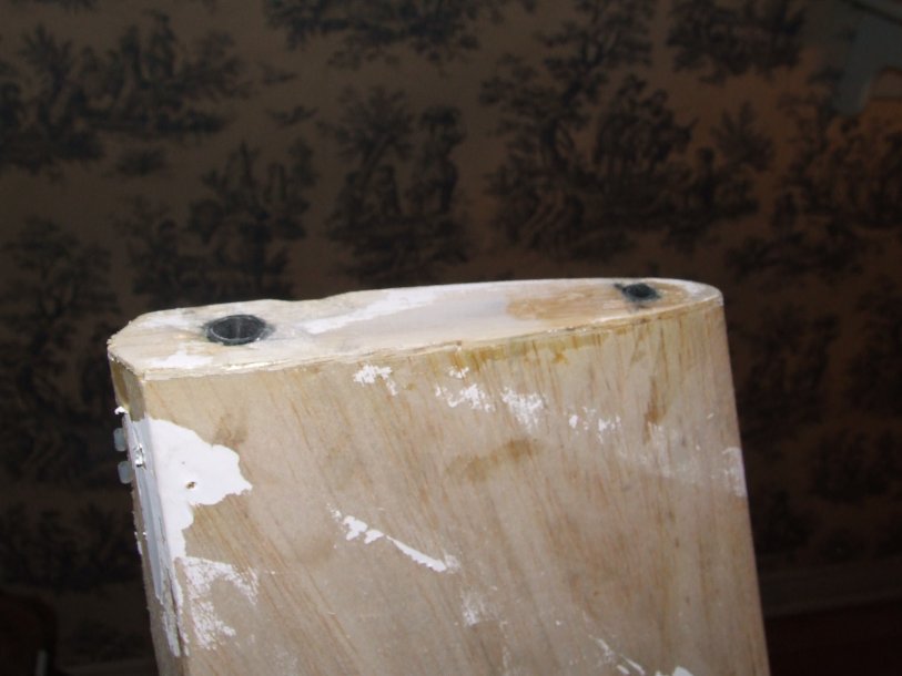

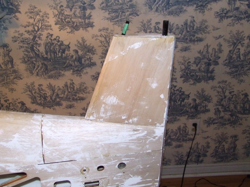

A another problem with this plane is that it had a very weak rudder post. I put two carbon rods down thought the top into solid balsa under the post. With the smaller rod I cut teeth into the end, put it in my drill and very slowly let it eat its way though the foam core into the solid balsa, the larger rod I just happened to have a 14 inch drill bit of the same size.
Can't see it breaking off to quick now!!

I should add that it added very little weight. I did weigh the rods before I put them in, but forgot to write it down :very_angry:

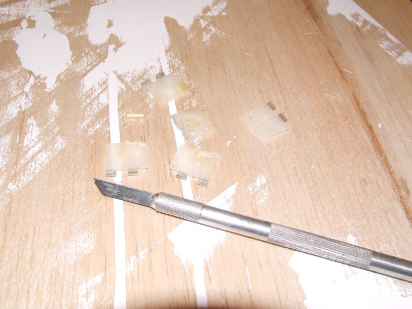

Cut the old broken hinges out from the rudder........
I think the slots were put in with a chainsaw!!
