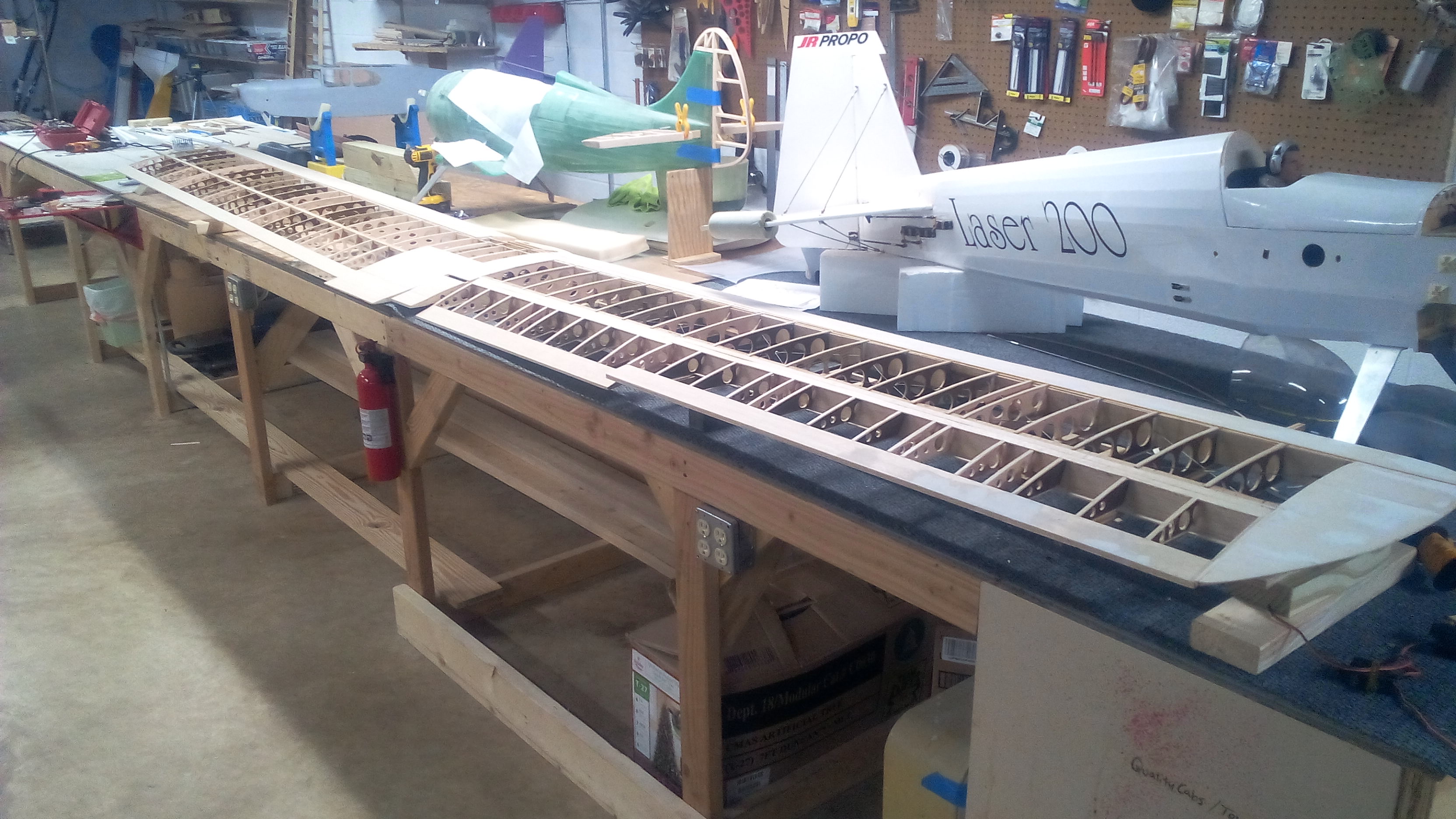

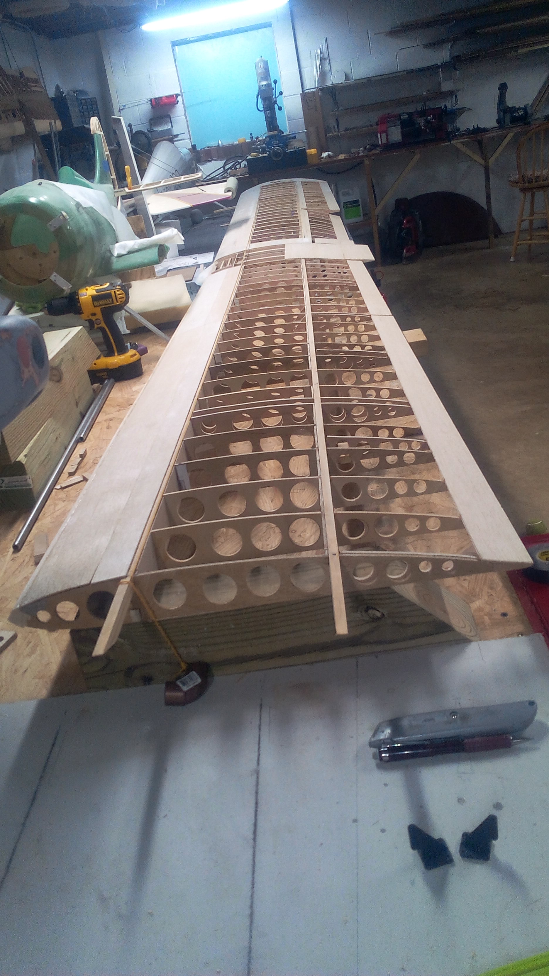

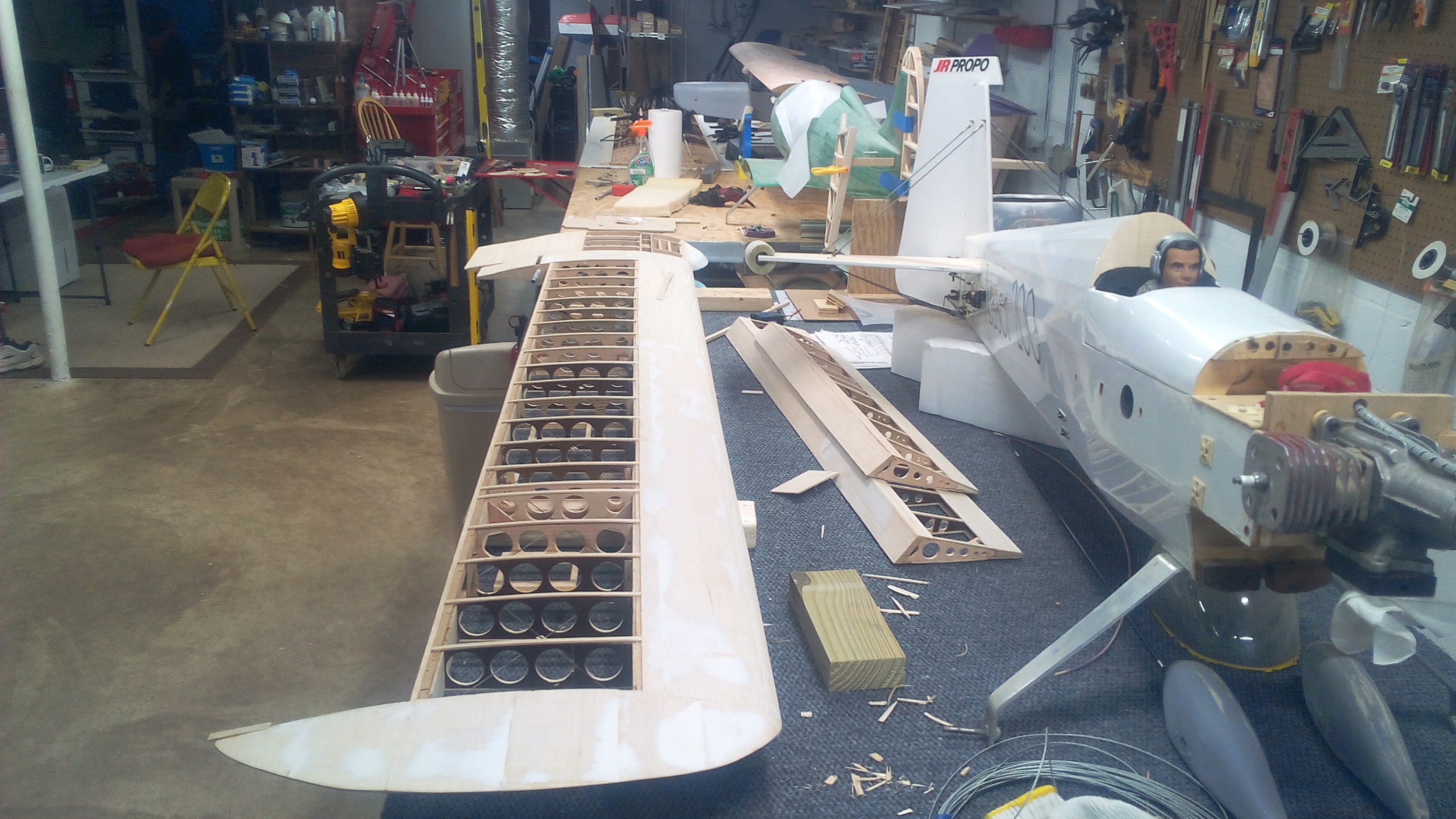

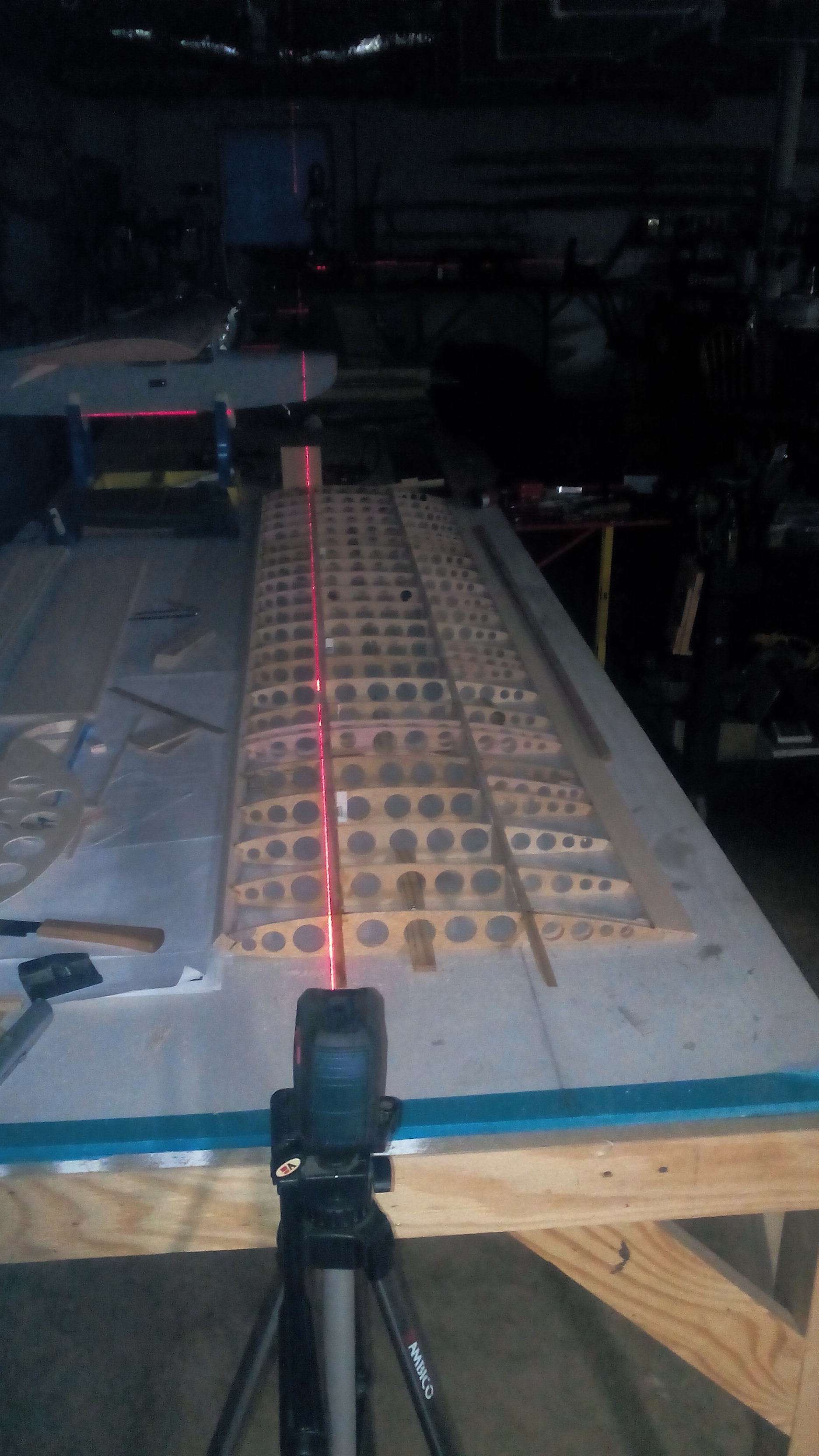

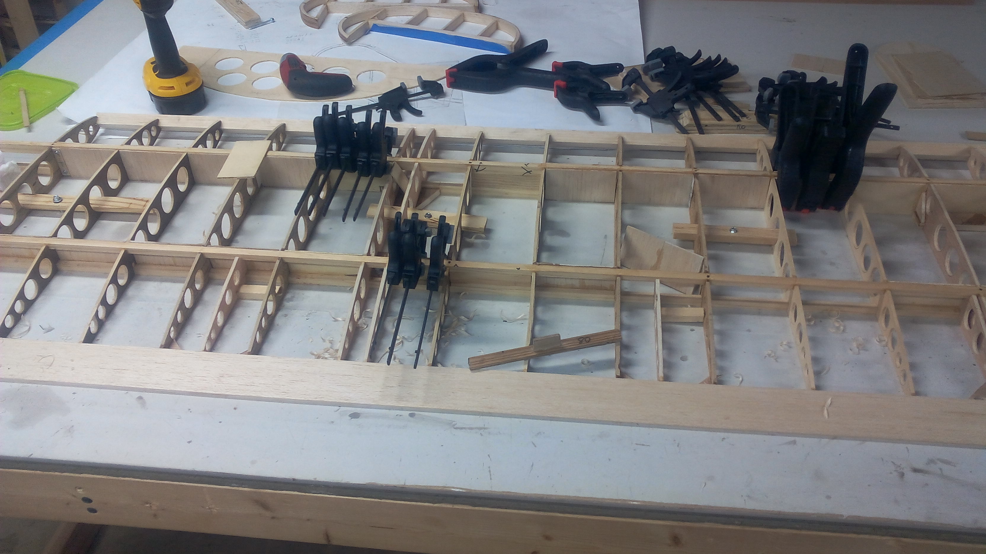

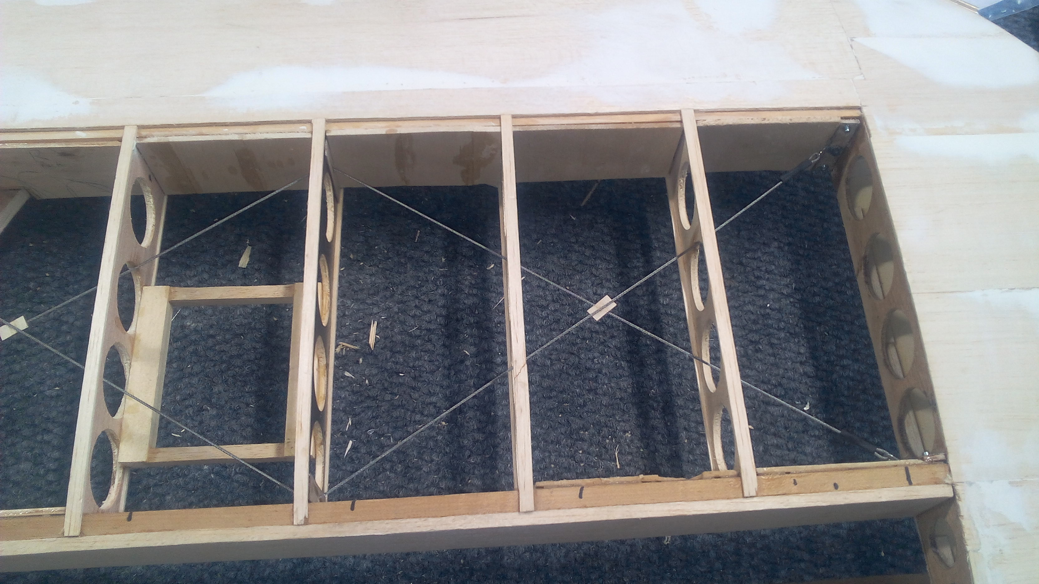

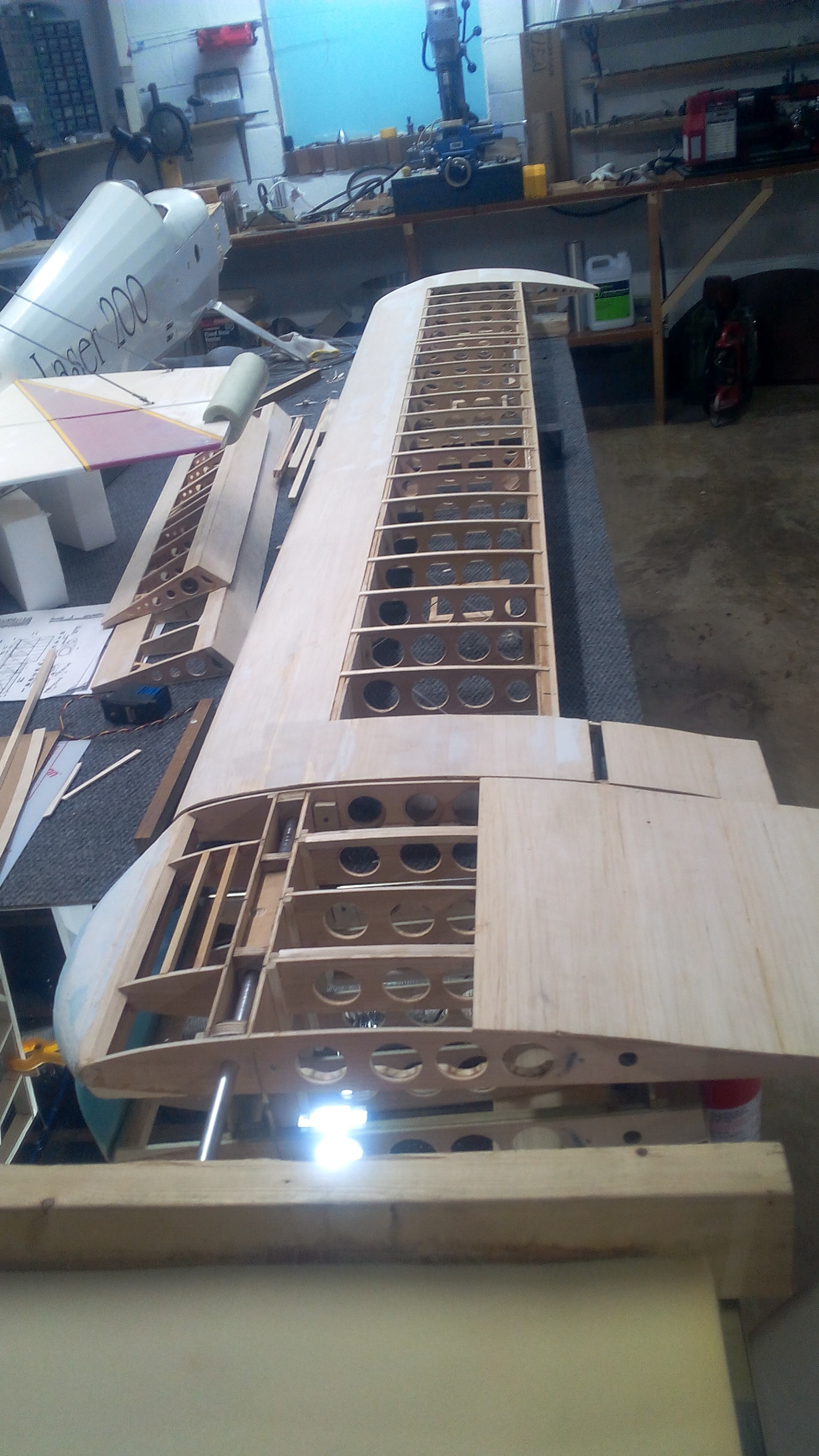

I haven't give up yet. have some many project going on. Having to build a new left wing panel. When I laid the first panel out it I ended up with a twist in the wing panel. Could have repaired it but as big as this plane is going to be did not want to risk a failure.
