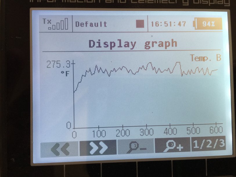

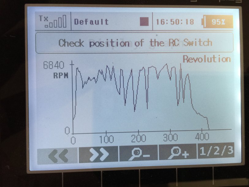

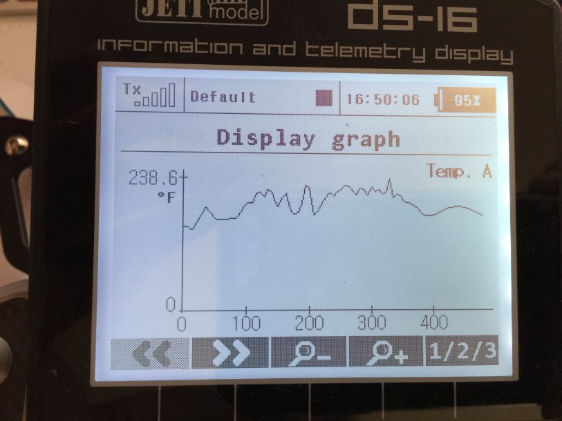

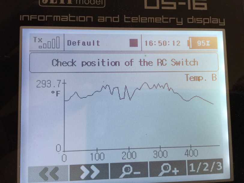

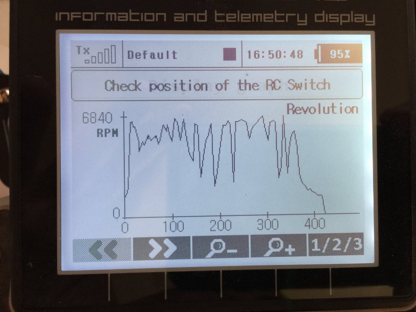

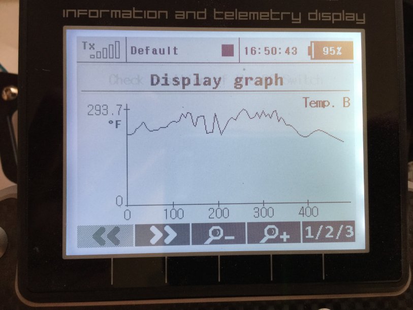

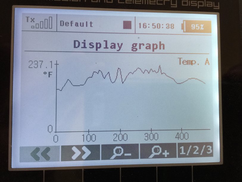

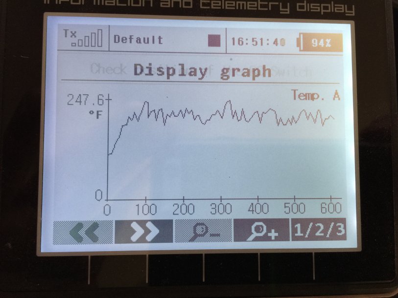

Here is the telemetry of the flight.
motor is brand new.
ambient temp = 82 F
Fuel= 93 octane, no ethanol, red line oil 40 to 1
Falcon propeller 30 x 13 - 2 blade
right rear cylinder temp, peak was 242.4
left rear cylinder temp, peak temp 298.3
right front cylinder peak temp is 247.6
left front cylinder temp, peak temp 275.3
Peak RPM = 6840. this will get over 7000 once broken in!! SO far, so good, with a 30 x 13 prop. this is data during flight.
the telemetry for cylinder head temps tells me that the right cylinders are running cooler than the left sided cylinders.
the hottest running cylinder is the left rear cylinder. I am thinking, i will richen the rear needle about 1/8th of a turn.
Hard to tell what to make of all this, it runs great in the air!!!

I have a total of 6 temperature sensors.
the 1st 4 are on the cylinders.
ok, i placed a 5th temp sensor right in between the headers, just next to the rear carb. I wanted to measure the air temperature, meaning, how hot is the air entering the carburetor. this air has average temperature of 98.4 degrees F.
the 6th sensor is placed on the rear aspect of one of the canisters. That canister had a peak temp of 125.5 F.
this tells me, I am getting plenty of air to cool the header and canister area.
