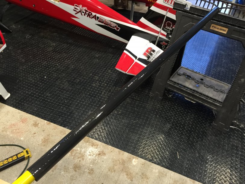

2nd Observation, i had purchased the Graph Tec wing tube and stab tube.
The wing tube slides in easily into the fuselage and the wing sockets.
The airplane, during flight, will make a vibration sound, at a low to mid rpm, i was wondering if this was from the wing tube vibrating, so i have applied 3 coats of clear epoxy KLASS KOTE. Now the wing tube slides in and out with significant friction.
I am still concerned, and wondering if this rattle, that occurs on the ground also, if the RPM gets low enough, could be coming from the standoffs???
I am considering changing out the standoffs for the plywood block i made.
If i do so, i will post pictures!

The easiest way to determine what is rattling is to touch parts of the plane while you are getting that noise. Leave the canopy off so you can reach inside and just start touching pieces until the sound goes away. When the sound stops, that is your culprit and you are in the right area. Sometimes it can be a real pain to find where the noise is coming from, but this is the easiest way to narrow it down to an area. You'll probably have to take the cowling off to check the stand-offs for vibration noise. The stand-offs may be fine, but are transferring noise into the motor box. Good luck!
great idea.
I also have a feeling it could be the front of the split cowl.??
what you suggest is best way to make it easy to determine. well, easier than trial and error of moving things around and changing things.
Thank you!!
3Dchief
It won't be near as easy as I make it sound, but it is sure a place to start! It will be much easier with a helper so you can stand back and listen while they touch different parts of the plane. The most common places for rattles/noises I have found are wings/wing tubes, landing gear/wheels/wheel pants, and cowling/firewall. I would start with those first. If it's not those, then you pretty much have to touch every part of the plane until you find it.
