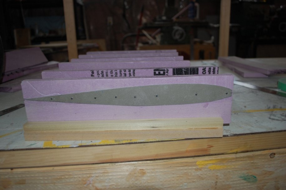

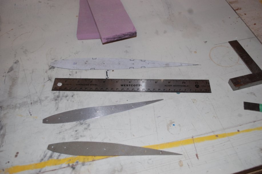

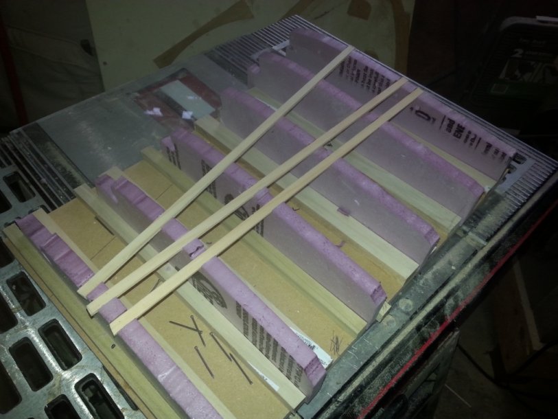

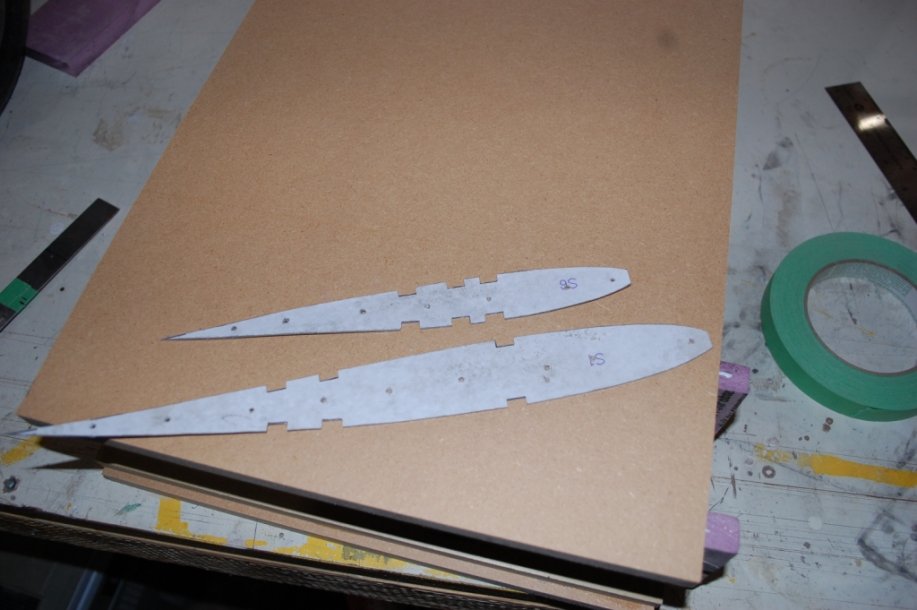

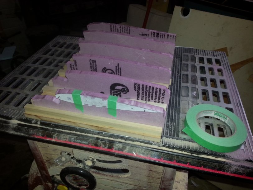

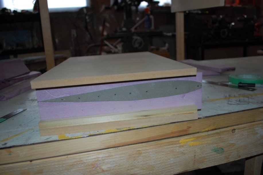

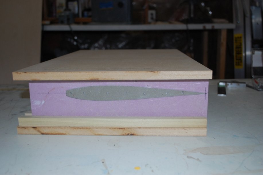

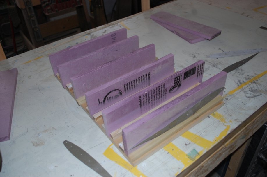

doing the stab/ele the same way as I did with the wings, I have never done the tail end this way so this is a first , but it should be OK
in the pictures , you will see two sets of templates, I found it easier to put the first with no cuts for the spars , then simply replace with the other one with the cuts for the spars.
